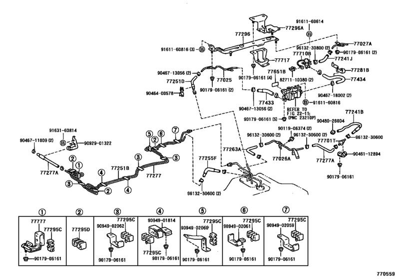

Everything I've read indicates that the factory aux tank uses an external transfer pump, and that it doesn't pump directly to the engine. The parts diagram certainly appears to show the aux pump going into the main tank, and a separate line leaving the main tank toward the engine.

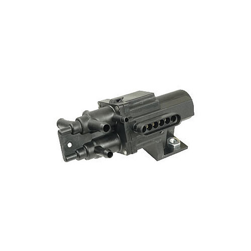

It's certainly *possible* to set up an auxiliary tank to pump directly to the engine, but if that's the case then you'll have some kind of fuel selector valve like this Pollak model under your rig:
Editing to add the fuel line parts diagram:
