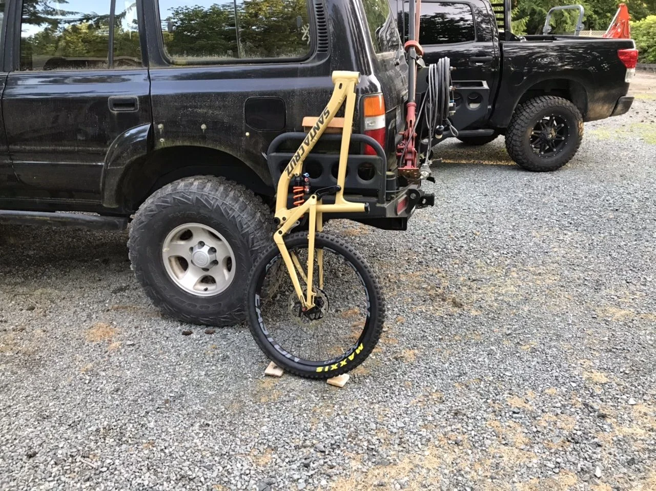

An aluminum frame Santa Cruz Nomad G4 frame:
Pic skips ahead a little, as it already is wearing a 2.8 Minion tire (27.5+) - and a 230/65 Fox DHX2 shock with a custom lower link (still raw AL).
A (literal) - metric eff-ton of work with calipers, trigonometry, and to be honest - some faith between me & the guy I bought the used frame from he wasn’t snowing me on RR triangle width esp as to trying to stuff a full 28.25” OD, Plus - width tire with a few MM to spare.
What you’re seeing in 1 pic is easily 30+ hrs of communication, design/copy, and mentally escape of what I was in.
The link was the big work as I made it / learned / pushed what I’m trying to master (Fusion 360 / CNC work). It took alot of time & kept me busy as it allows the shock to fit & increase travel a little.
So far, that’s the bulk of the project & updates will be slow as I want to keep this tail-heavy & not run a dual crown fork - so I’m like the masses waiting for a Fox 29’er / 180mm travel single-crown.

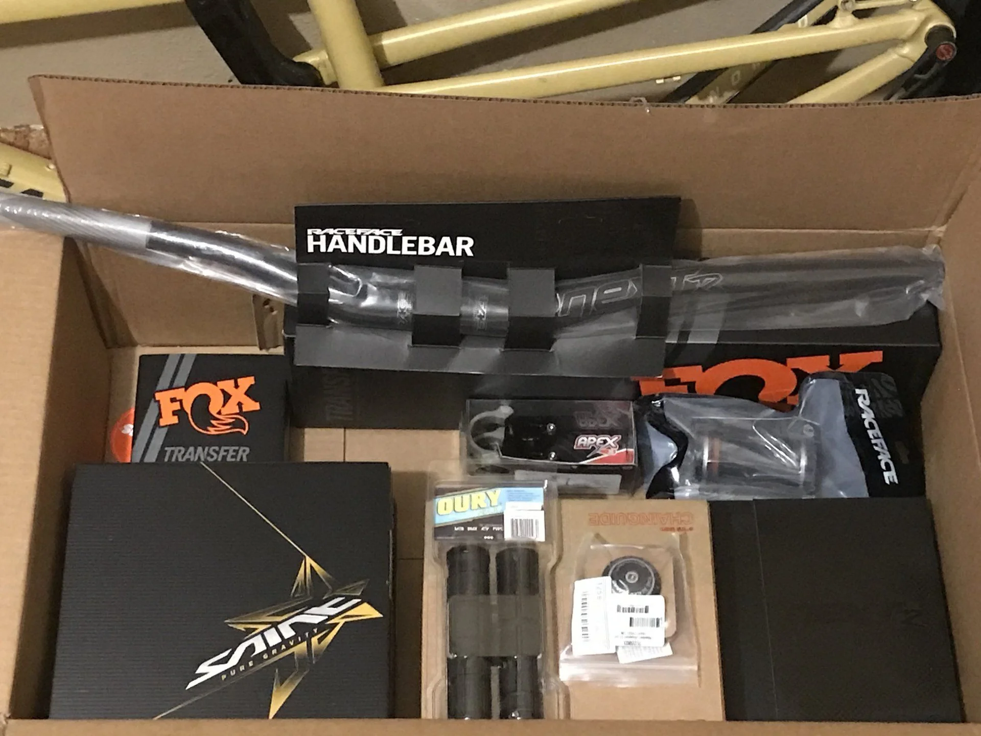

Both brakes are here - Shimano Saints :cool: - Big boys know these are the gold standard.
Will post a pic of current collected parts soon.
Yikes! - 2mo since last update.
Fox is still pretty much in ‘lockdown’ - so no fork even if I had the $$ (been burning $$ getting my smile bones all fixed right-n-tight) - but a fork and a set of laced wheels are pretty much the last big-ticket items, aside from a RR cassette.
The ‘parts box’ as things are available & between dental $$:

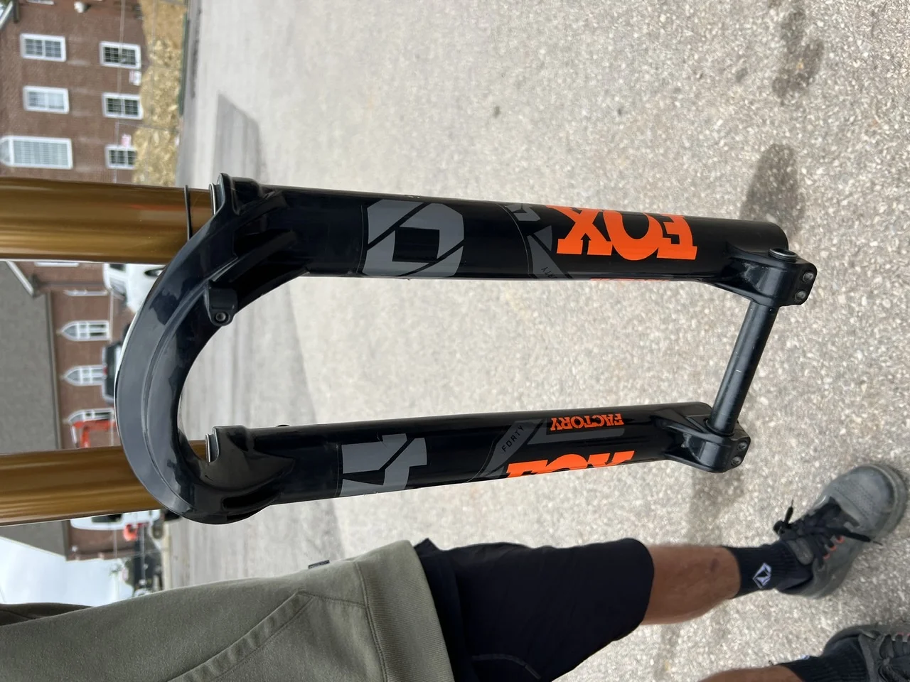

I did change my mind after alot of thought & a talk w/ 2 of the Fanatik guys on speaker-phone.
The future is dual crowns - and going to a Fox 40/49 -is the path for this bike & intended use.
I have my exact loop, and since I’m trying to make this like a Santa Cruz V10 but with conventional drivetrain - the dual-crown makes the most sense.
Plus, the DC fork has the travel to keep pace with the new RR triangle travel.
So when funds allow, a Fox 40/49 is what I’ll get - I’m keeping the Bronson CC so not like this is my ‘quiver killer’ - and even if, it’s all alloy & town rideable if need be.

Any close up shots of that link or CAD shots?
Let's ride Galby sometime - currently waiting on a replacement chainstay since i snapped mine.
Rad build.
I’ll do a re-teardown & show my link - CAD is on a unlabeled USB stick in a box of them I have :rolleyes: - crappy organization skills.

Jeez….full year since I been here or done shyt on this.
FedEx guy just dropped me a used toy:
Seller photo but it’s a ‘21 29’er for the build.
I just wasn’t out to swallow the $2200 tag for new, this was <1/2 that froma good guy in OK.
Build once again has momentum-
I need to get some Raceface 35mm (maybe 40’s, not decided) laced to Onyx hubs- and buy the cassette & shifter/derailer (Shimano only), all other parts are on deck.

Trip to Fanatik got me a fork mudflap for that Fox, and a headset to adapt a straight neck 1 1/8” fork to my tapered head-tube SC frame.
