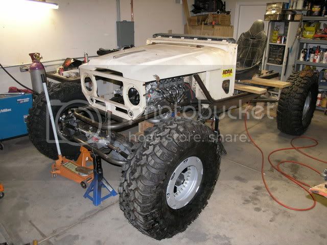

Belly, that all buggy? or partially cruiser?
Looks good
Looks all buggy.
MUCH easier to design a suspension without a existing frame.

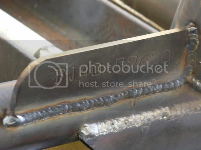

It's a cruiser. I have the original bezel! :D
3 feet of original frame:

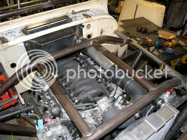

Cowl and firewall... well... most of it:
Hood and bib:
Incontrovertible evidence of 40'tude:
I just whittled everything that got in the way.

Mine does not have a serial # any more ;)

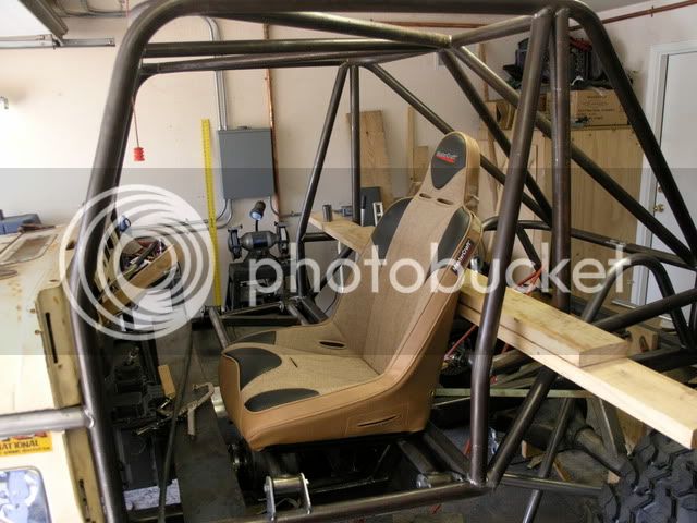

You need different seats :hillbilly:
Click the link in my sig if you want to see how I ended up doing Rockwells under my 40 and not have it be 8' tall...
The front admittedly could use more triangulation, but it's still fine to drive even at speed.
