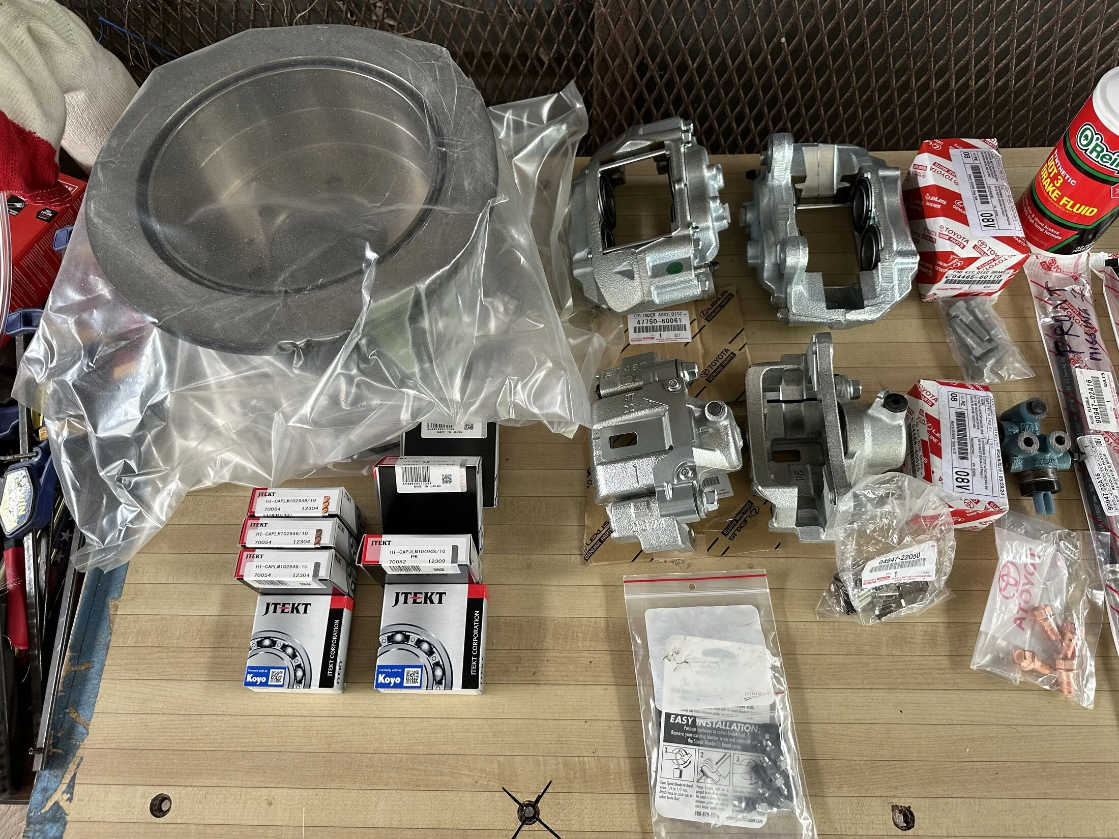

lining out and orienting 80 series axle rebuild parts please?
Apr 9, 2017
352
2,551
tejas
legends,

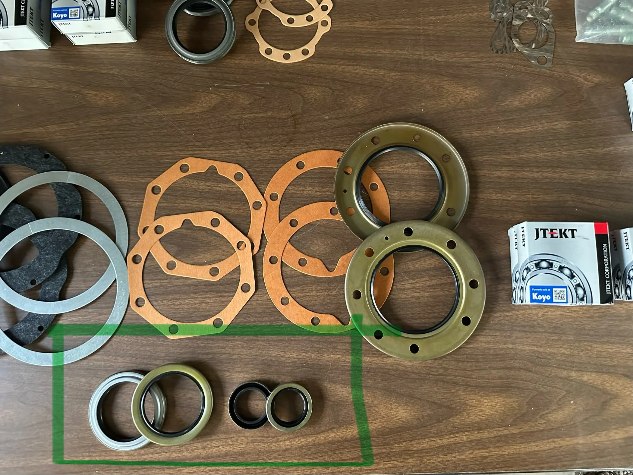

1. does it look like the parts are lined out correctly?
2. anyone know where the items in green go?
3. anyone know what the orientation of the seals is/are? i kind of would like to lay them out correctly if possible.
Seal lip to the outside
"Knowing what is not correct can lead you to what is." - Confucius probably
It's been a few years since i did this job but If i remember right the Items in green box are, inner axle shaft seal, and the larger seal is the inner wheel bearing seal,
What a hoard of parts!! That's exciting. Hit the launch button man.
You have circled the inner axle oil seal, and the hub seal that goes in the back of the hub AFTER the wheel bearing its on place.
The small seals are keeping oil in the axle housing, and the larger ones keep grease in the hub, so face the seal toward what you're keeping in.
They have a little garter spring to keep tension on the seal lip. The garter spring goes toward what you are keeping in.
