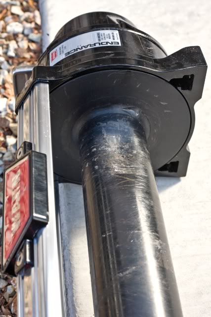

I was thinking in a report that I was reading about winches over 10K using rope and the rope puting more stress that the drum can hanle on one spot of the drum ( under full load ) and bending it .. ( australian mag Battle of winches ) IIRC it happen to the endurance ..
I have never seen it happen, and never talked to anyone who has had it happen to them, but I have heard that if you don't properly spool synthetic line onto a very strong winch that the synthetic line can put undue stress on the drum and dent it. Just like most parts of recovery and recovery gear people don't take the proper time to take care of their gear. Cable can get crossed up just as easily but since it is stiffer it won't fall between wraps as easily.

here is the pic .. rope in the endurance ..
Ive heard of this happening but never actually seen it.
It happens because of the lack of friction of synthetic rope compared to wire rope. Synthetic rope will constrict around the drum more than wire rope. What looks odd to me in the pic is where it happened and the type of damage. It looks as if the drum took a blunt force impact rather then being crushed. I also cant see synthetic rope scratching up the drum like it is.
Do you have a link to a site you got that picture from?
Opie hit the nail on the head with the synthetic being slicker - if not wound properly it can slip between itself and put extra pressure on the drum. IIRC the Endurance is a 12,000 lb winch and Warn only approves their synthetic line for 9,500 lb winches and less and nothing above 9,500.
