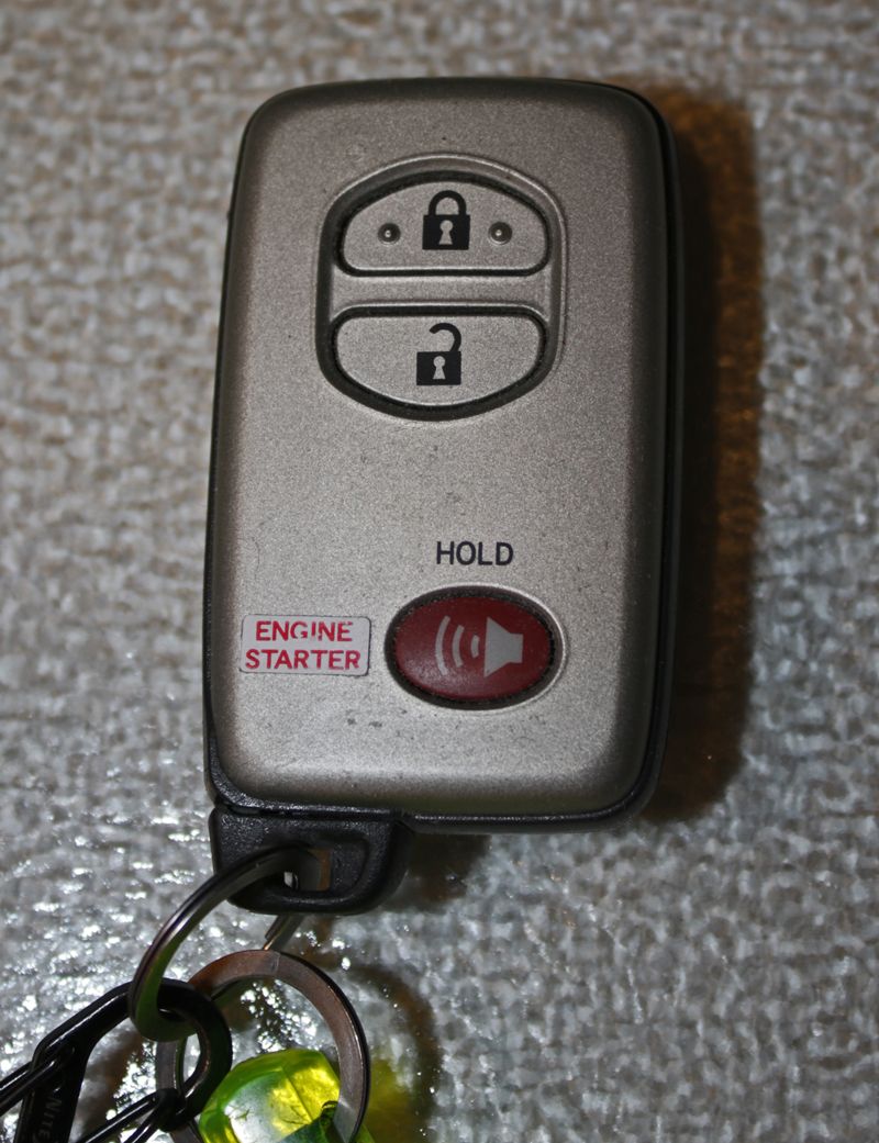

Things must have changed dramatically for 2017. It may not still be the case, but here is the OEM key fob for my 2013 LC:
The only difference between my key fob which has Toyota OEM Remote Start and a key fob that does not have remote start is the small sticker that says, "Engine Starter." When the Toyota OEM Remote Start capability is added to a new vehicle there is no modification to the key fob. Remote start is triggered by pressing the Lock button 3 times.
Either this system is no longer available from Toyota, which is entirely possible, or your dealer was being less than truthful with you, also a possibility. Can any other 2017 LC owners lend their comments?

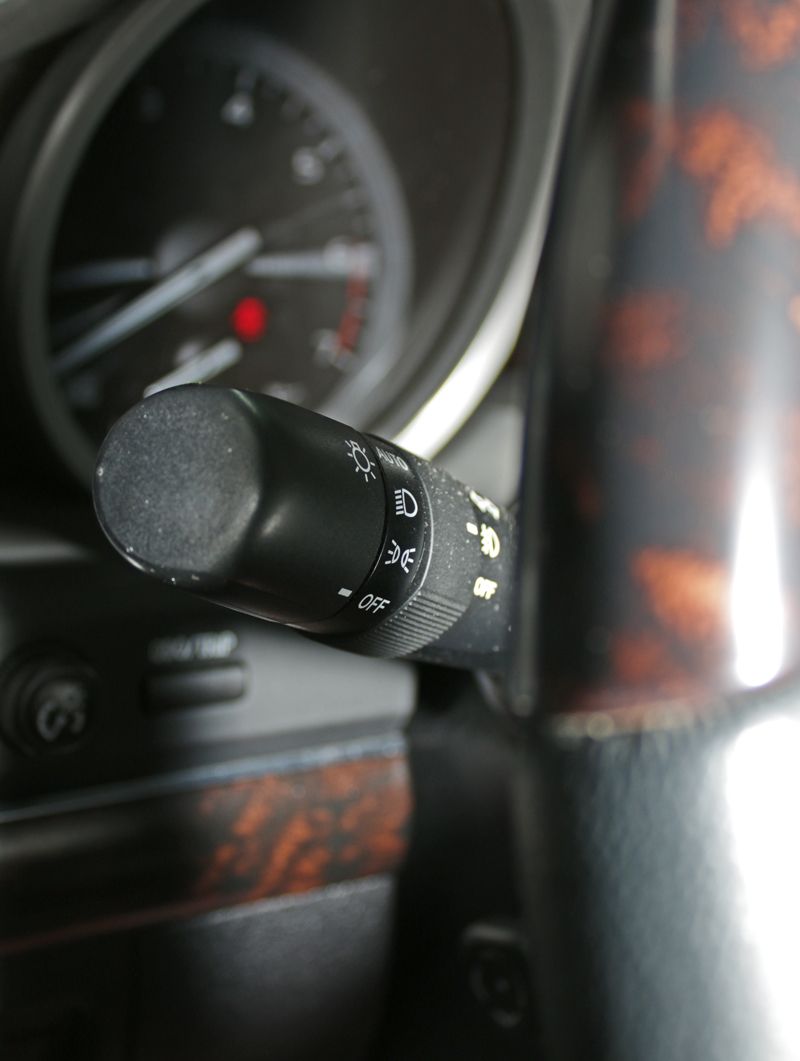

Again, please ignore if no longer the case for 2017 LC's, but on my 2013 the light stalk is configured differently than you describe. Here's a pic of mine:
The pic shows the lights in the OFF position. One click up is the Parking Lights setting. One more click up is the Headlights On setting and finally above that is the AUTO lights setting.
So on mine, rather than being "above the auto setting" on the light stalk, the parking lights setting is just above the OFF setting, or two clicks below the AUTO setting.
I have noticed with mine that if I set the lights to Parking Lights while the truck is turned off, the lights sometimes stay on when the truck is subsequently turned off. However, if the lights are set to Parking Lights while the truck is running, the parking lights turn off when the truck is turned off.

Yes, they have changed the light stick. The bottom setting is now DRL off, then auto, then parking, then lights on settings. There is no true "off" setting. I like the older setup better. I drove a new loaner Camry and it was similar to my settings. While I initially thought that maybe I'd left the car in the parking light mode, the last few times it was definitely in auto. Turning the stick to any setting, including DRL off did not turn off the parking lights. I had to start and stop the car in auto to get them to go off. It seemed really strange.
