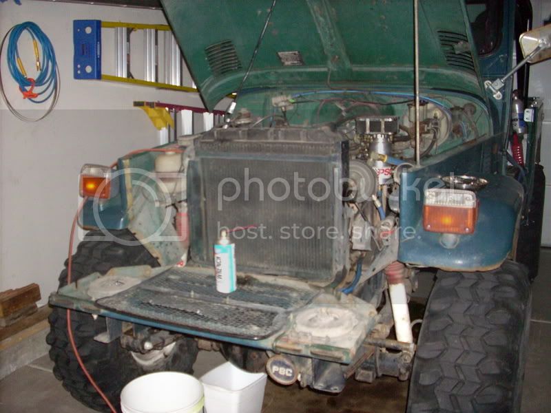

7.94 kilos
How much does the York weigh?
BTW the more I look at this project the more I think a SBC swap is the real solution. The 2F still has decent compression but it's puking oil from the front and the back and every gasket in between.
I hit the drive pulley nut with an impact wrench until the tanks is empty a couple of times in the morning and at night, add penetrating oil and repeat.
So far no movement.

I used a hydraulic hose for the output hose and it still dang hot!! Kilby also sells a high temp hose for this application as well.
The only downside to the Sanden, as you know already, is the extremely oil air on the output. I tried various things to separate this oil and then fed it back into the suction side (automatically). However, I still got oily air, even after the air/oil separator. Sanden has no separate oil crankcase so you sort of end up living with it. But the Sanden is a nice OBA package for sure.

I hit it again with the impact after dinner and it spun loose.:rolleyes:
Liquid Wrench, an impact wrench and time did the trick I guess. Maybe Friday I'll pull the crank pulley and see how badly it's scored.

After a lot of consideration I think I'm going to shelf this project for the now. Way to many other projects that have higher priority. So I think I'll just get the water pump replaced and forget about fixing the oil leaks and adding OBA for the time being.
