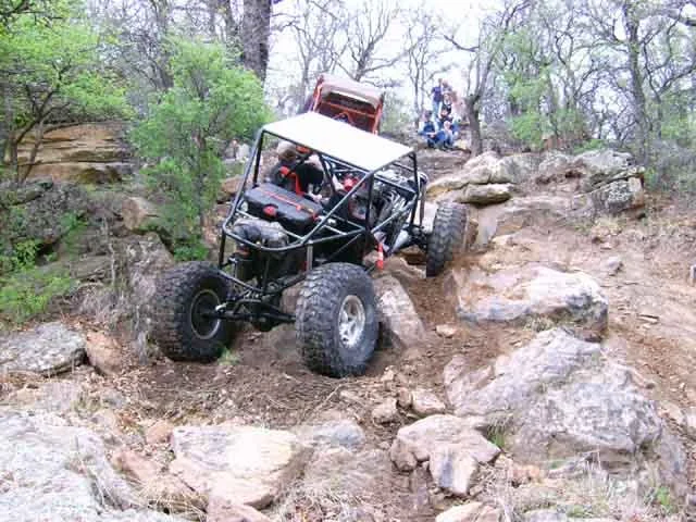

Light Buggies.........
Now that is some light weight buggy at 2600pnds.
After looking at your rig, it also appears not a ton of money was sunk into axles or engine tranny.
Could a person put together a budget buggy like that for under say 10K?
I think it depends on what you have laying around when it comes to the detailed parts. You could easily put together 90% of the buggy(chassis, drivetrain, steering, etc) for $10k if you found some good deals and were designing around a frugal combination of parts. However I think the last 10%(controls, interior, gauges, hoses/lines, etc) will put you over the 10k mark. A friend of mine built a buggy based off of a Blazer chassis he already had(i.e. he didn't have to buy any major drivetrain or axle components) and he still spent $10k on it for all the odds and ends.
Ary
When I added up the parts in this rig I came up with 14-16K and that was with using lots of used parts.
Since then I have upgraded everything I can for strength in the drivetrain and have sunk another 6K into it.
Looks simple, but there is a lot of detail.
