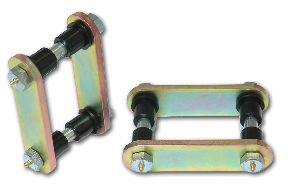

I'm thinking about installing these longer shackles in the rear. Anybody done this before? Do I need to think about shocks, cables, hoses (gas tank), brake lines, drive shaft?

According to that add Amazon says these will not fit my 85 4Runner. But that's a good alternative if it was the right size. Thanks.

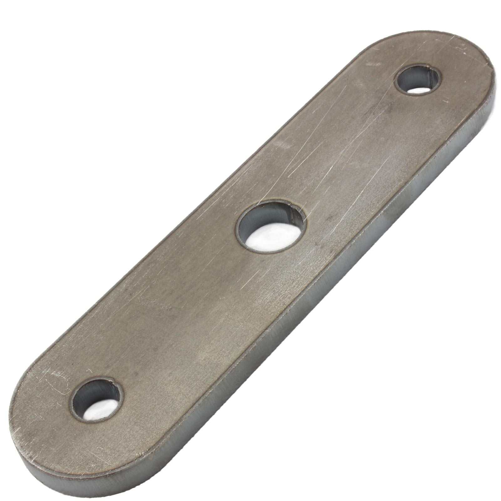

Its pretty simple to build a shackle. 2x3/8 flat, a 3/4 drill. Some nuts and bolts.
I would imagine the toytec block would fit with some slight mods or a ubolt flip kit.
