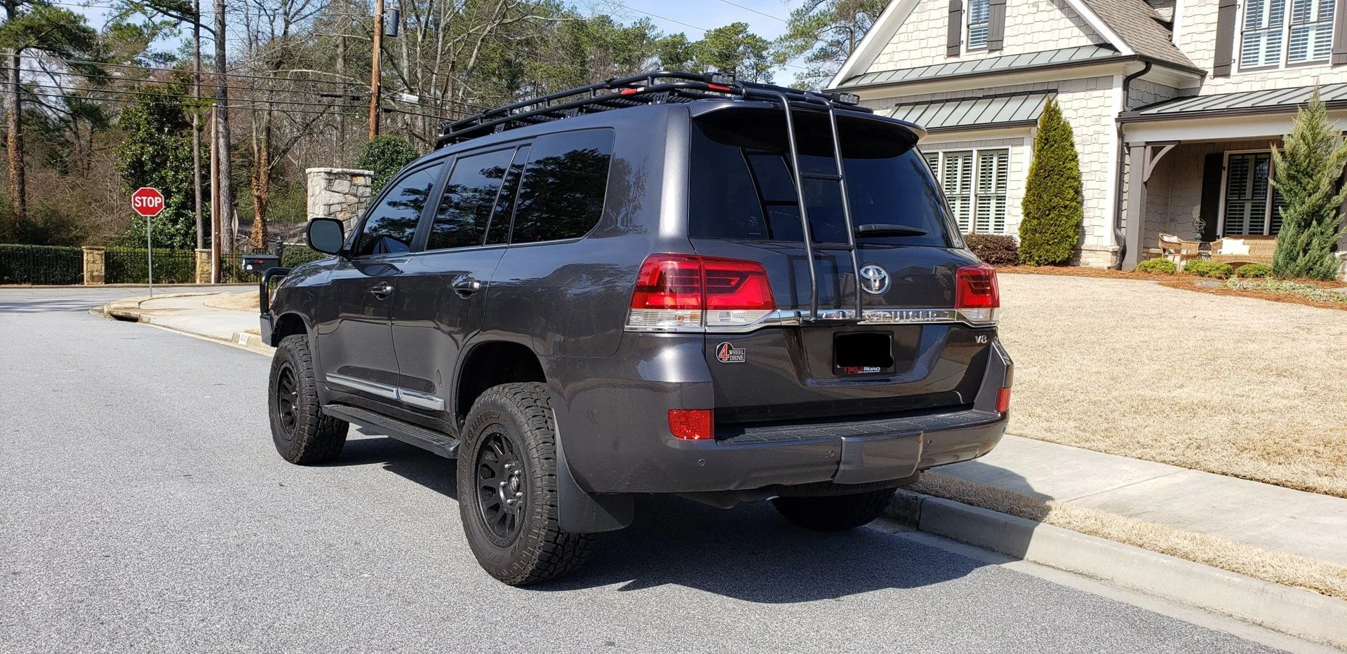

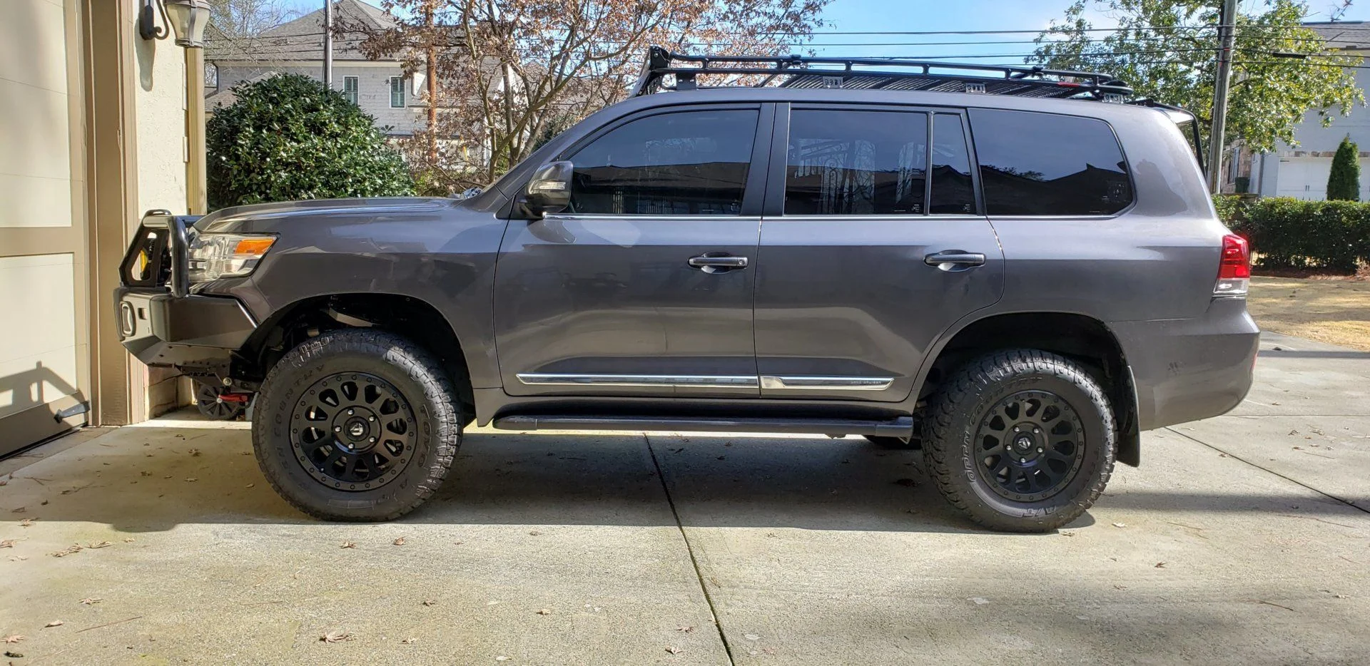

Here are some more Pics as requested. Aside from the slight pull to right, its drives 100% better than stock!
