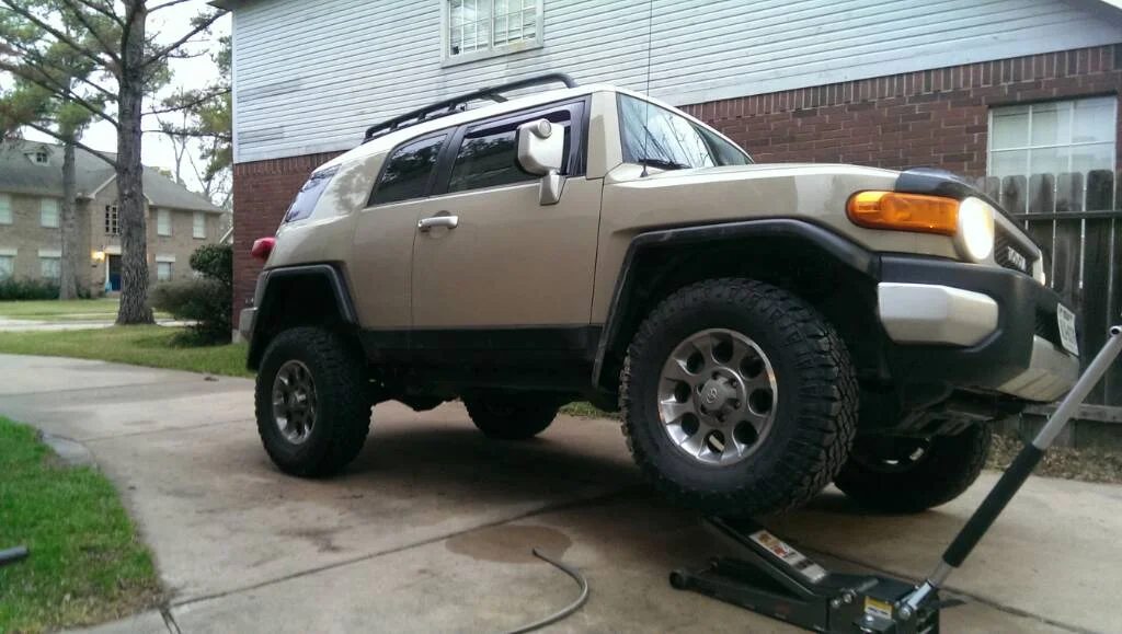

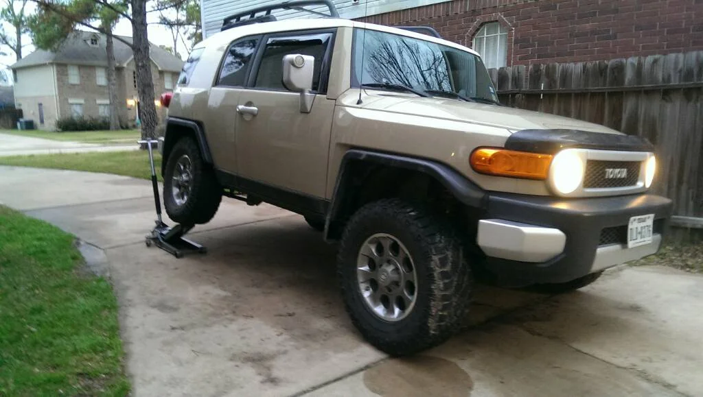

Well I decided to go with the toytec boss suspension. No UCA and I know it's not ICON. But I've heard it's still good. Also put on some 285/70/17 duratracs. Little rubbing since the toytec isn't on yet. Hopefully have pics of it all soon :)
Here it is with just the tires.

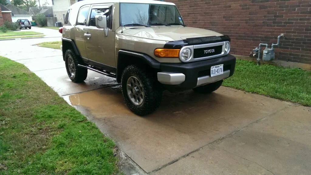

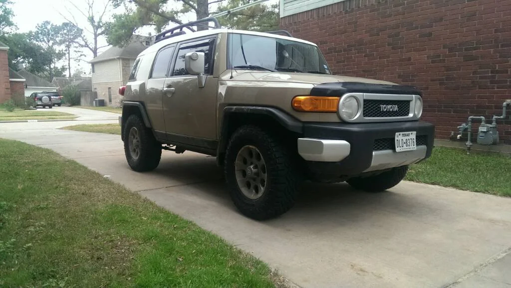

Lift all finished and install was relatively smooth. Went with the ToyTec Boss suspension. Seems great so far. On short drive back felt a little soft, but it was unloaded. Front coils felt excellent! Will be taking it off-road this weekend.

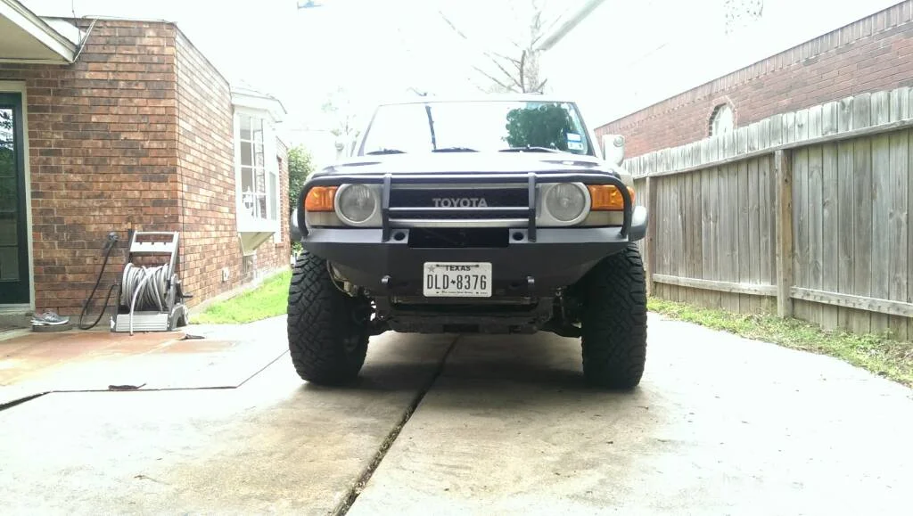

Nice thread. I have a '11 Quicksand and also wanting to lift. Do you have more pics?
Only thing new since the prior pix is the sliders. Next I plan on a new front an rear bumper. Rear bumper on the FJ hangs way to low. If you do much off road you're going to hit it.
