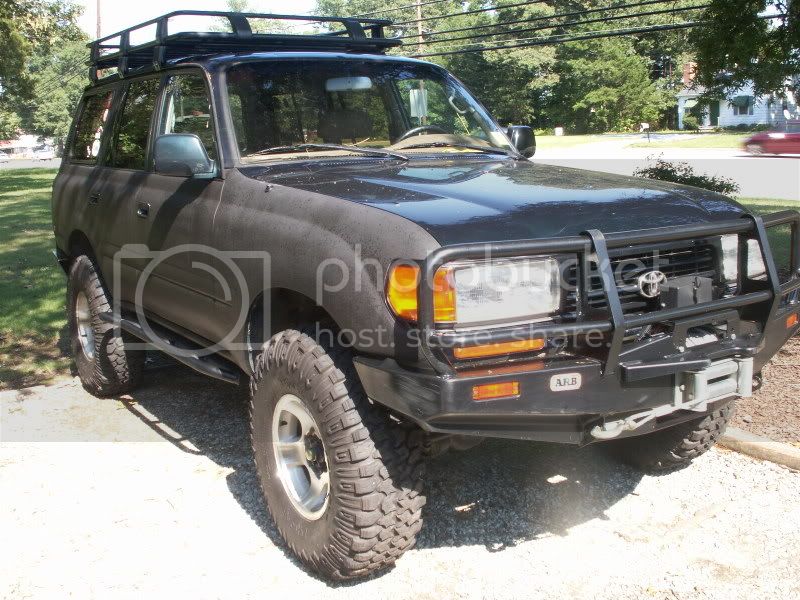

Where did you get your roof rack? How much? Very nice 80.
aaaahhhhhh i see you have one of those budget things to work with; and you move swiftly :D
thats the 3/4 length ARB rack on concretejungle's rig. They no longer import the 3/4 length, this lucky bastid got the last one into the country. cant wait to see the finished product, sounds like a sweet build!!! IF you are still waiting on the IPOR order, you might as well toss a skidplate on there. its beefy.
