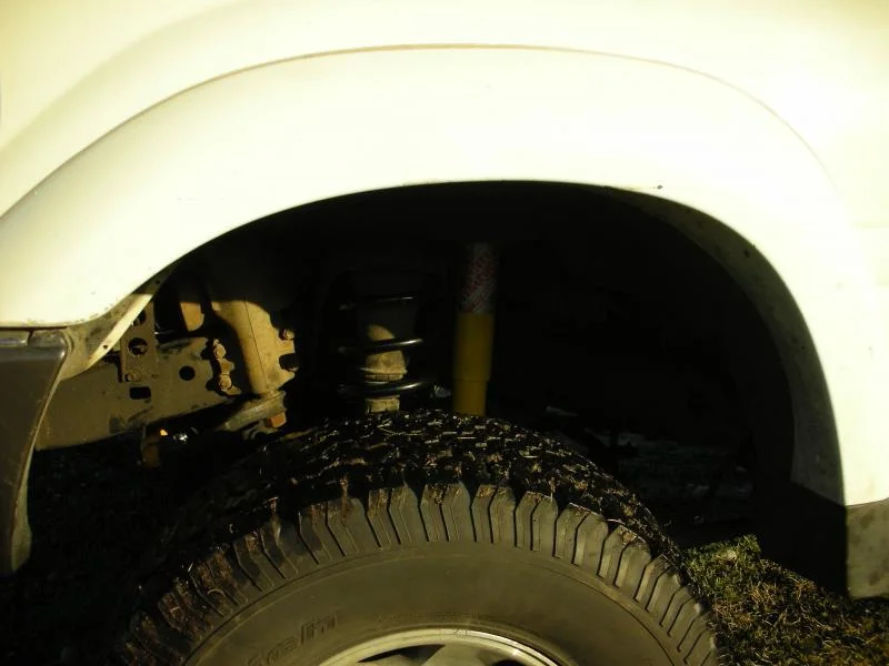

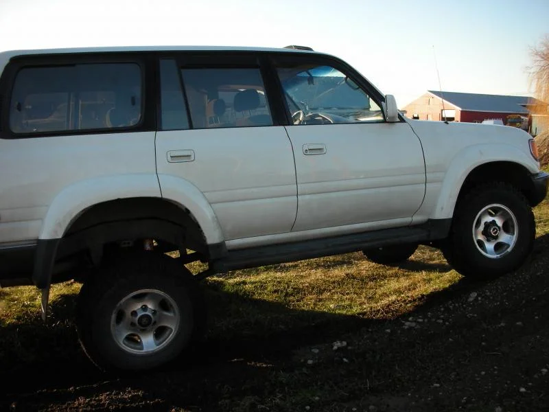

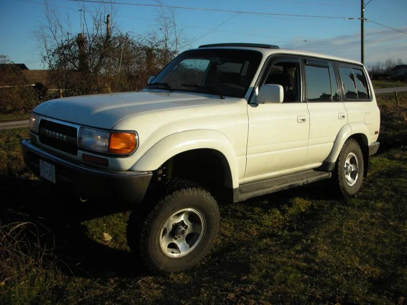

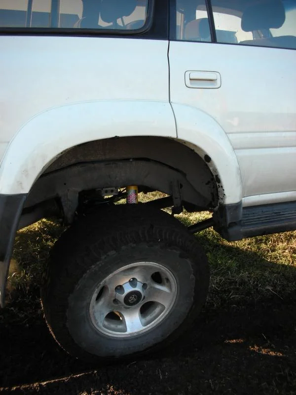

So the lift is in. It took Justin and I a long day on Sat. and a few hours on Sunday but we did it. The hardest part was dealing wih brake lines. We had one that wouldn't come off and we broke the solid line. After I had a friend make up a new line for us it was all good. And we only have 4 pieces of something left that we didn't install! Not sure what they are. Anyways the lift looks great. Justin's truck doesn't look so tall beside it. Pics to follow soon.
Well we didn't get any pics of the install as we were too busy trying to figure out how to install everything. We had fun learning and felt proud of ourselves. I still need to get the panhards adjusted properly as I still have a slight vibe in the rear when accelerating or decelerating. Love the look and the feel of the Man-a-fre lift.

Very cool Greg. You definitely need larger tires though!!!:D Probably mud terrains too, not all terrains.:)
very nice greg! glad to hear the install went well. is that the 4+ lift you got? i think they use ome J's which are just an 1" longer heavies...correct? how does it ride compared to stock?

The kit is the competion 4" OME/4+ lift. It comes with the caster correction drop brackets. It rides really nice. It's not too stiff on the road and the wife likes it. It's her daily driver with the kids. We drove to Whistler on Thursday and it was good. My only complaint is it didn't come with instructions so I am having a hard time figuring out were to adjust the rear panhards to. I still have a bit of a vibe in the rear drive shaft. The angle looks good so maybe it's a u joint?
