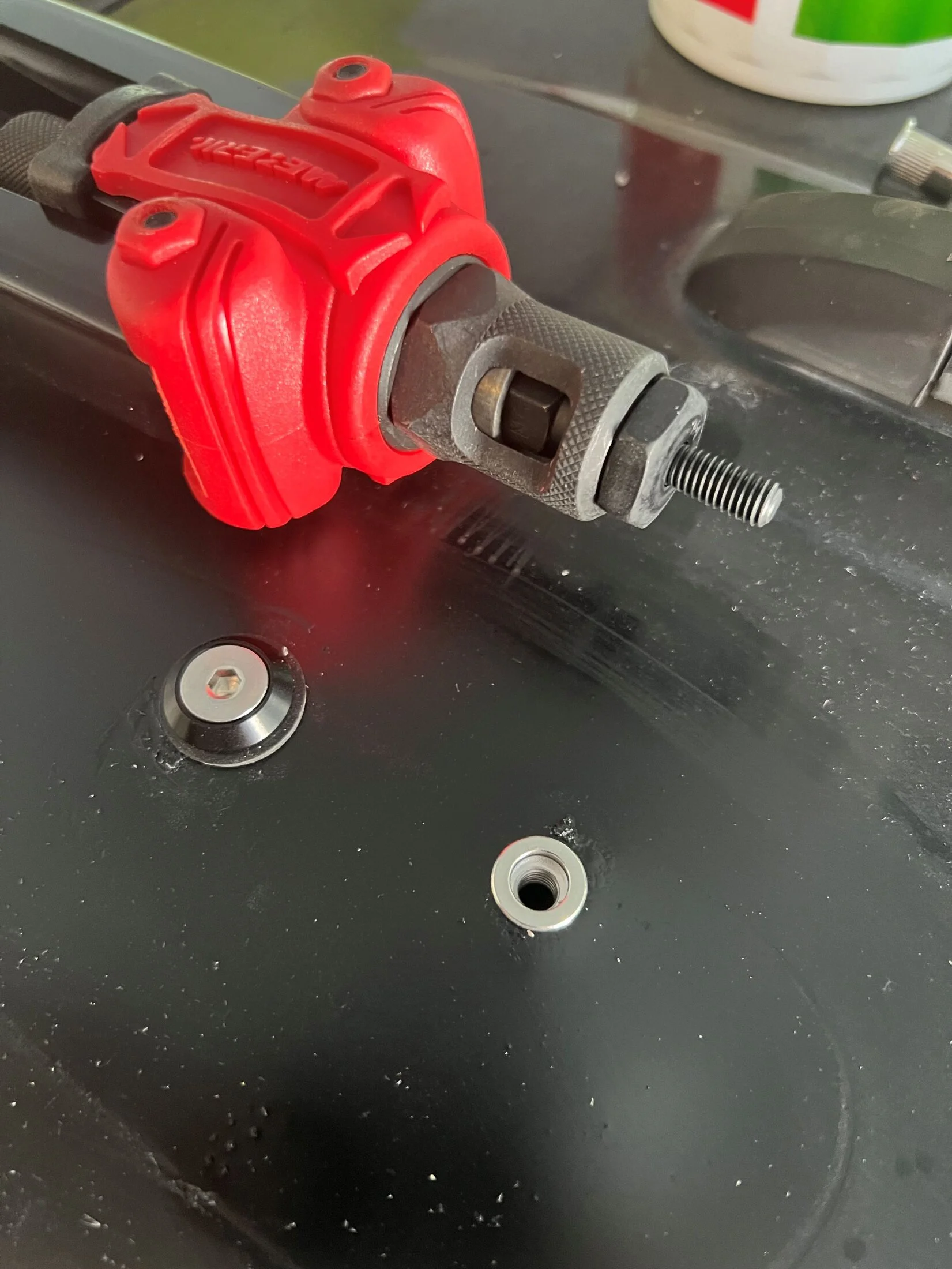

I went with a alternative product designed for fender flairs. My original riv-nuts were shot so order a pack off amazon, drilled for an m6 riv nut, installed, and no leaks.
Metal roof screw washer/rubber, as what I used, is rated for 30yr+ full sun exposure.
Recommend the same.
Tho suspect Wits' End kit is similar enough to make no diff.
