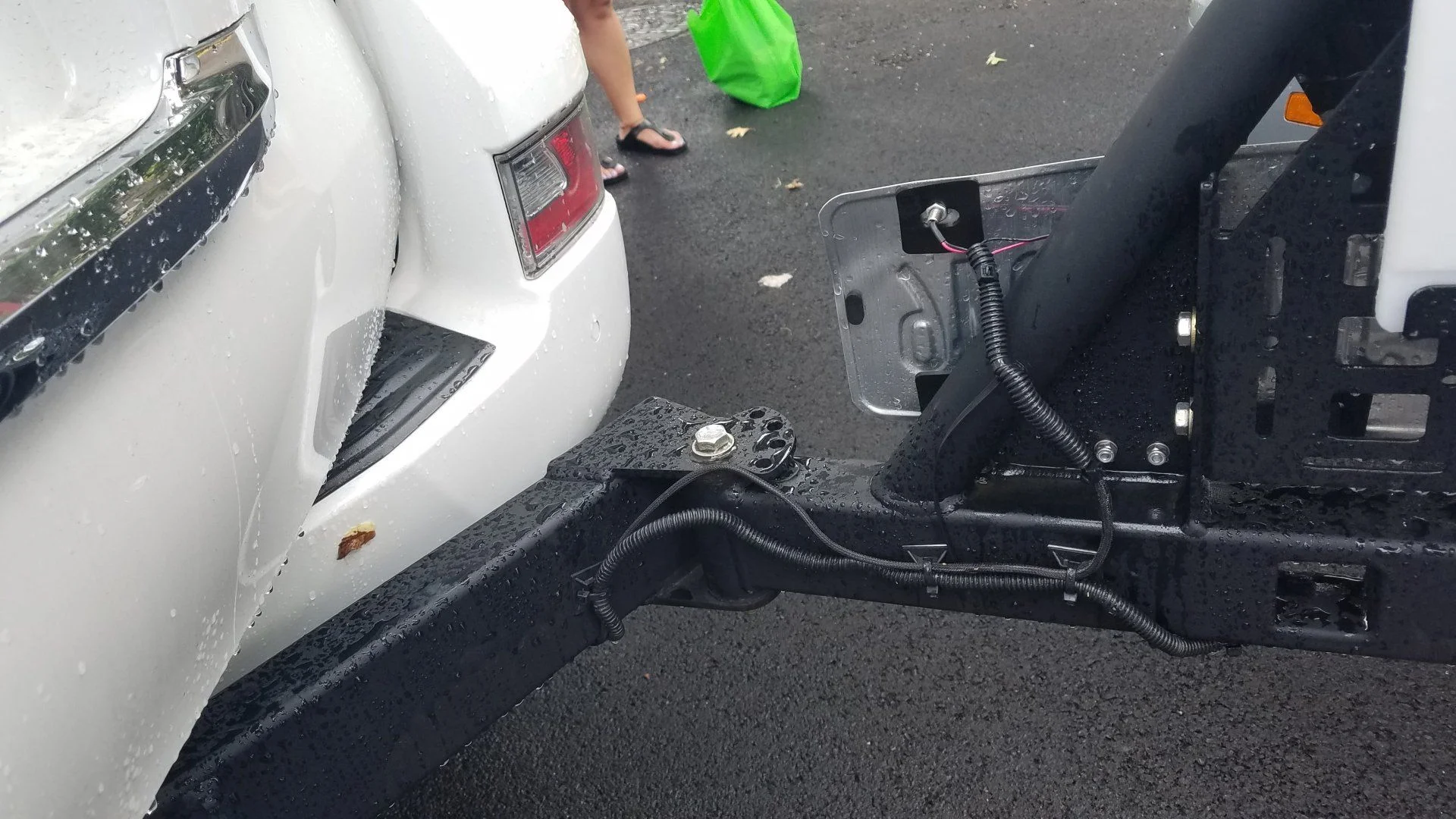

Exactly what you said that's what I did. I cut off n taped whatever cables I didn't use from the plug.
Nice job! I may have pulled the electrical from the rear door and ran that to your license plate.
but potato, patato... ;) As long as it works!
