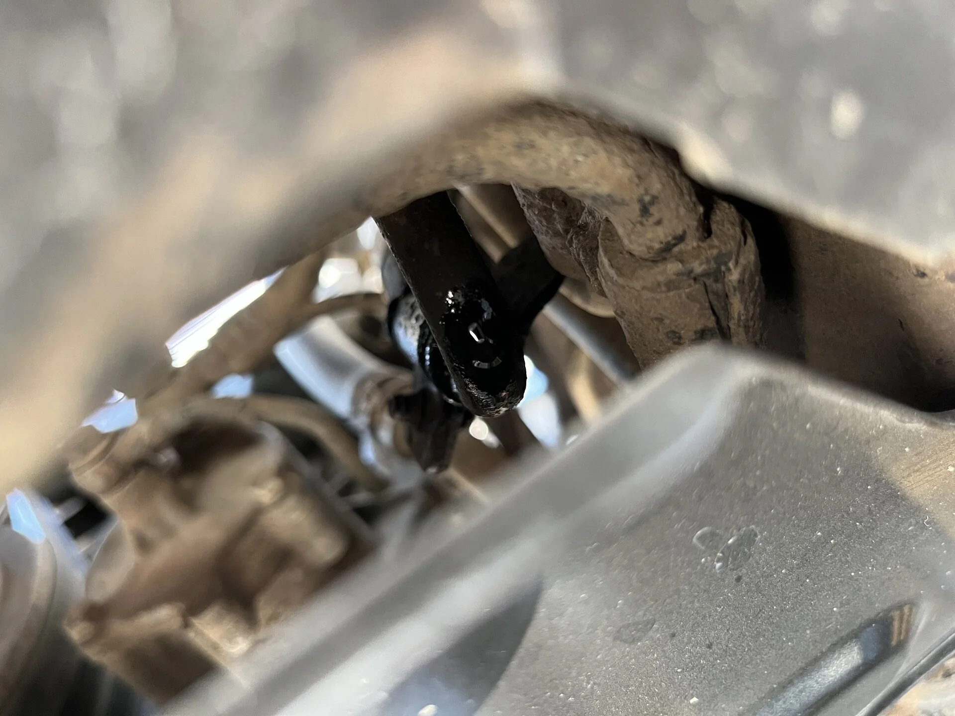

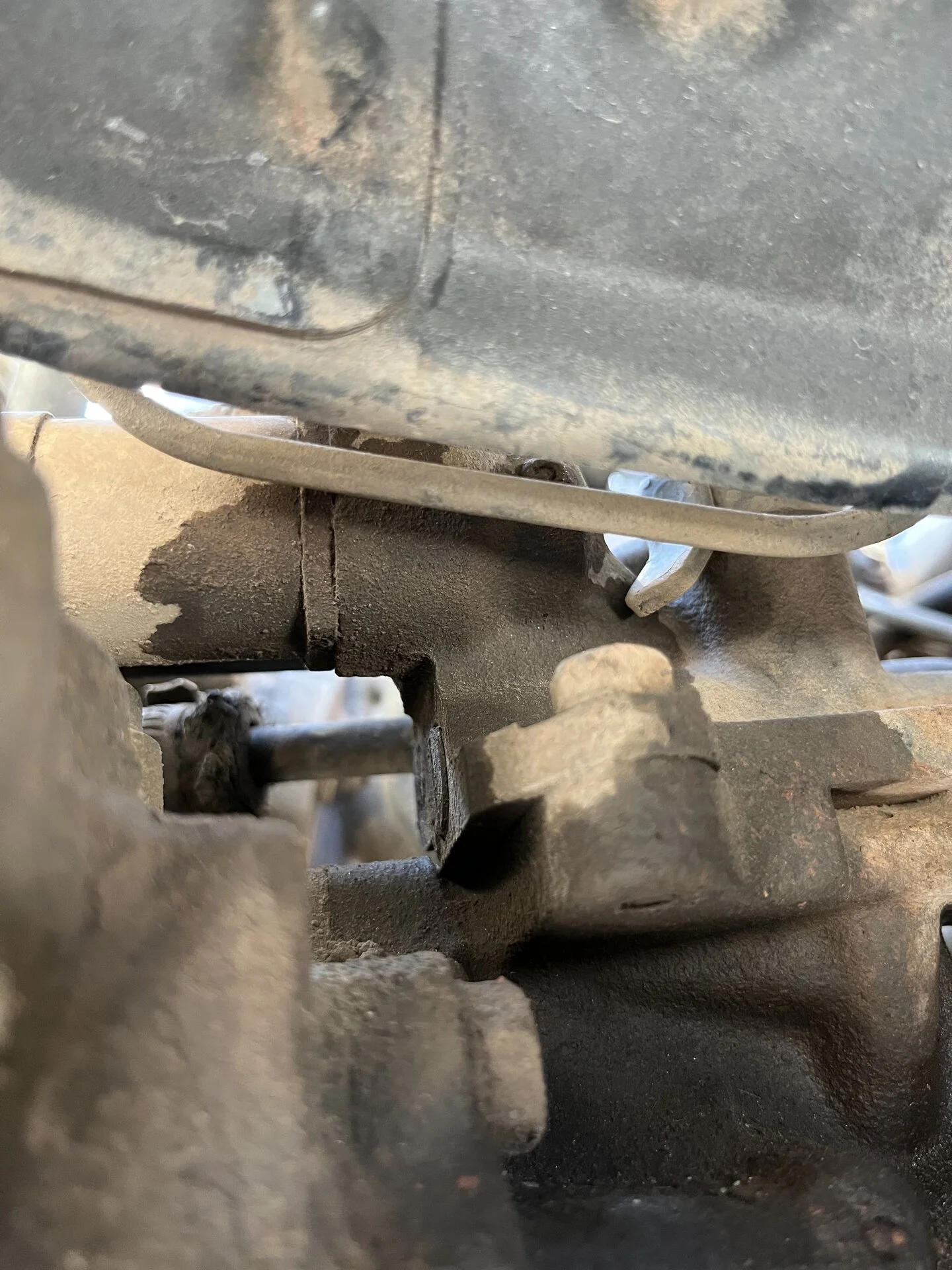

Hey all! I recently noticed that both ends of my high pressure hoses for the power steering are leaking / seeping. I immediately started to look into replacement parts to maybe refresh the entire system, quickly realizing that my setup is different from what is readily available. After some research, I believe I have a progressive power steering setup.
Im having an issue finding any parts for this system. Any advice? Can the steering box be rebuilt? Should I seek out custom hoses? Can I / should I replace the entire system with the more traditional power steering system?
Any help is appreciated. Cheers,
