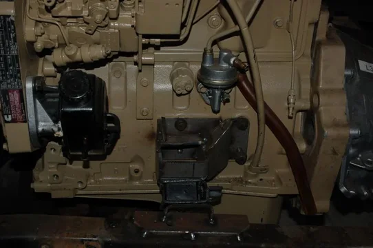

Here is my TC mount and some body mounts.. I did use originals but made my own with the right size tubing mild steel...3/16" thickness.. I think...

I love the grease zerk idea, that's one I'm gonna run with too. Just a smart idea on the motor and tranny mounts.
I see that some have a plate that is then welded to the side of the frame...better surface area to spread the engine weight.
The body mounts look slick! Especially with the use of the round tube, stock-ish look. Really sharp! What did you bend the steel with for the frame mounts, or was that C-channel to start?
the body mount sleeve is supercool. I'm stealin it;)
