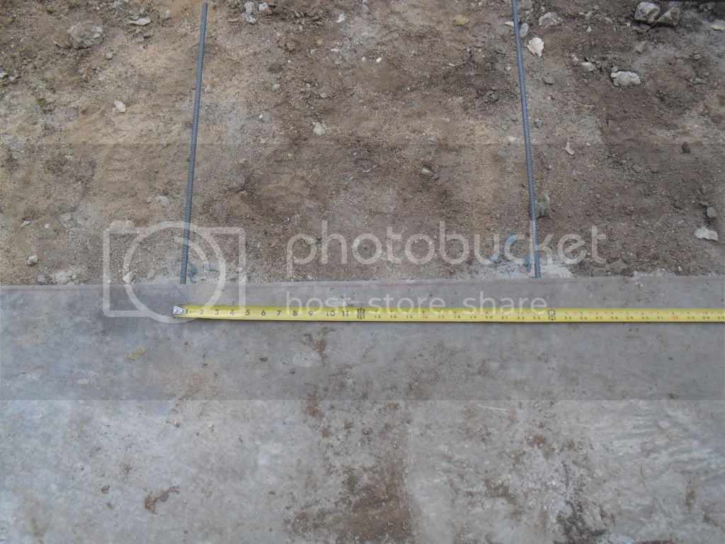

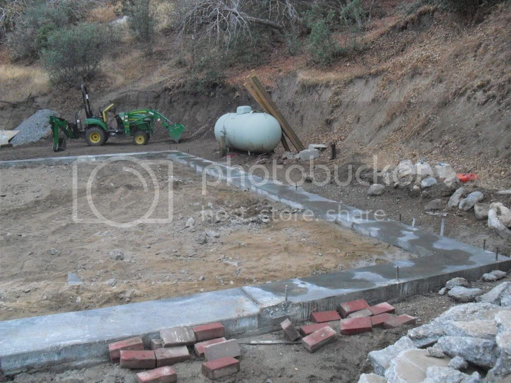

Sorry for skipping the middle part. The pad has been a bit of a nightmare. The pour was 27 yards of concrete, split between 3 loads. The first truck (footings) got lost on the way up to our place so the concrete had been in the truck for upwards of 2 hours, the 2nd truck (left half of pad) was waiting to pour for about the same amount of time, then the concrete sat for 2 hours before the right half of the pad was poured. Long story short, we had a cold joint in the middle and then they decided to sawcut the pad before it had all cured.
All of the cuts crumbled so I had them cut it out. They left the footings and had an engineering firm get approval to dowel the new with the old. This is a permitted garage so I was ok with it.
The only part that sucks is that they deep jointed the pad so I'll have to contend with the wide grooves when cleaning out the shop. It doesn't worry me too much because I'll be using a 400hp Stihl blower to send the dirt on it's way. I swear when I strap that thing to my boy and have him point it down it'll launch him like a jetpack.:D (Shameless plug for D'Animal)

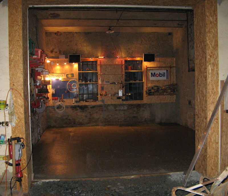

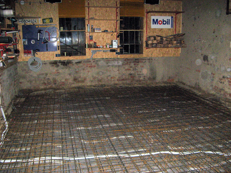

Today the concrete got poured in, couldnt watch it ......had to work.
Before
Steel and more steel.......the floor will be 30cm / 1feet thick
After :)

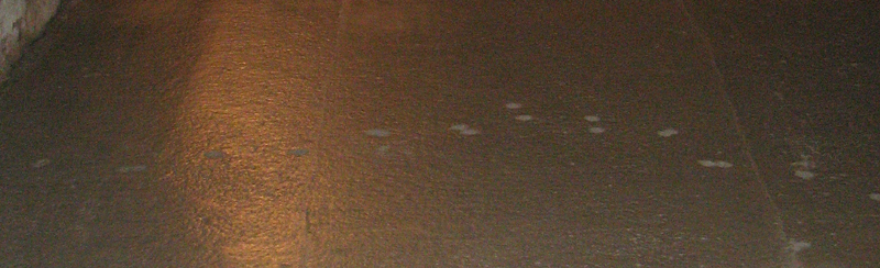

Minor bummer.........:whoops:
Neighbours cat walked over the fresh soft and warm concrete.......furry little bastard! ;)

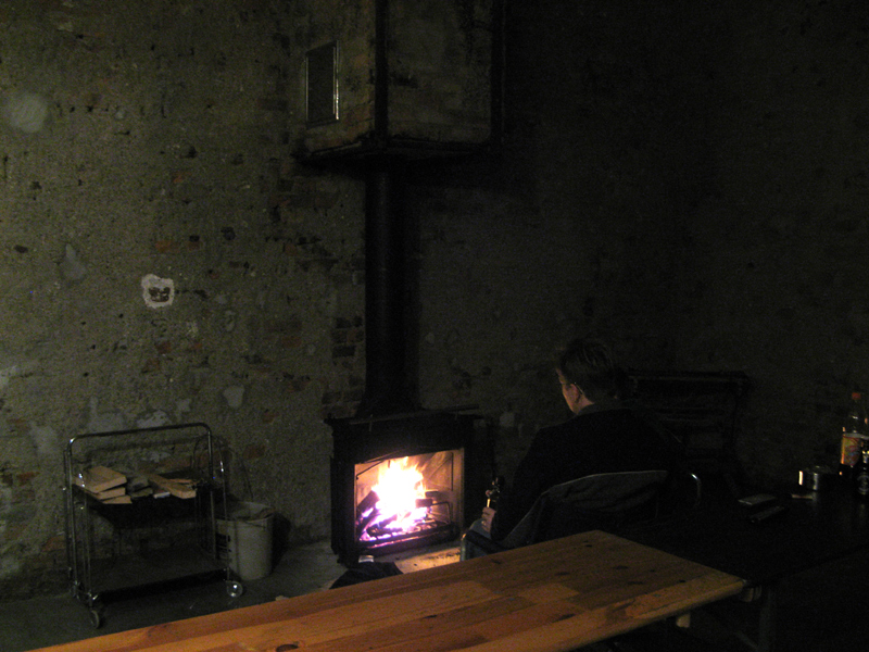

Yesterday evening :popcorn:
:bounce2::bounce::bounce2:Got the Franklin installed.:bounce::bounce2::bounce:
...just like a inside campfire, had no marshmallows......:whoops:
The 50€ buying that thing on FleaBay are a good investment for my man-cave future, i guess.

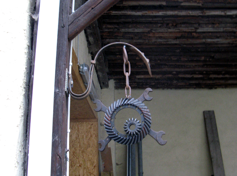

Had some time on my hands while watching the concrete drying that week.
Always thought of using these leftovers for something ...;)
Nice use of the left overs! Did you keep the power hammer in the 3rd pic from post 114? Any chance you could get some other pics of it if you did keep it? I so want one of those!

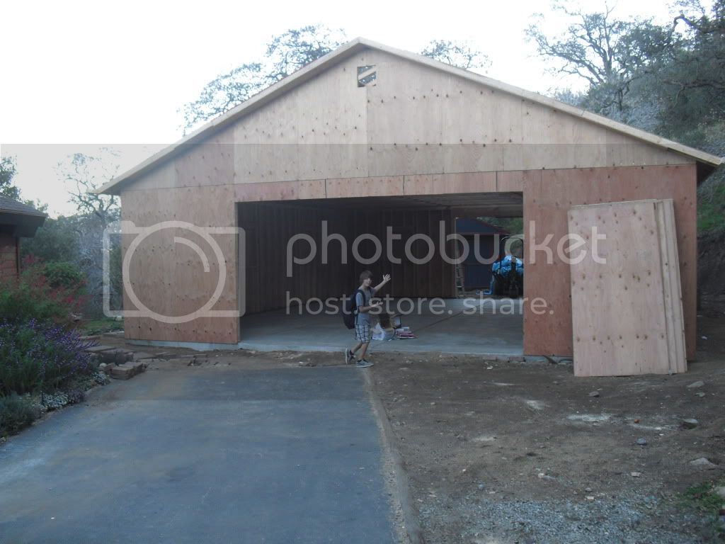

Almost done. Roof, side door and most of the windows are in. Since the pad set us back a month the builder said he'd install 2 more windows to make up for the trouble. One will go on the south wall above the workbench, the other in the front on the south side of the garage door. The wife was set on red so that's what she got. I just couldn't see fighting about color for the next 10 years (to life):bang:. Green trim to match house. Eventually we'll side the front with cedar.
