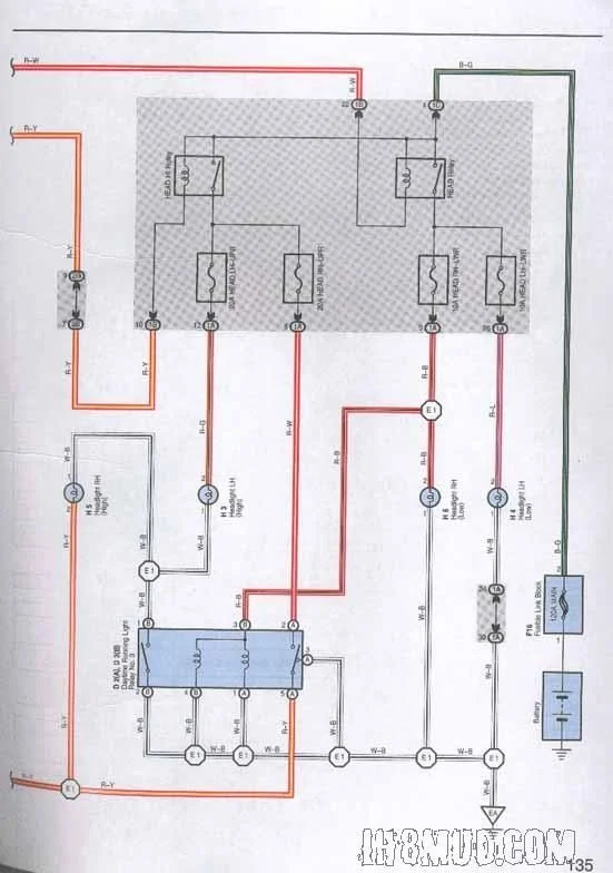

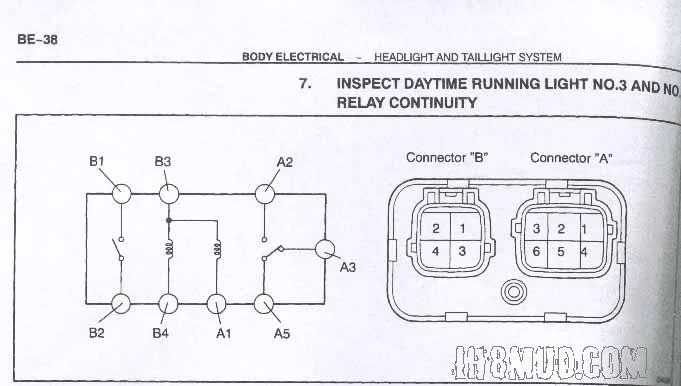

Last night I cut the A3 wire to kill the DRLs (only for '03 and later 100's - thanks Jim Chow) https://forum.ih8mud.com/100-series-cruisers/164555-drl.html now I'm going to add a switch in-line to manually control the DRL's on/off.

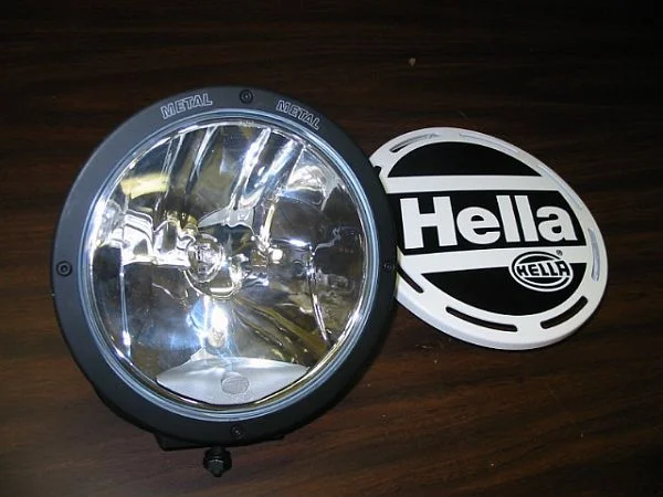

Now I want to add a pair of HELLA 4000's or the new HELLA Free Form 4000's
---I might keep them stock with the 100watt bulbs or maybe upgrade to the brighter bulb (120 or 140 I think) - the FF has the 55watt bulb and I hear they're great

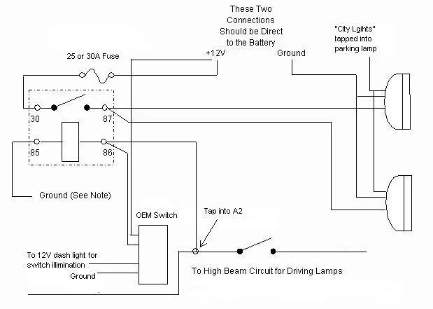

Either way I go with the hardware I ideally want to have the option to trigger the Hella's when I hit the high beams OR manually with my OEM switch on the dash - anyone done this?? If so, how do you "trigger" a circuit, such as driving lights, with the high beams without actually using that high beam circuit to run the driving lamps? Any ideas on how to do that AND still have it wired to a factory OEM dash switch for manual operation?
Does anyone know if the Hella 4000's will fit the Sahara using the stock ARB holes? I am pretty sure they do....
Anyone try the new Hella 4000 Free Forms with the 55watt bulb? I hear they are much better than the old 4000's with the 100watt bulb..
