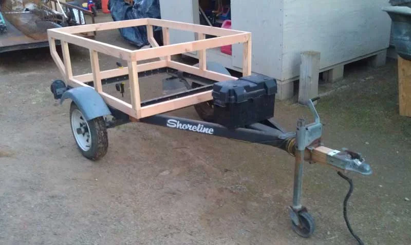

I couldn't take it anymore, I finally started my trailer build..:bounce:.I have bin watching all the great build threads here, making my list and plans.

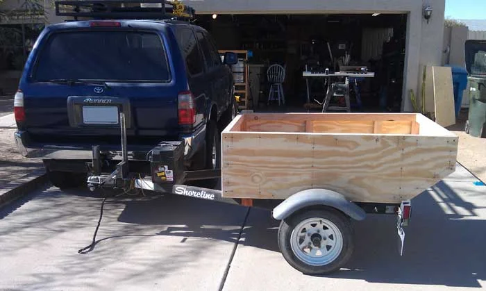

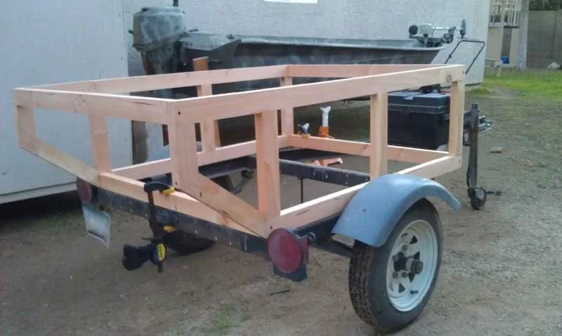

I deceided to use an old boat trailer that I have not used for a few years and start by modifying the tongue length with a mock up using wood (I will replace with metal once weight/testing done) I had laying around. I am going to build the box out of wood just because I have alot of 2x6's from a donation. I planed the wood till it looked like new and got to building.....I will strengthen the frame and eventually put the required propane, RTT, box, battery, etc...wish me luck and thanks for all the ideas from your builds.
Now I am trying to choose if I will sheet it inside the framing or outside....:bang:

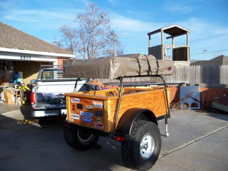

So I was trying to figure out a solution for the trailer top. I have seen quite a few ideas on here. But wouldn't mind a few suggestions, pics. I plan to put a RTT on the trailer, and want to be able to access to the trailer while someone is in the RTT...what have your experiences with this been? I am leaning towards putting the RTT about 1 foot above the trailer with stilts and either making a lid that splits down the middle from front to back that is hinged to be tables on each side when open, or... sew up a canvas top...
Cool little trailer! I went with the wood idea for weight savings and have had no issues with it coming apart, however it is just bolted to the deck of a 2x2x1/4" frame. My solution for getting it above the box for access was to add two hoops tied to the frame using a bracket that allows me to remove the whole set up. Using an angle on the down tubes seems to make it more rigid and less likely to sway while towing it to remote camp sites. I have made the rear of the box a swinging tailgate since these pics were taken using a piano hinge and a paddle handle. This has worked well and allows access while the tent is set up. Hope this helps your "vision" on an already good start.

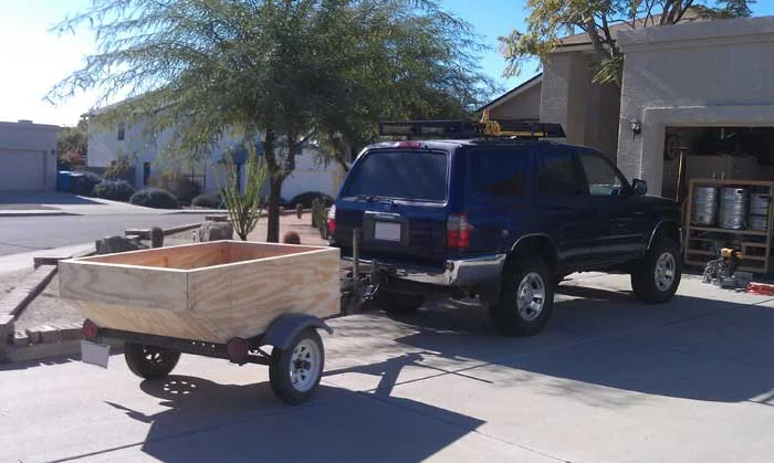

You might end up front heavy (tongue heavy) with the axle that far back. Nice little trailer though. How does it pull when loaded up?

I have had the axle that far back for over ten years without any issues, pulls great and is very stable at highway speeds. The RTT was added two years ago but that was only around 175# to the total weight of about 500# loaded. It wasn't designed for extremely heavy loads just camping gear and such.
The hitch is 90" from the axle and used to be 1/2 the distance of the body of the trailer until I broke out Smoke Axe and shortened it for departure angle. It works great for what I use it for.

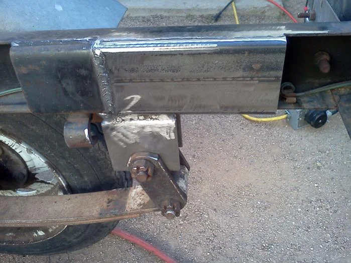

...The trailer had one of those slipper style springs (think that's what you call them). So I got some free-be springs and welded on shackle mounts...nice and quiet, smooth. :) :beer:
