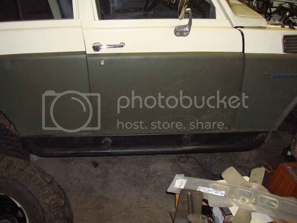

Here is a pic. Length of 4x4 = 68 3/8 inches.

I've seen the IPOR "sliders. They just match the factory curve (without the wheel well lips), but were 1/8 to 3/16" thick or something. You can chop out your old panels, or weld it on top of your old panels.
I have 2x4" (0.188") rockers welded to the body of my pig. I'm pretty happy with them-- they support the entire weight if necessary and allow me to pivot to turn really tight on rocks. The length would vary depending on how far up you cut the old rocker panels; grab a tape measure and measure it. My only regret is that I did not take advantage of having that big tube there for adding more ridgidity to the entire body
