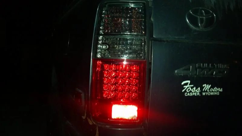

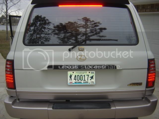

I was looking at those ones and the solid red ones. I opted to go for the solid red ones, and I like em a lot! They are bright and look good! They do have the resistors built in. I can post pics after I get off work today.

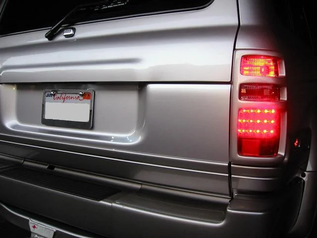

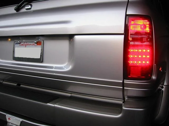

anybody ever seen these tail lights before? they are LED and i havent seen any other like them. just curious if anybody has any pictures of them installed, pictures of them in use, and general thoughts on them.

I have these in my truck. They look great - don't have any pics at the moment but I'll get some this afternoon. Way brighter than stock and I think they update the truck a little bit aesthetically.
They don't come with LED reverse or signal bulbs (just regular incandescent amber signal bulbs - reverse are on you), so I bought these LED signal bulbs which required these resistors (1 per side) to prevent fast flashing.

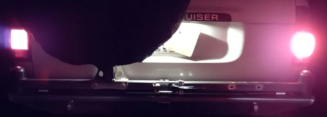

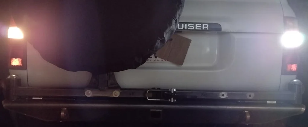

A decade later folks viewing this thread, some pics of circular LED bulbs w/ side + top illumination ordered on Amazon for reference:
: Left Incandescent: ____________________ :Right LED Bulb:
1156 Oxilam White "6000K, 3000 Lumens" for Signal & Reverse

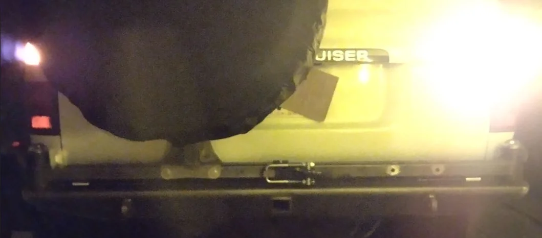

Hazards on:
My reverse are missing reflectors though have t-slot provisions for some(?):
Illumination, LED on left:
1157 TomHasa Red "1600 Lumen" w/top lens for Running & Brake (Only running shown):

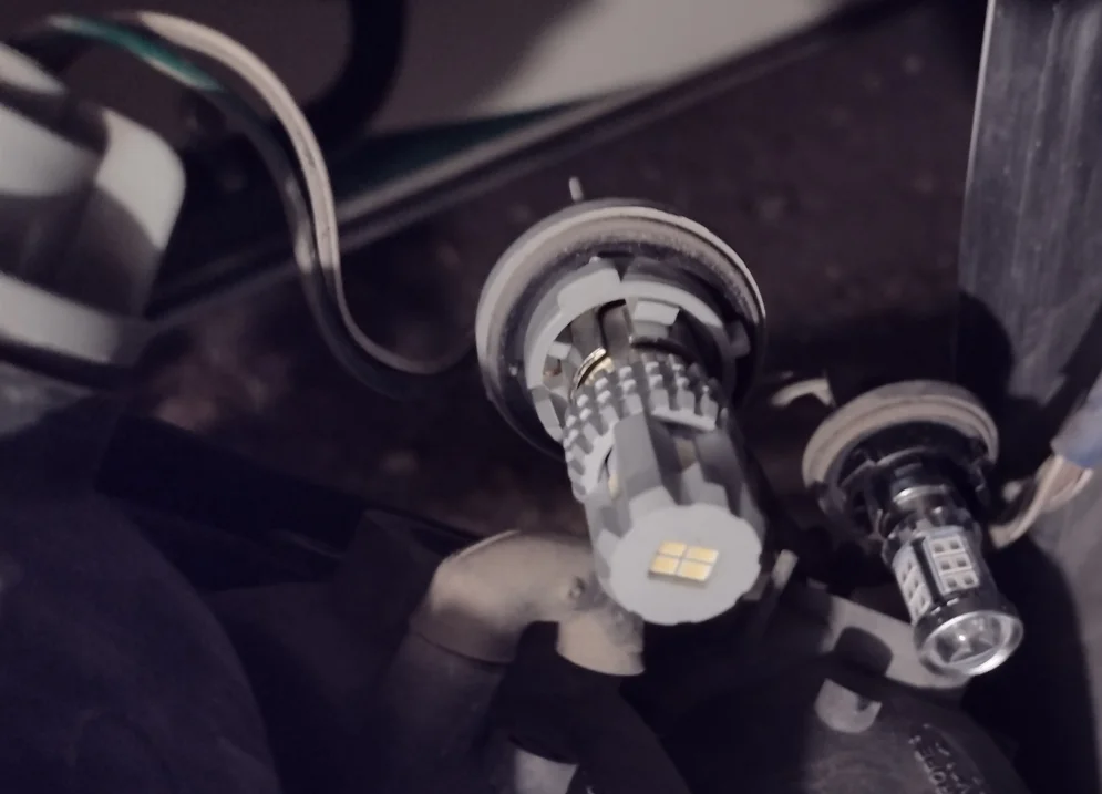

1156 Left & 1157 Right -- both fit snug into socket w/o clearancing:
