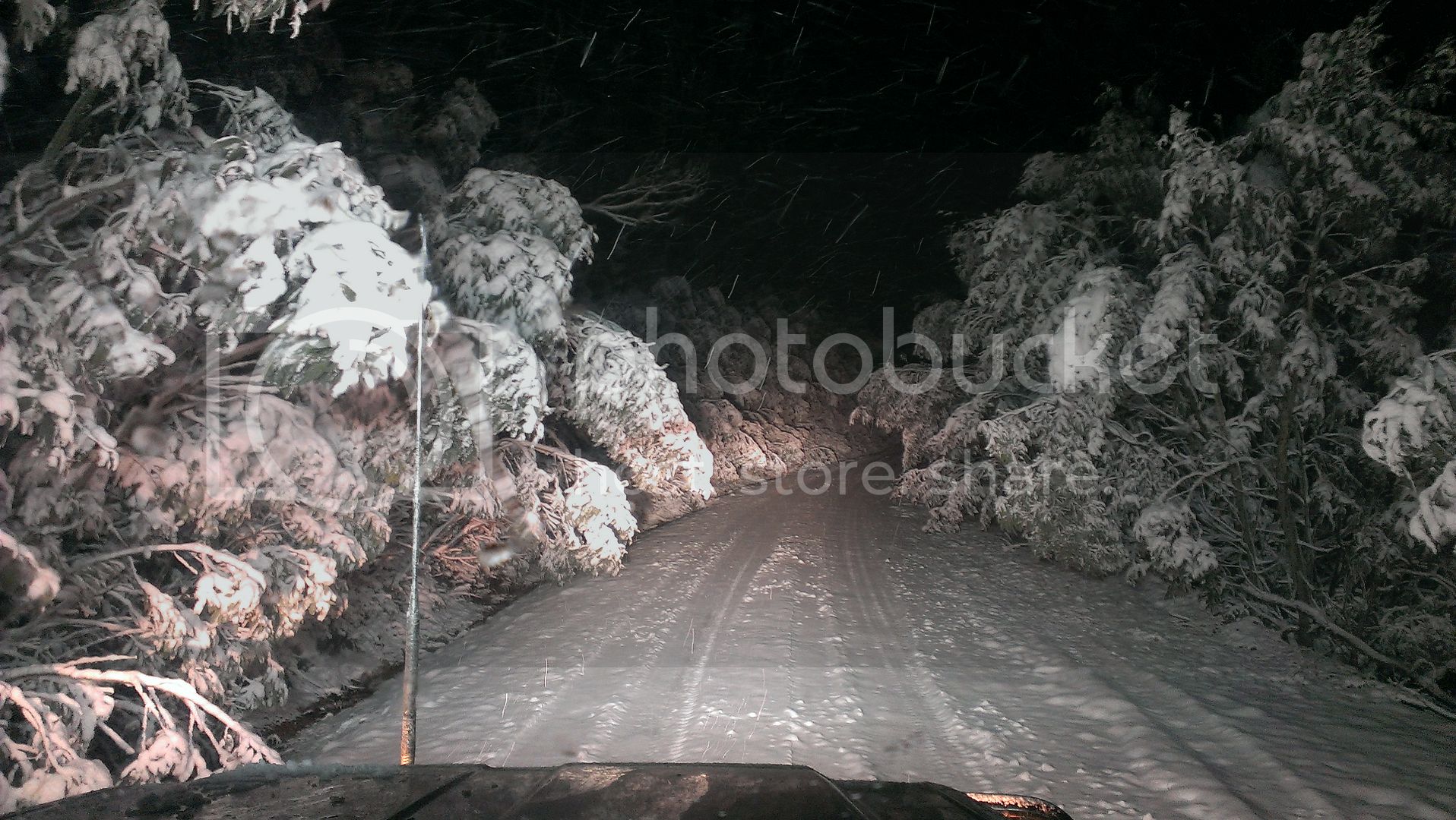

The Lightforce HID's are very adjustable and as you can see offer amazing light. :)
