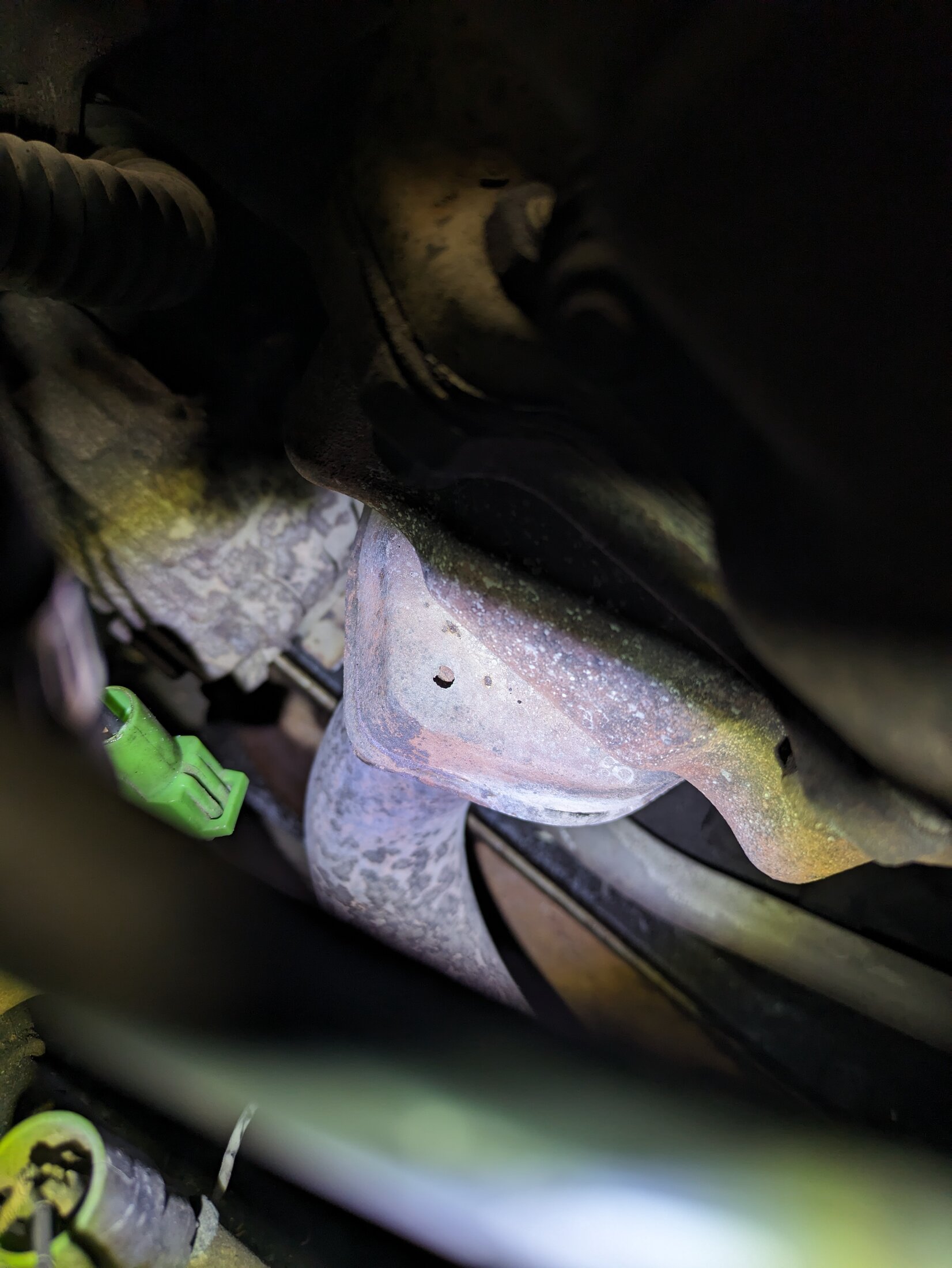

Is this little hole on the manifold under the carb going to be a big issue?
No.
The exhaust downpipe has (3) studs, that hole is right above one of them.
This is on my bench, the other two 2F engines I have are the same.

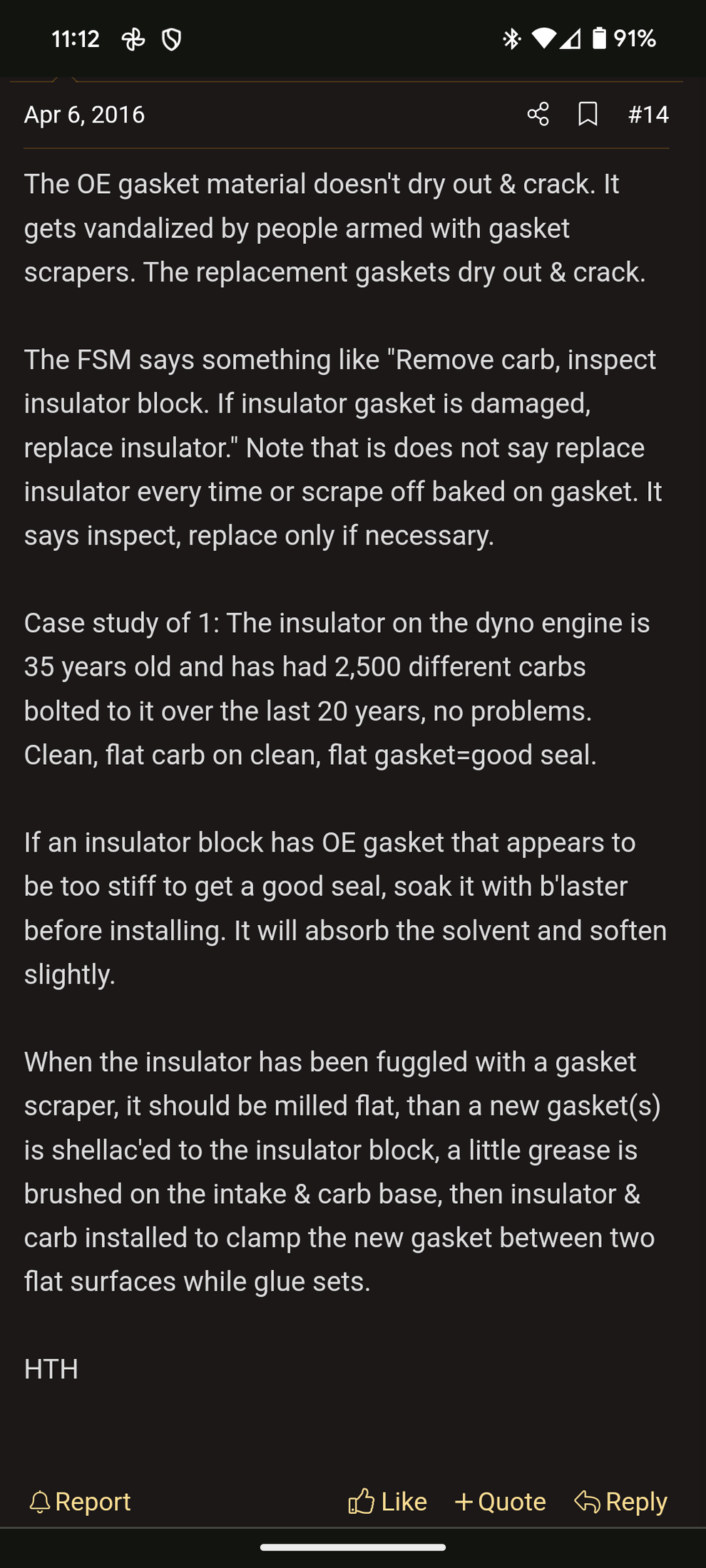

Used carb insulator plate came today. I cleaned it up and soaked the bottom gasket in pb blaster. I think the gasket looks good. Is there anything else I should apply between the insulator plate and the manifold? Fuel resistant gasket maker? (29132)
