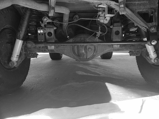

Welcome India!!! :D It's so cool that Toys have brought is all together. Glad to have you. The stock 90-95 4Runner has a 5 link coil suspension, 2 going forward on each side, and one going sideways.
Here's a shot of the right end of the "panhard" (sideways) bar.
