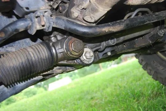

The steering rack's input seal is leaking pretty good on my wife's '97 4Runner. I have not had any luck in identifying the seal itself or its dimensions. Replacing that would make more sense that replacing the whole rack. Does anybody have any information on that seal? Maybe a dead rack from which a seal could be removed and measured? Thanks in advance.

pics
Yes, part # and some pics if possible. My rack on my 2000 os leaking as well and it looks like seal. 252.webp
