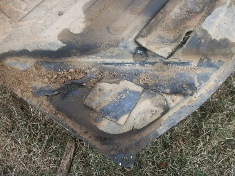

A few folks have developed a crack in te groove recessed for ebrake cable and the step down at front of tank. I hope that's not it cause I've yet to find the cure

View attachment 1069705 A few folks have developed a crack in te groove recessed for ebrake cable and the step down at front of tank. I hope that's not it cause I've yet to find the cure

Have seen several of these fail in this same spot. Professional repairs are more expensive than a good used tank, so have swapped tanks on all of them so far. Stress fracture on a compound curve that may be thin from the manufacturing process is the best guestamation so far. John
