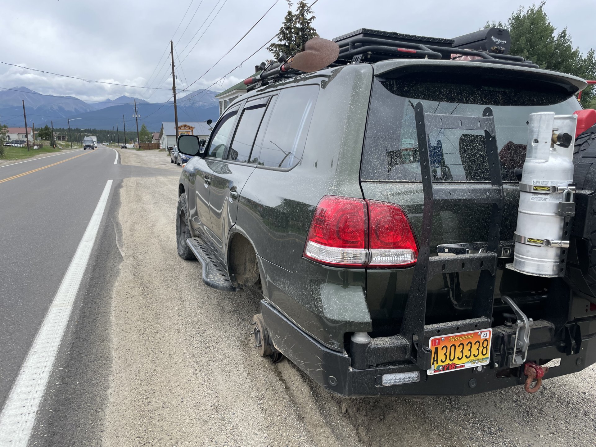

I’m good but thanks for offering! Wheel recovered, only a mailbox taken out. Hi Lift for the win. Just picked up a set of lug nuts and shall proceed to get with it. Got lunch with the crew after Mosquito and the wheel ate s*** a mile down the road.
Holy crap dude :oops:. I’m going to re-torque my wheels right now! How messed up are your rear brakes?
You’re a saint, @grinchy, thanks. Luckily no broken studs, just missing nuts. The wheel was torqued, hell, I gave Robert the torque wrench. I just never did a follow up retorque after X miles. Two days of trail riding did her in. Didn’t go looking for damage but the dust shield was pushed into the rotor. Screw driver and channel locks made quick work of that. Robbed a lug nut off each wheel + spare to get moving. Auto parts store in town had a set of lug nuts, so back in action. Back to my plan of taking Weston Pass.
I heard each lug nut click from the torque wrench. I'm guessing the wrench was set too low.
Always smart to double check later. Lessons learned all around, and no one hurt.
-Chris
-Chris
Maybe but I’d say not retorquing is more likely the root cause. Especially with the trails Jeff was on.
