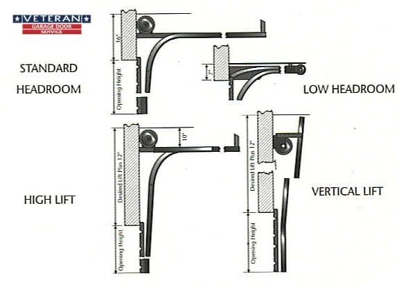

For those looking for actual understanding, most garage doors hang into the garage door opening 3 - 6". A side mount garage door opener will allow this overlap to about 2 - 4" as you can adjust the door open upwards an additional 1 - 2", more than a center mount garage door opener. Using a set of high lift or extended radius tracks, you move the garage door up and away from the door frame an additional amount, to the maximum extent possible, limited by the ceiling height or storage racks above the door. The video I posted shows an example at the 2:50 mark the the door frame fully cleared, allowing the maximum vehicle drive in height.
Also below are photos and links showing more about high lift or extended radius tracks.

Once again, none of these solutions change the size of the garage door opening, which is more likely to be a limiting factor than what style of opener you have. I would imagine this is the origin of the question at hand.
Most people only measure to the point at which the door hangs into the door opening, this is not the limiting factor, it is the height of the garage door frame itself. I've presented several solutions to work within your constraints that allow the garage door to be raised up to clear the garage door frame opening.
