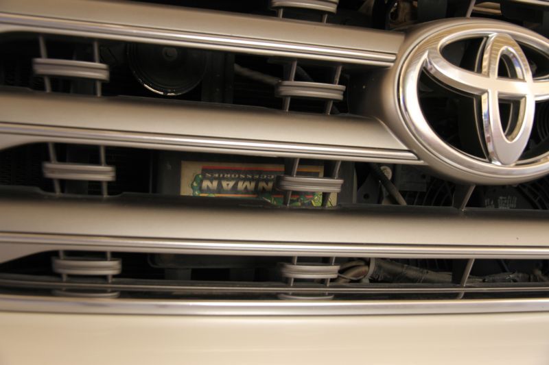

2. Control box of the winch visible through the grille. It sits in front of the radiator but I've never noticed any problems with heat, even in the Saudi summer. Toyota mounts the original under the dash but this works too.
