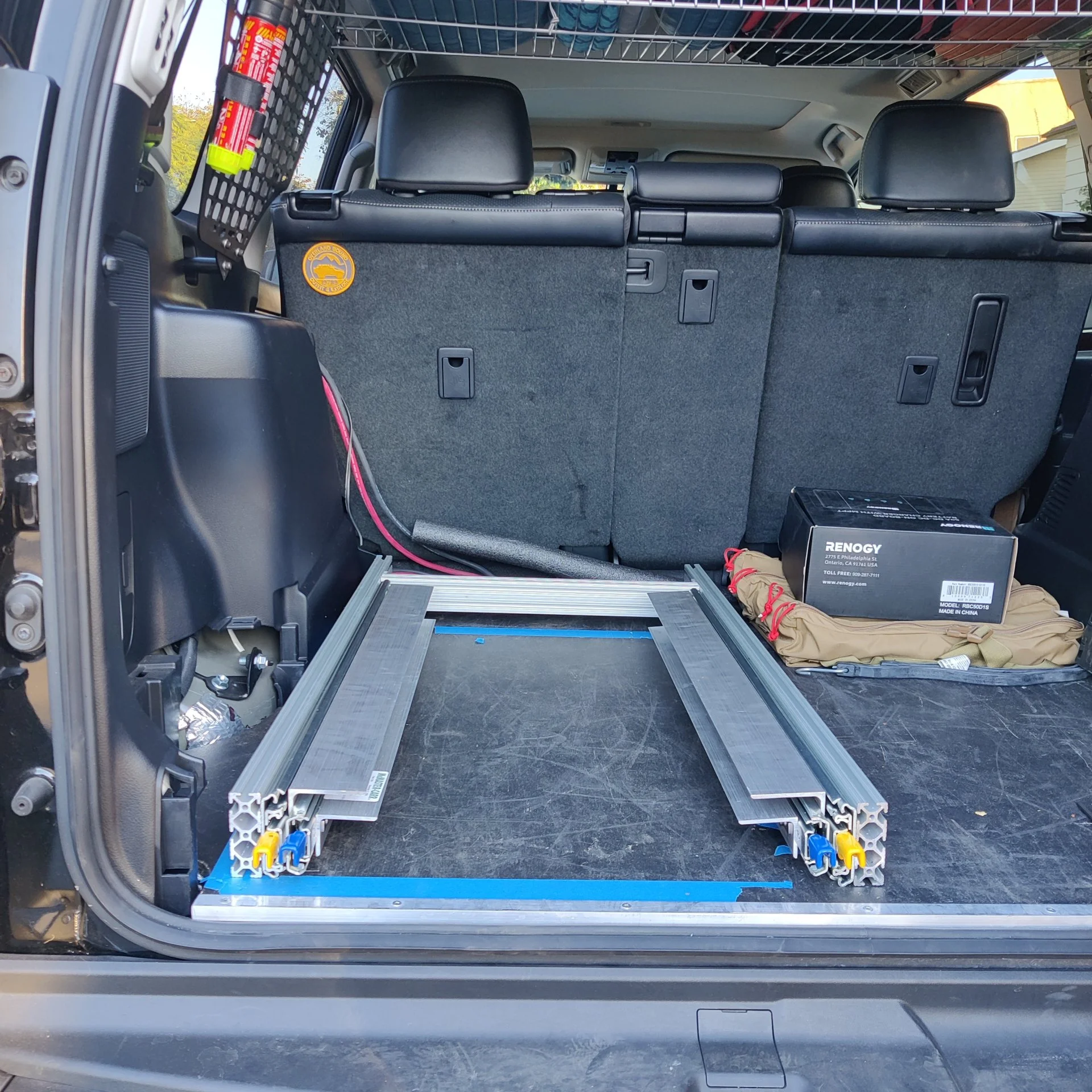

To start off the 3rd row seats came out and a plywood platform was installed. If I were to do this again, I'd go with thicker plywood, I used 1/2 baltic birch, 3/4" would help prevent deflection. I sprayed the plywood with a few coats of truck bed liner. Installed an aluminum angle at the exposed edge to take the abuse of moving gear in and out.

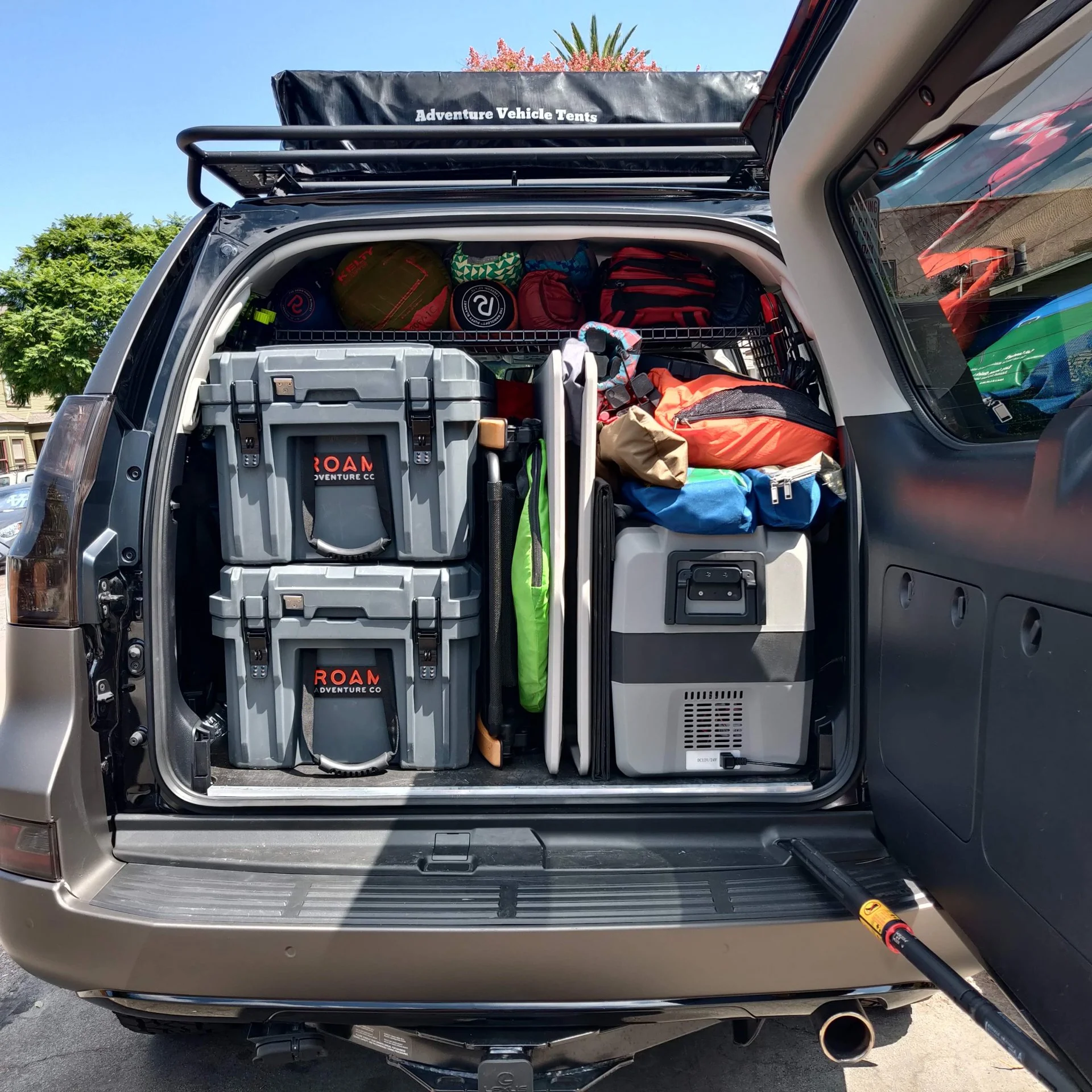

As you can see, its easy to max out the storage in the back.

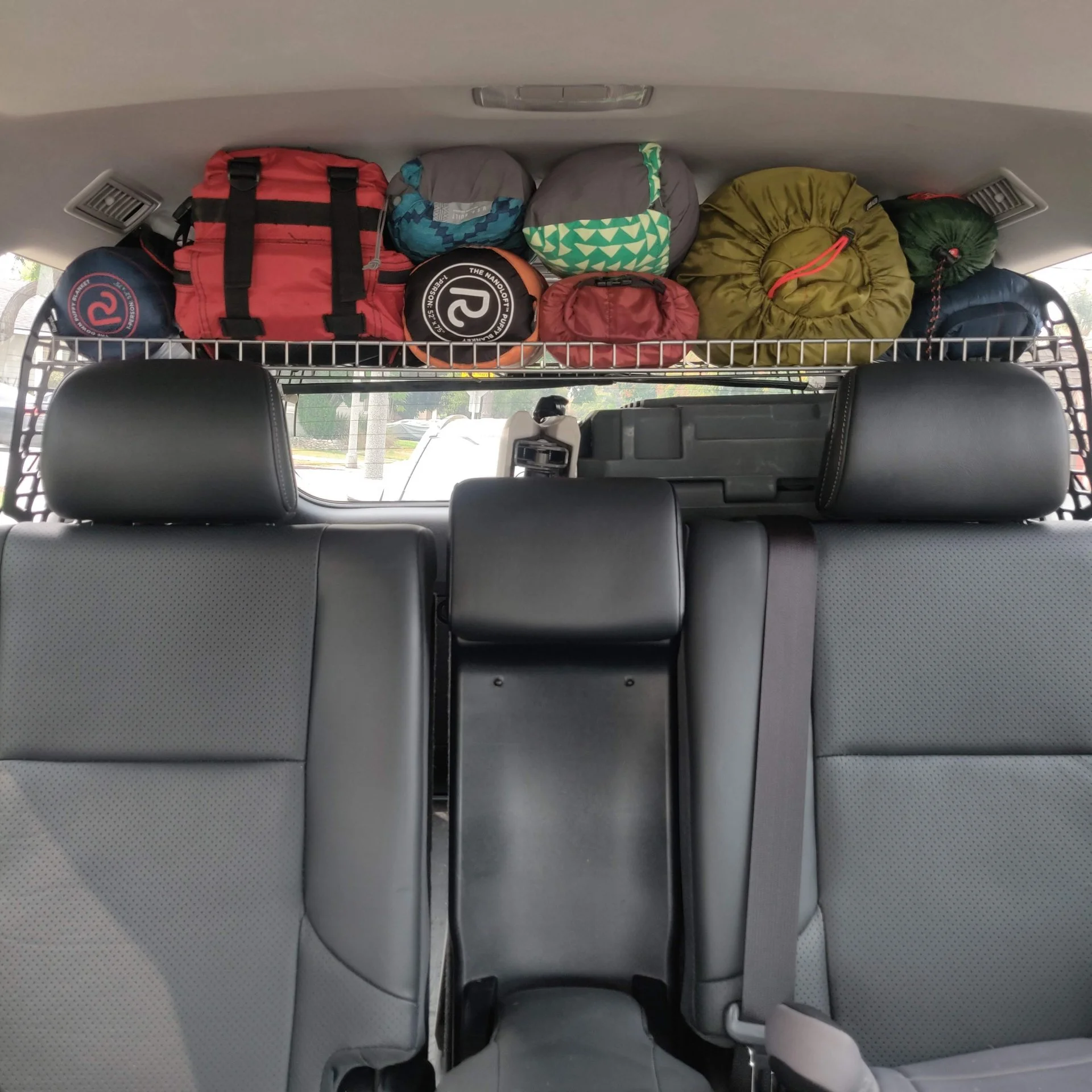

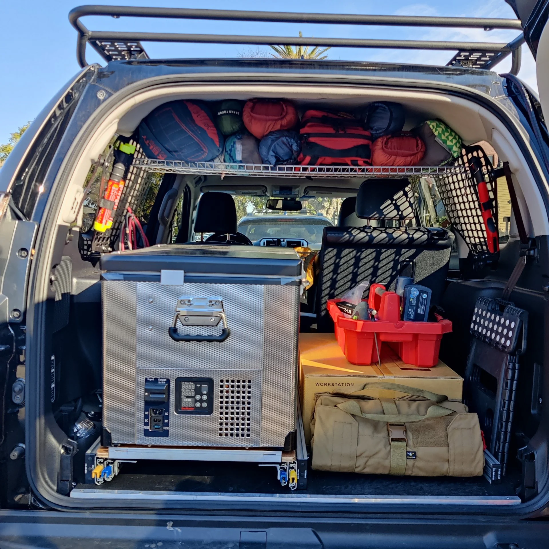

I always liked the idea of the overhead shelf, but couldn't come to terms with spending a lot of money on it. So I stopped by Lowes and bought a wire closet shelf and tied it to the rear window molle panels. It sags a little in the middle, but works great!

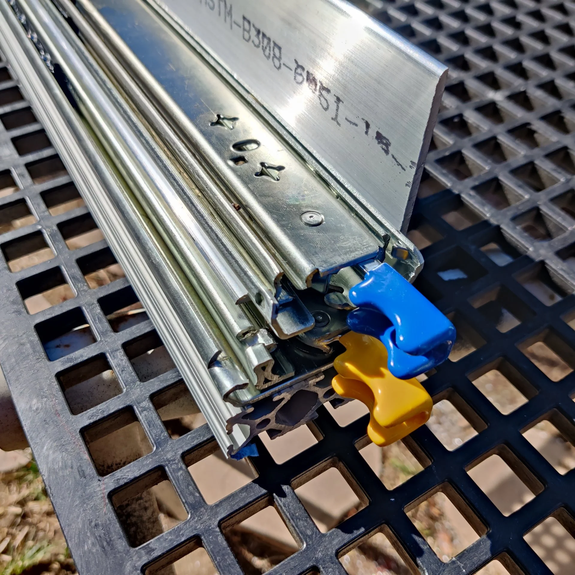

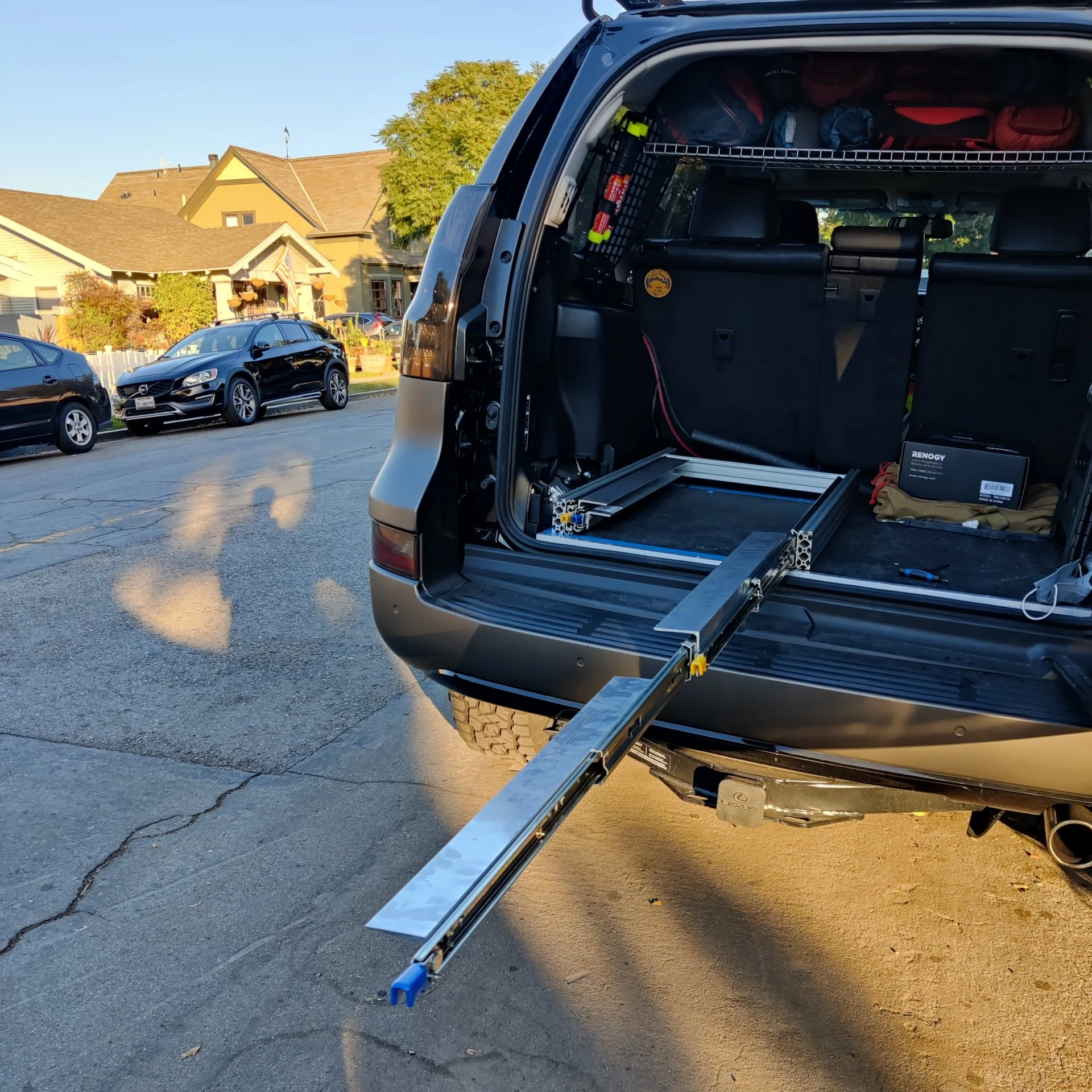

Next up was to build the refrigerator slide. I like the idea of the nesting slides to add more table space. I ended up buying some super heavy duty locking slides from Amazon. and figured out a way to nest them using the stock holes. The aluminum extrusions provide the structure and framework.

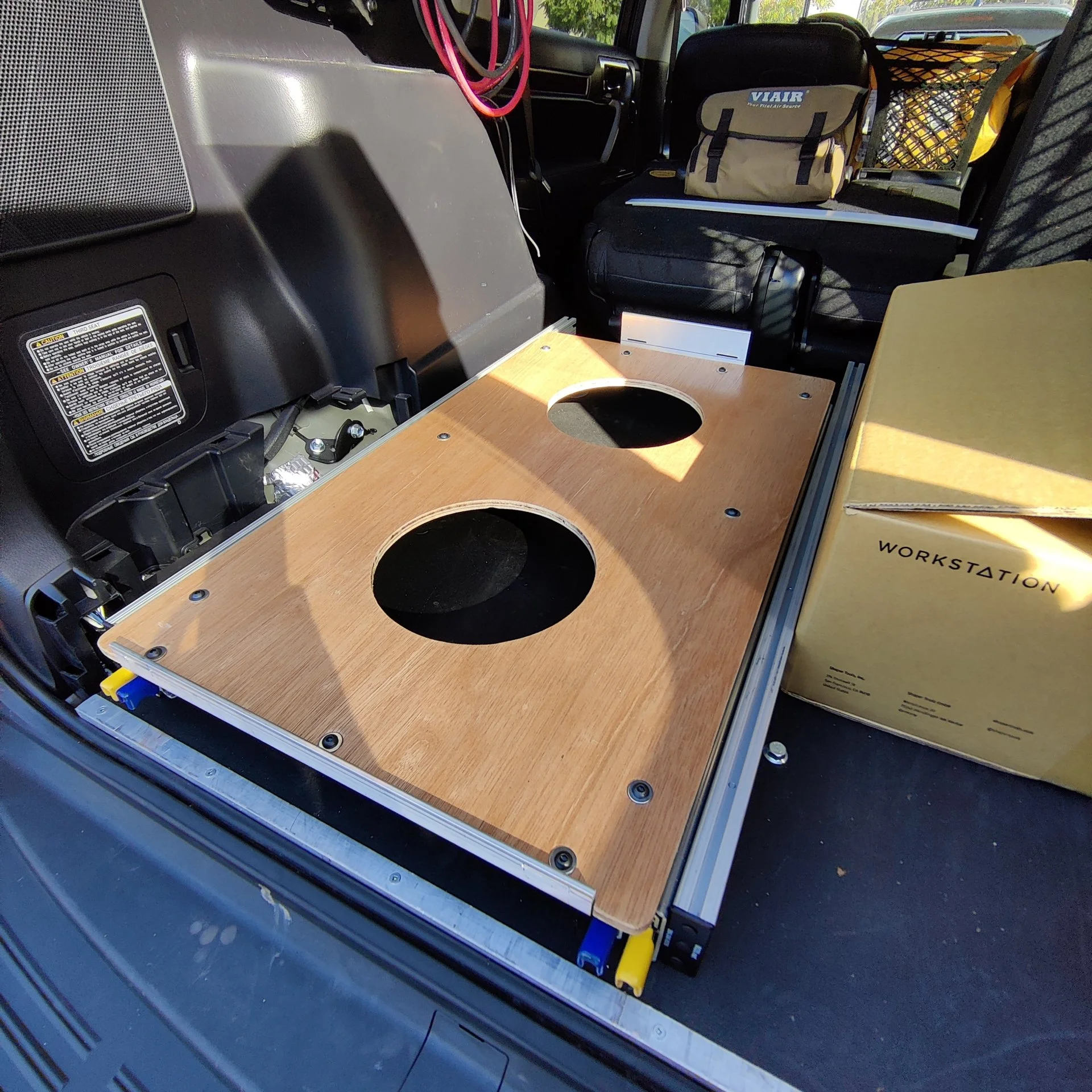

The next step was to tie the 2 slides together and make a base for the refrigerator to sit on. I cut some holes in the base, thinking I'd be saving weight, although only a few ounces, ha!
Wow it fits! And doesn't fall out!
Impressive work! Do you plan to build a surround over the fridge so you can add some storage above it? From your first pic it looks like you could use it!
Also, when creating your baseplate, how did you measure out all those cuts? Did you source a template from somewhere? And with the baseplate, did you add supports underneath like there are on the goosegear version?
Yes, I'll post more on the progress.....
To tell you the truth, I don't remember if I put supports under the plywood or not. Once I through bolted the aluminum extrusions on all the flex went away. It might only be supported by the front and the hump towards the 2nd row seats. And I did use the factory bolt locations to secure it.

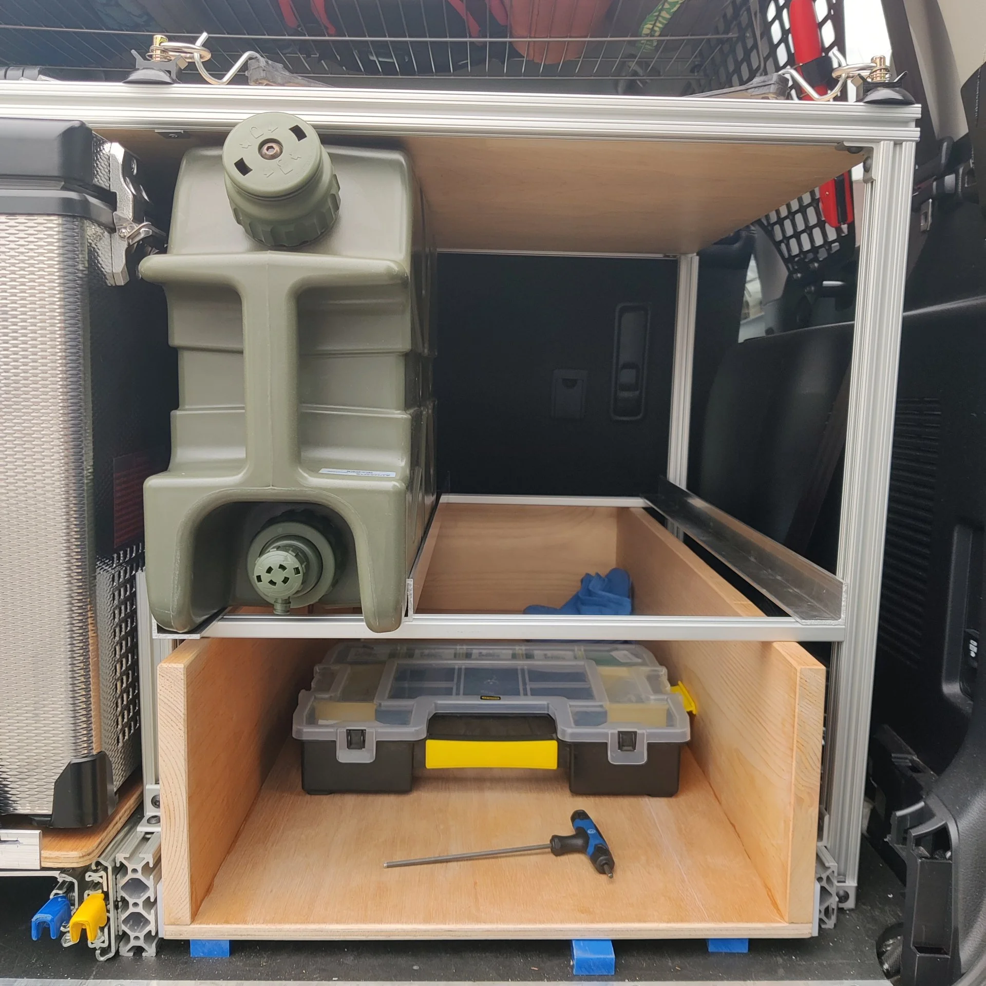

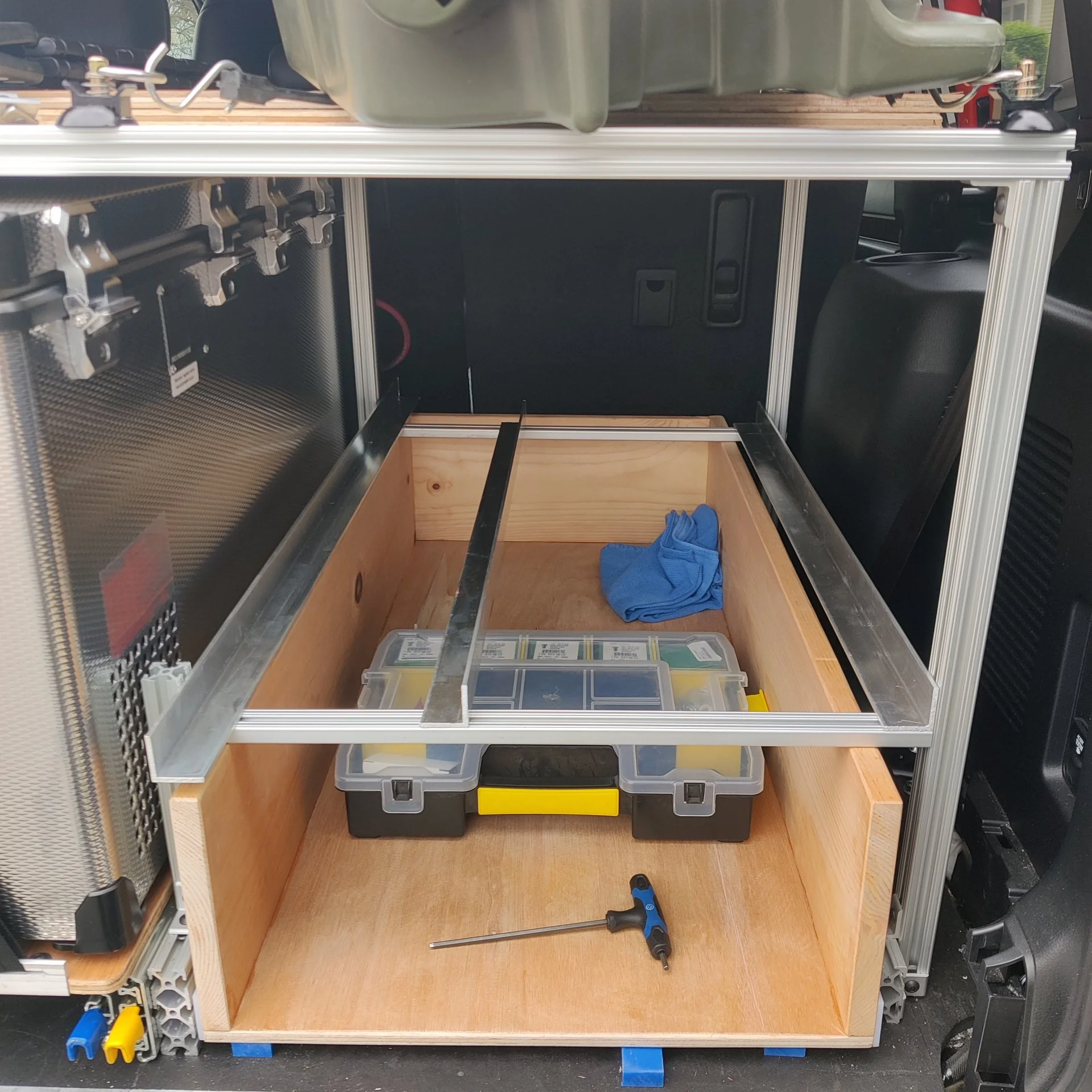

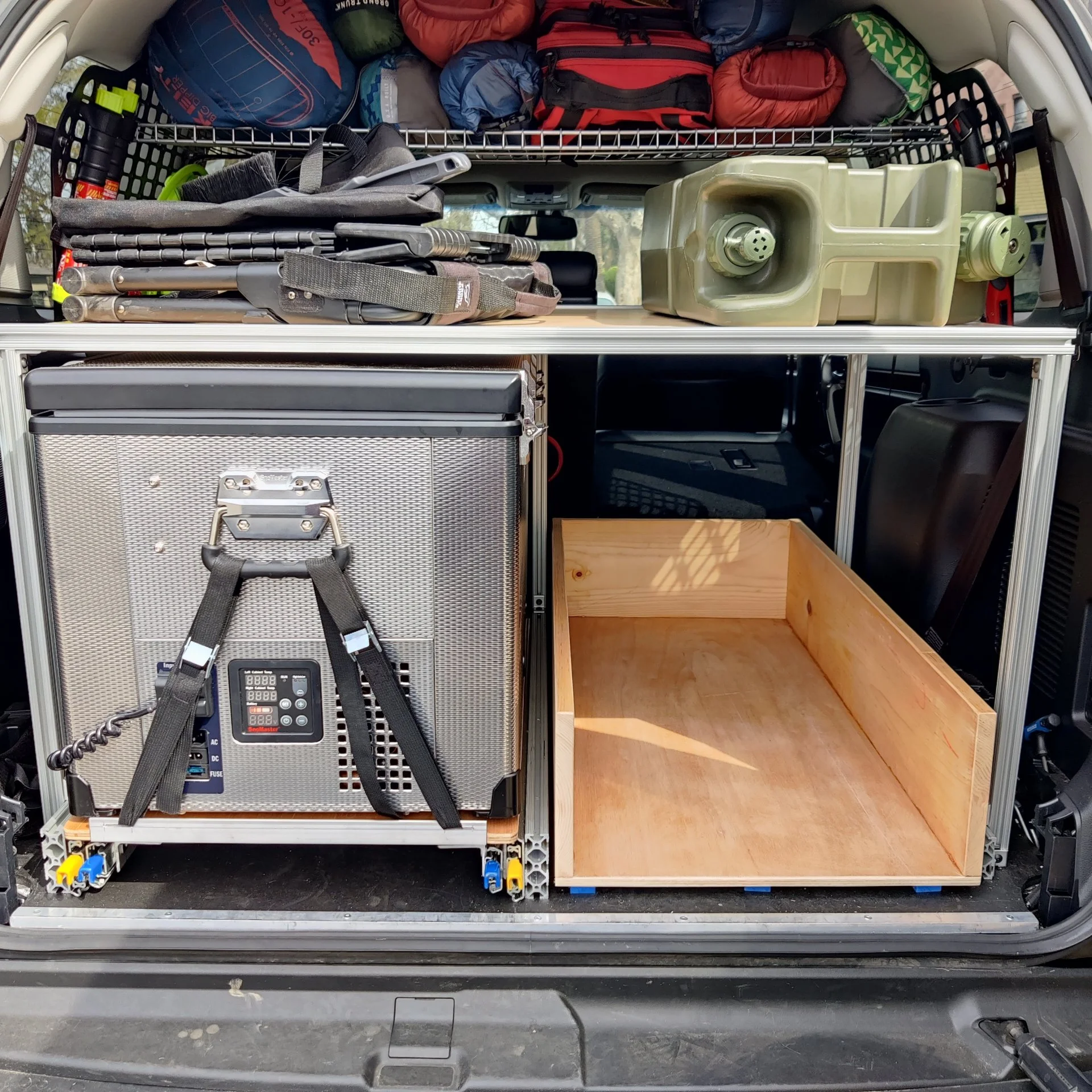

I continued with the aluminum extrusions and infilled with a 3/4" playwood panel that is screwed to 6 clips that are on the aluminum frame.
Next up were the drawers. This was really inspired by the Land Shark drawers. I like that they didn't use drawer slides. The slides are expensive and also take up space. I found some UHMW Polyethylene bars and strips and used those as the runners. The wood drawers slide perfectly on them.
And then I was thinking... what if we get the jerry can in there too. I'm able to fit 2
jerry cans deep. A standard amazon one, and the Life Saver one. Word.

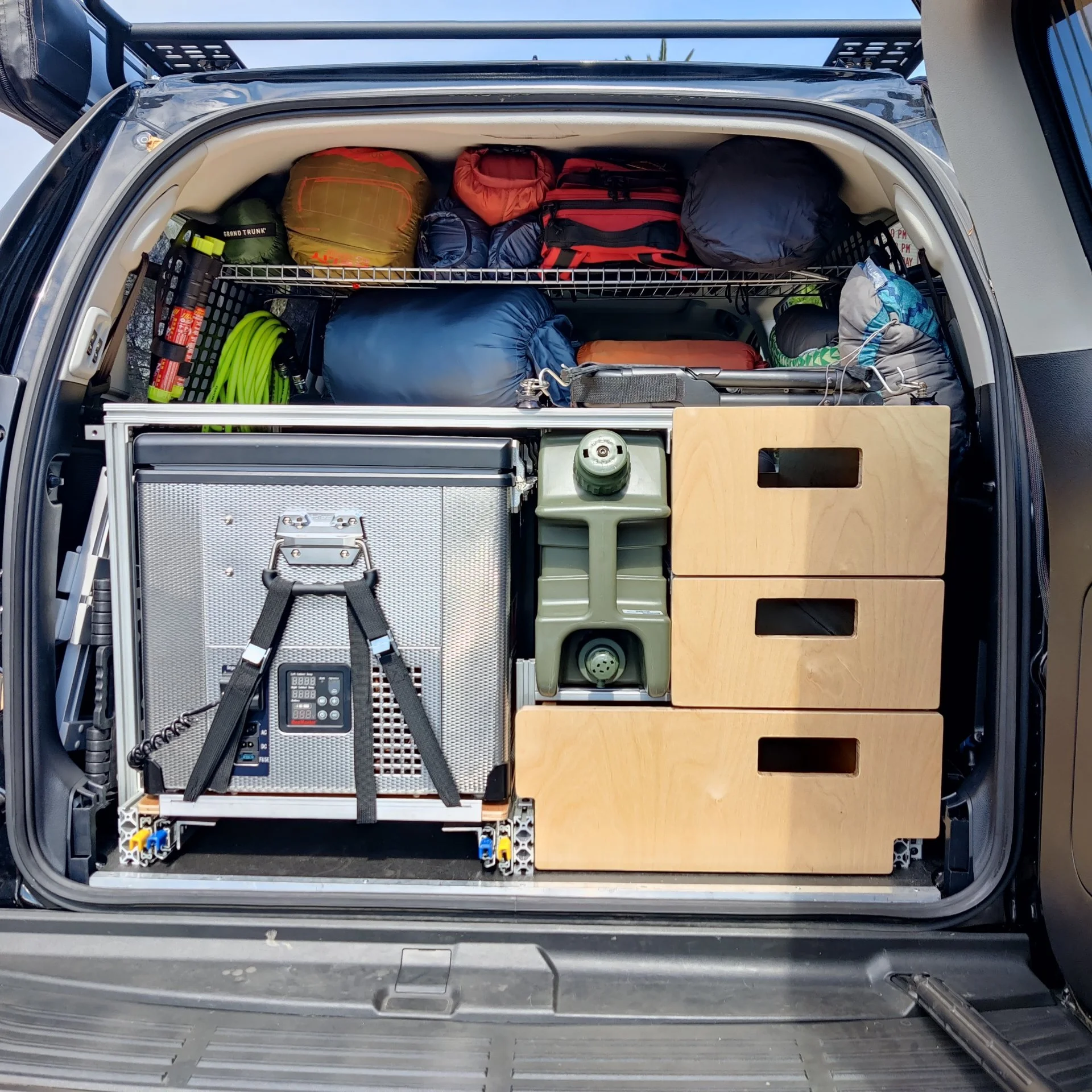

Cut some drawer faces out of 3/4" baltic birch plywood and we'll all set!

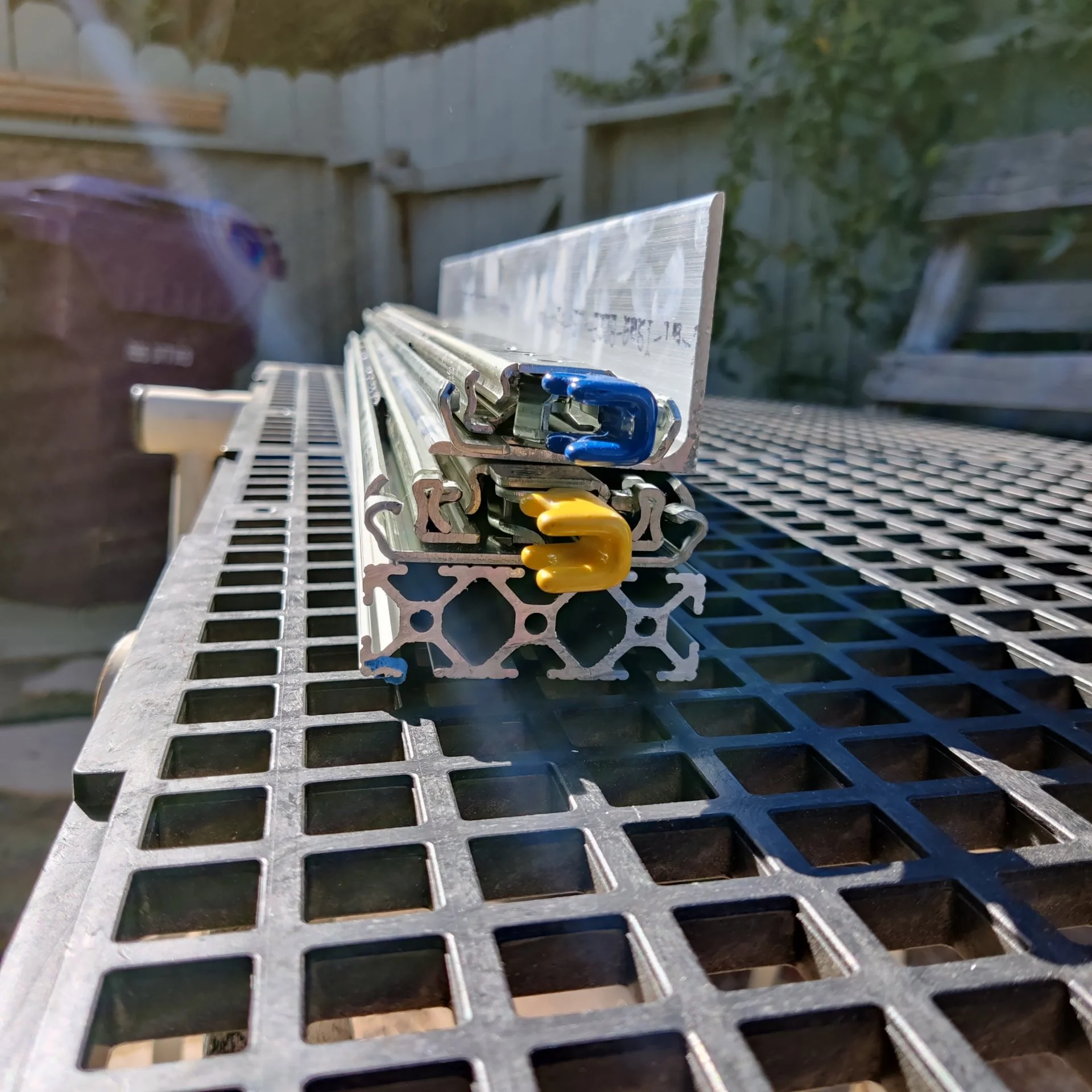

How did you end up nesting the two slides with the angle bar? A bolt & nut looks like it'll cause interference between the two slides
I'm building a similar set up for my 470 and was just going to use plywood between them but this would save some width...
There are factory holes along each side of the slide. Coincidentally some of the holes for each slide line up. I was able to use those with a button head screw and t-slot nut with loctite to attached the 2 slides together. I was ready to drill some holes, but ended up not needing to.

I did complete the nested slide as a work surface. Under that I have my step stool and small camp table in the little void.
