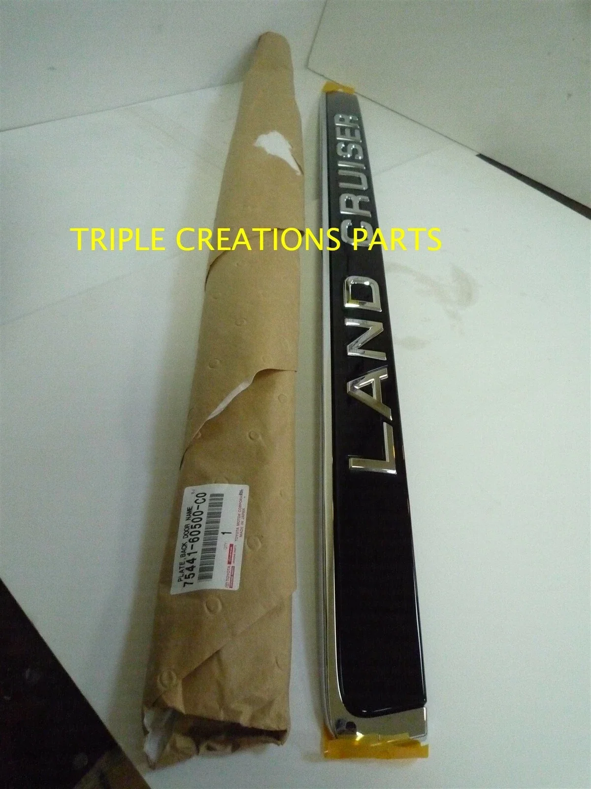

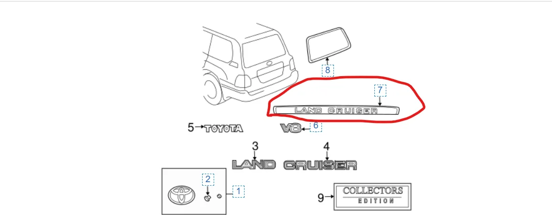

Has anyone done this, or know if its direct fit.

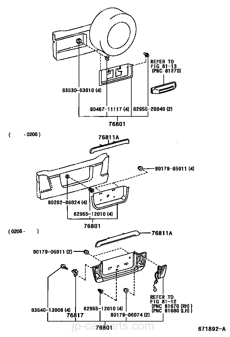

As the LX470 is the same body as the Land Cruiser Cygnus in some markets, you might try and find a part number from a diagram for model "UZJ100W-GNAZK" (I believe that's the Asian market Cygnus). [edit to add: I had kind of assumed there would be an option for the "Land Cruiser" garnish, but it looks like it was just the plain chrome for this model]

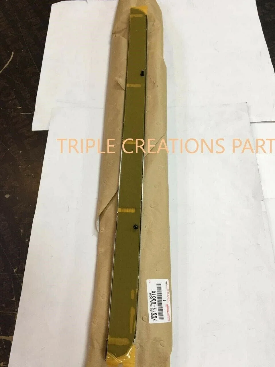

Looks like the garnish over the license plate area is 76812-60010
That said, it's a plain chrome trim piece, but you can use photos to compare to the mounting tabs on the back side of the "Land Cruiser" piece you were referencing... 76812-60010 Genuine Toyota Garnish Back Door Outside 7681260010 OEM | eBay - https://www.ebay.com/itm/352611172434
so far from what I can see in cross-referencing different garnish panels, they all appear very similar, so my inclination would be that it should be a direct swap.

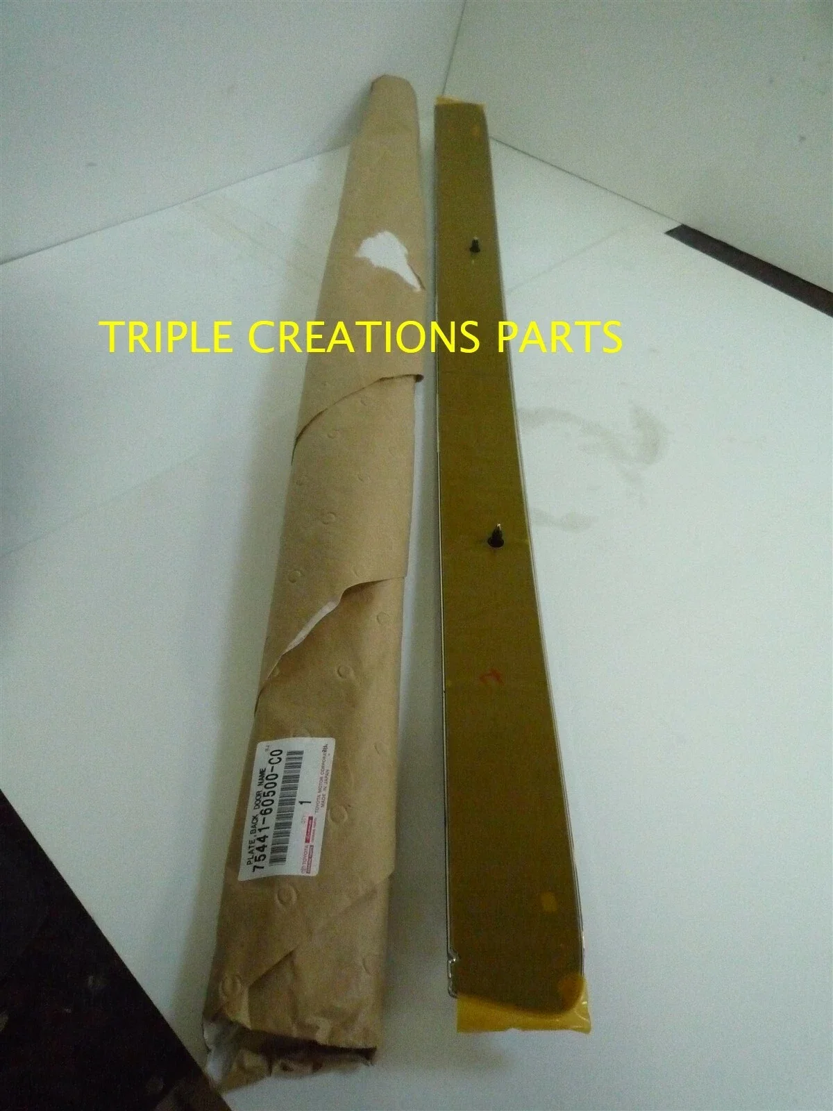

this looks to have the same mounting nubs... p/n 75441-60550-c0, looks like fitment's specified for '03-'07
