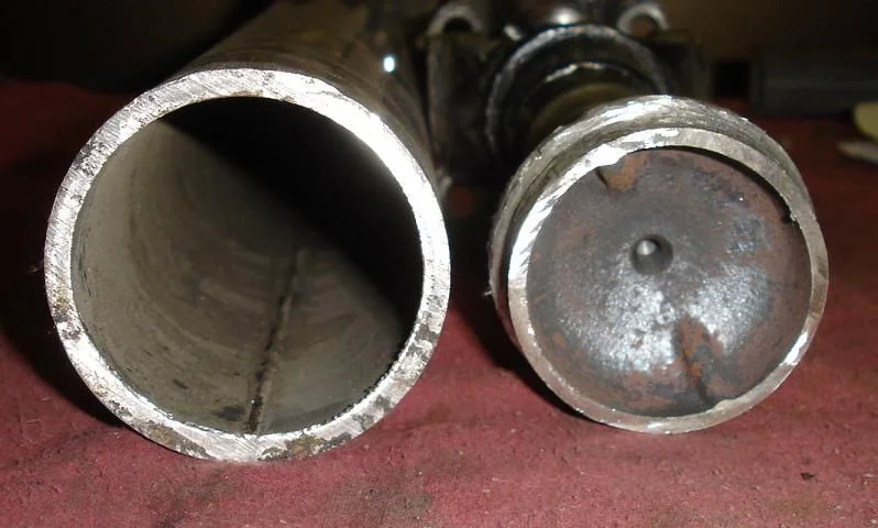

Maybe this will help you, i know it dosent answer any questions, but its another way to do the same thing!
(From the Pirate Toy Section FAQ)
Driveline - Heavy duty DIY Material
A toyota driveshaft end has a machined OD of 2.435".
2.5'' Sch. 40 pipe. is 2.875" OD x .203" thick which is almost 1/4'' wall and is a good fit for the toy yokes. You just have to use an endgrinder or the like to knock the seam down in the pipe. Using the pipe to retube is good for rear shafts or if you have links and don't need all the slip of a square shaft. (also slides on rocks better than square) This is a cheaper alternative to the strange sized 2 7/8" x 7/32" wall DOM tubing which can also be used for a DIY driveline.
this thread has some good info 2 1/2" Sch. 40 Pipe Drivelines Made Easy - Pirate4x4.Com Bulletin Board
