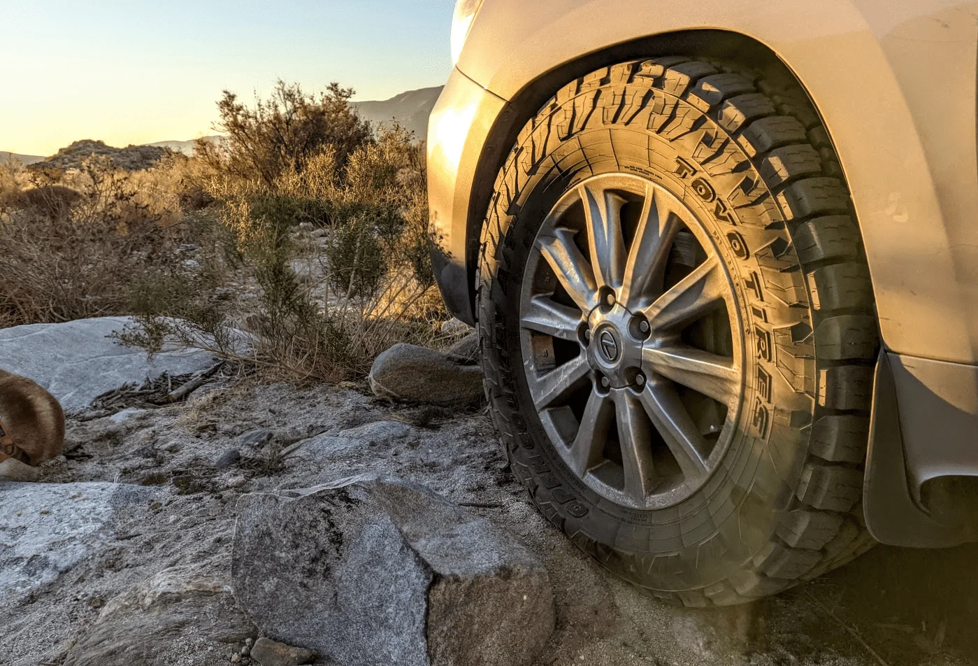

Largest Toyo AT3 to fit on stock LC and LX wheels?
Will those fit on the stock Lexus wheels? If so that’ll be my next set of tires. Perfect size.
I’ve currently got 275 60 r20. No complaints but I’d prefer a 295 if I could get away with it.
Easily. There's no limitations of the stock wheels to fit as big of a tire as you want. They're easily stronger than most anything you'll find in the aftermarket.
The LX is also more accommodating to bigger and wider tires as a result of not having KDSS bar clearance issues, so no need to limit sizing to what the LC guys run.
Get the offset right (~35mm) and stuff big meats - full fat 35x12.5 tires here on stock LX wheels.

Oh that’s what I should have asked...will that fit with stock wheels and no spacers.
do you know if 295 55 r20 will fit stock Lexus wheels with no spacers? Because that would be an ideal size.

Ah, gotcha. It may be close to the UCA and will depend on the specific profile of the Toyo. As the Toyo is not as aggressive as some other tires, it stands a solid chance to drop right in without any rub. There's arguable reasons to use a mild spacer through, just as there's reasons to not.

295/55R20 was a no go. Rubbing UCA and plastic. Back to drawing board.
Sorry to hear! It's probably just so close to fitting as a drop in. The plastics are almost trivial to address, but if it's rubbing on the UCA, then you'll want .75" spacers.

285x60x20. 1” spacers, plastic trimming, removed front mud flaps.
