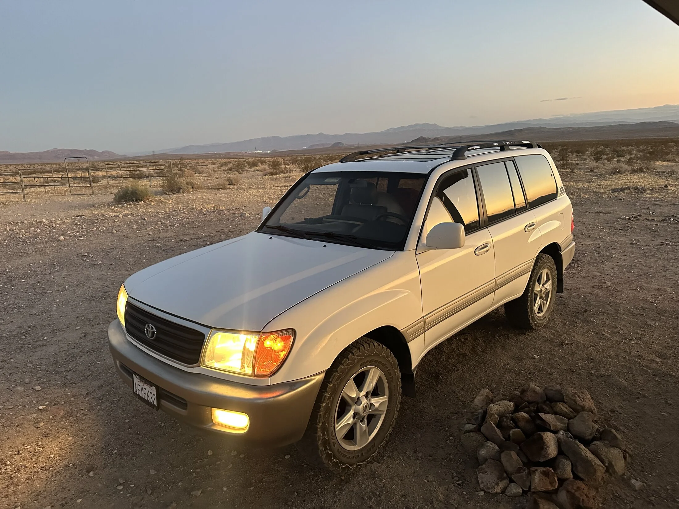

Anyone tried 285/70/17 (or similiar 33") with AHC in LO mode?
Should be fine. My 275/70/18 fit in low mode with occasional rub when in reverse and turning the wheel about 3/4 of full rotation (and I have 1.25" spacers which increases likelihood of rubbing). It hits at the pinch weld. 285/70/17 are slightly smaller.
aren't those 18s?
Corrected, they are 18s!
