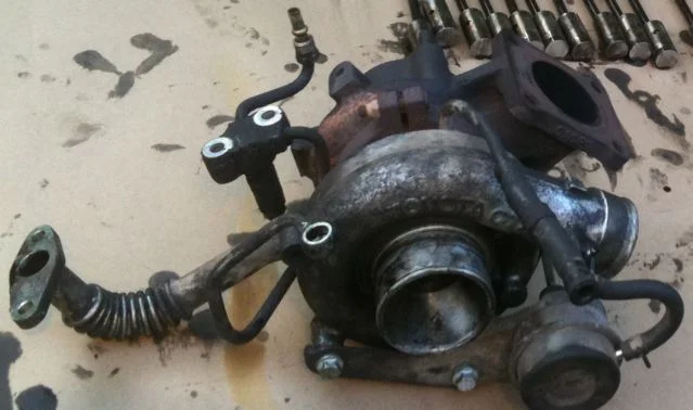

i am gonna get the turbo on my 12ht rebuild; my question is what is the largest turbine i can put on my turbo with out compromising too much on reliability.
also can you tell me how much of an increase on the engine performance i should expect from that turbine.
i am also gonna be installing an intercooler when the newly rebuild turbo is installed.
picture of my turbo below
thanks:bounce::bounce2:

A bigger turbine will simply swap low end torque for high end power. Not IMO what you want from a diesel.
What boost level are you currently running?
my turbo is current shim to 10 psi. can you pls explain what "swap low end torgue to high end power". how will that effect my driving on the freeway at 70 MPH or driving on bumpy roads at 30 MPH for extended period of time or high altitude driving?..... thanks

It will shift your boost curve up the rev range. You will lose some low rpm boost but the turbo will work a little better at high rpm.
This won't make much difference at 70mph in top gear, but if you change down for passing it will give you a little more power.
At lower rpm the engine will have less torque due to less boost. It will make driving at altitude worse as the thinner air makes the turbo require more rpm to work the same.

Umm.
Increasing the turbine size won't make your compressor do more, it'll actually make it do less.
A bigger turbine housing makes the compressor turn slower which provides less boost when the wastegate is closed and takes more rpm to reach the point where the wastegate opens.
The only point of a bigger turbine is to provide less restriction at higher rpm, this does provide a little more top end power.
At 10psi, I wouldn't bother with an intercooler.
