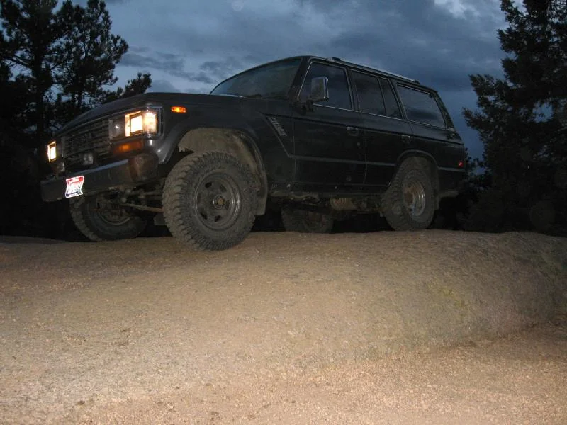

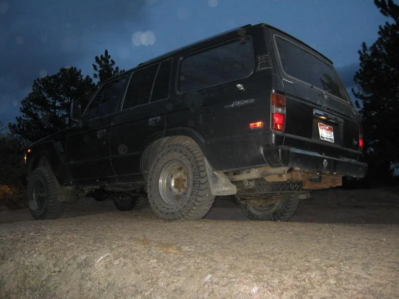

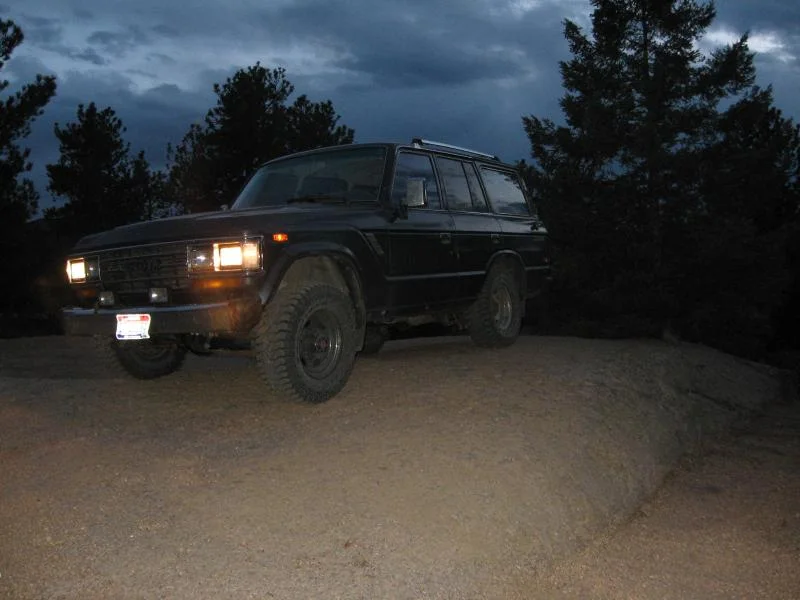

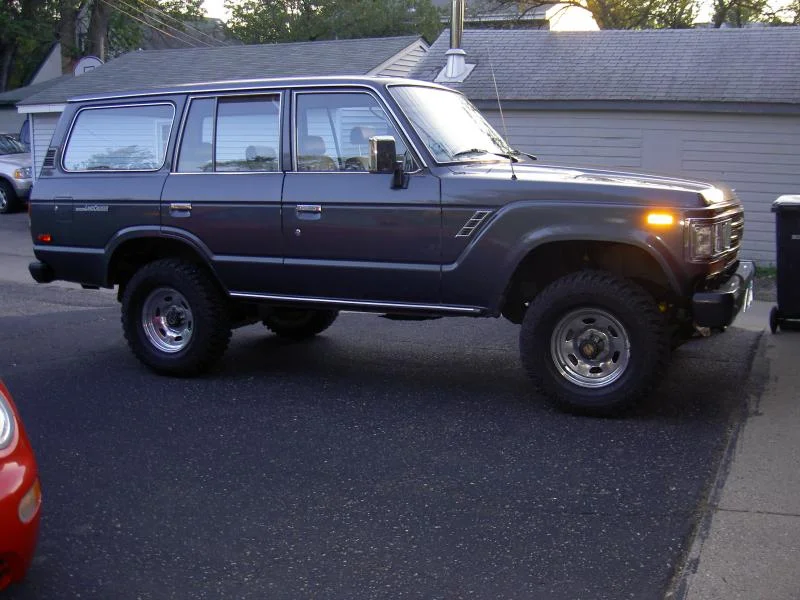

pics with 31x10.5.15
The pics are of my rig with 31x10.5x15 tires on stock springs. I usually get about 16 miles to the gallon on highway. These vehicles are never "fast" so I don't really think there is much of a difference between the stock tires and 31's. It feels different the first time you step into the rig and drive around though. You quickly get used to it though.

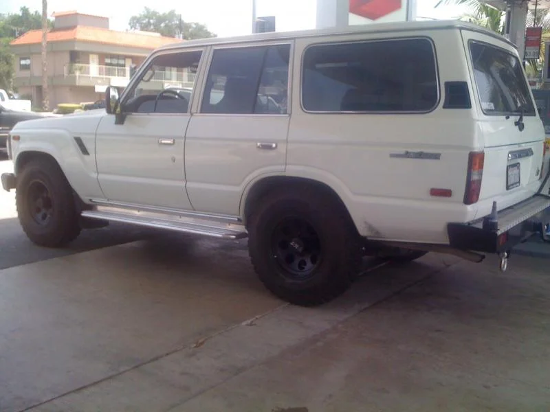

Here are some 31x10.5x15 with OME light/medium. 33's would be nice, but personally I wouldn't do it without going to 4.88 gears. Mine runs pretty good and still loses ground on long inclines with even a light load or a head wind.

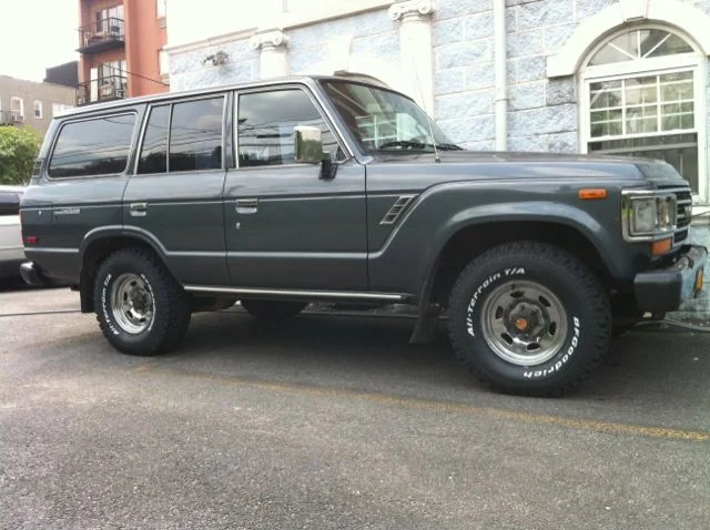

31x10.50's if you stay with stock height, 33's look much better with a lift, but gearing may become disappointing with the AT in a 62..in my opinion.

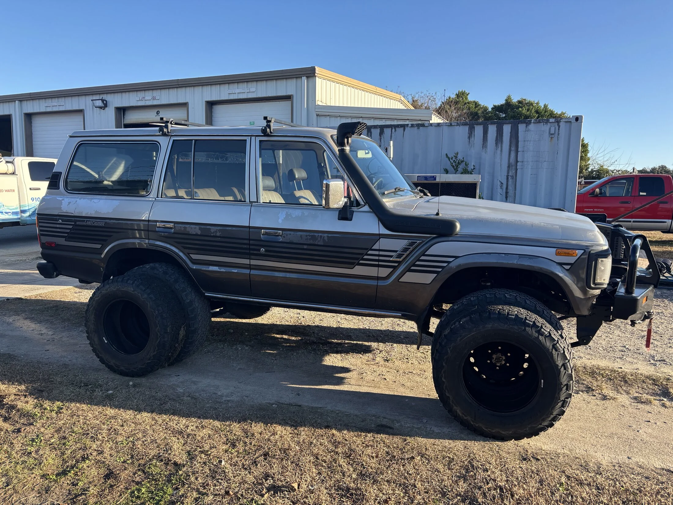

I purchased my cruiser with 35s and need to downsize to 32/31s…thing doesn’t drive well with 35s. Can’t imagine it drive well with 33s either without a re gear. Pic showing at my shop set of 265/70 R17 in front of my 35s. I look forward to the smaller tire plus 31s are plenty good off road for most conditions.
If I plan to re gear & arb lock in the future to make this a “rig” then I’d go to 33s but would want the 5 speed swap with that as well.
