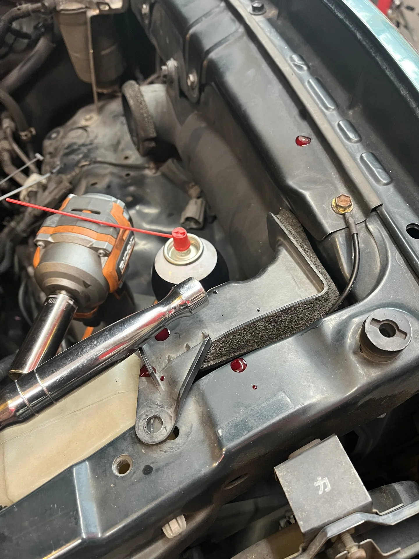

Got the cooling system drained and the radiator pulled this afternoon. It was definitely time to do the job… everything was in functIonal condition, but there was rust in the hoses and the radiator looked tired. No oil in the coolant that I could see, so that’s a good sign.
I’m seeing a valve cover gasket leak that wasn’t evident when I picked up the truck, but other than that and the cracked CV boots I’m not seeing fluids where there aren’t supposed to be any.

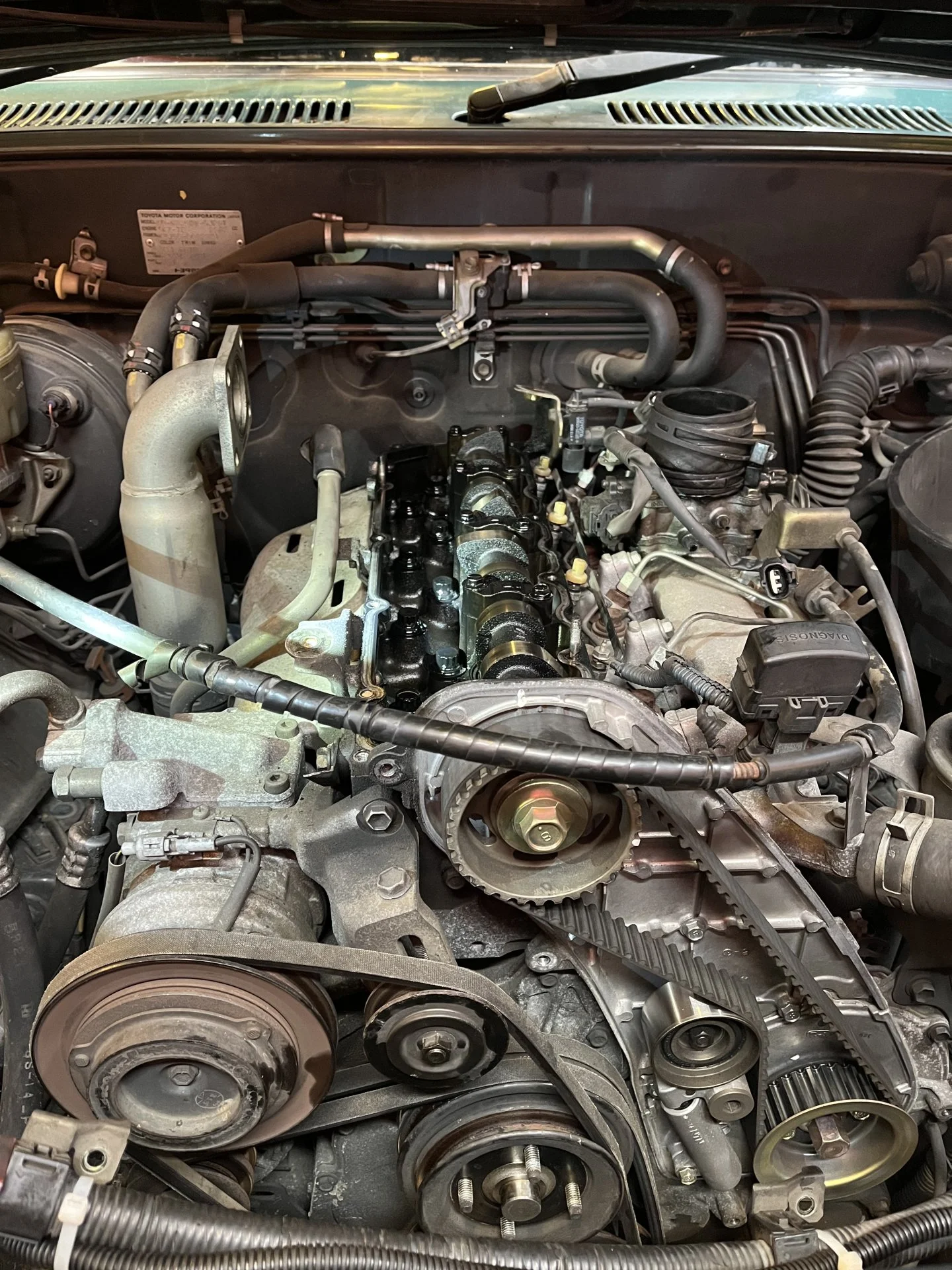

Slowly but surely… Had some time tonight to pull the fan, the intercooler, the valve cover and the timing belt cover. Cannot get over how much easier this thing is to work on than my previous BMWs… the last time I had to pull an intercooler and a valve cover off an E90 it was at least a 4-5 hour job.
Anyway, discovered a pretty decent VGC leak, so I’m glad I’m doing this job.

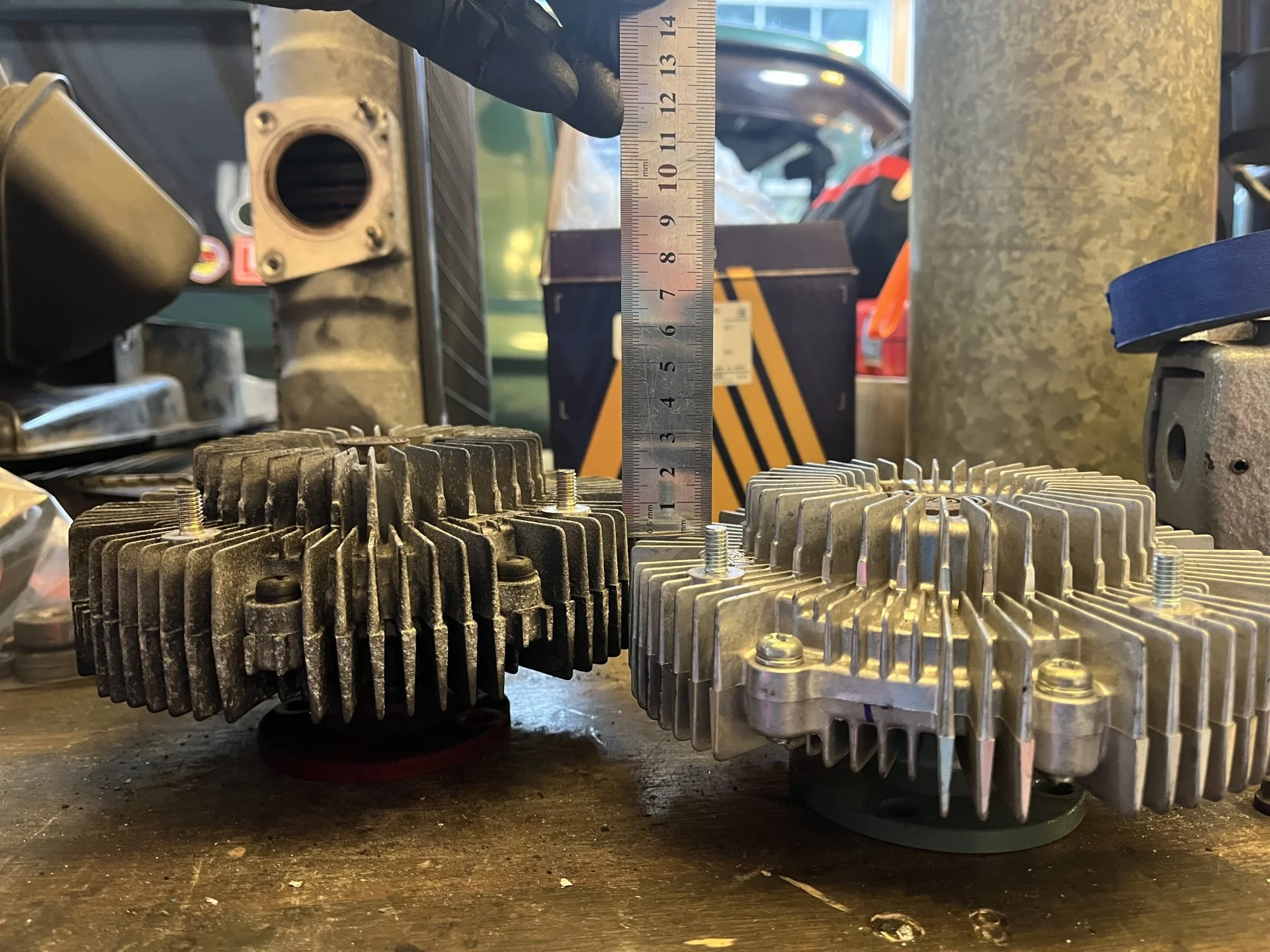

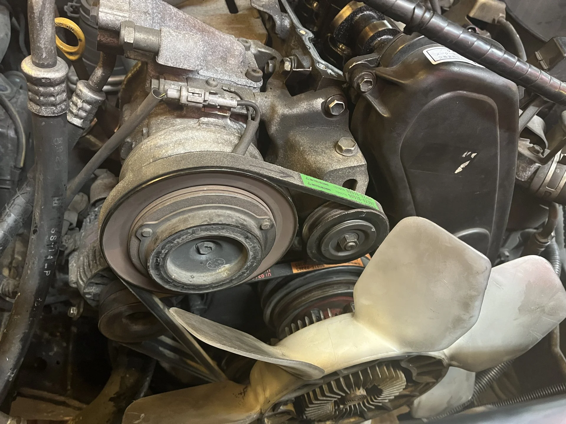

Looks like I was shipped the wrong fan clutch - I’m assuming this one is for the petrol engine. The bolt size and spacing are identical, it fits the fan and pulley exactly, but the shaft is almost a full centimeter shorter than the stock one. It won’t interfere with anything on the engine, but I’m still going to replace it with the right one - this motor has a reputation for overheating and I’m not going to risk it.

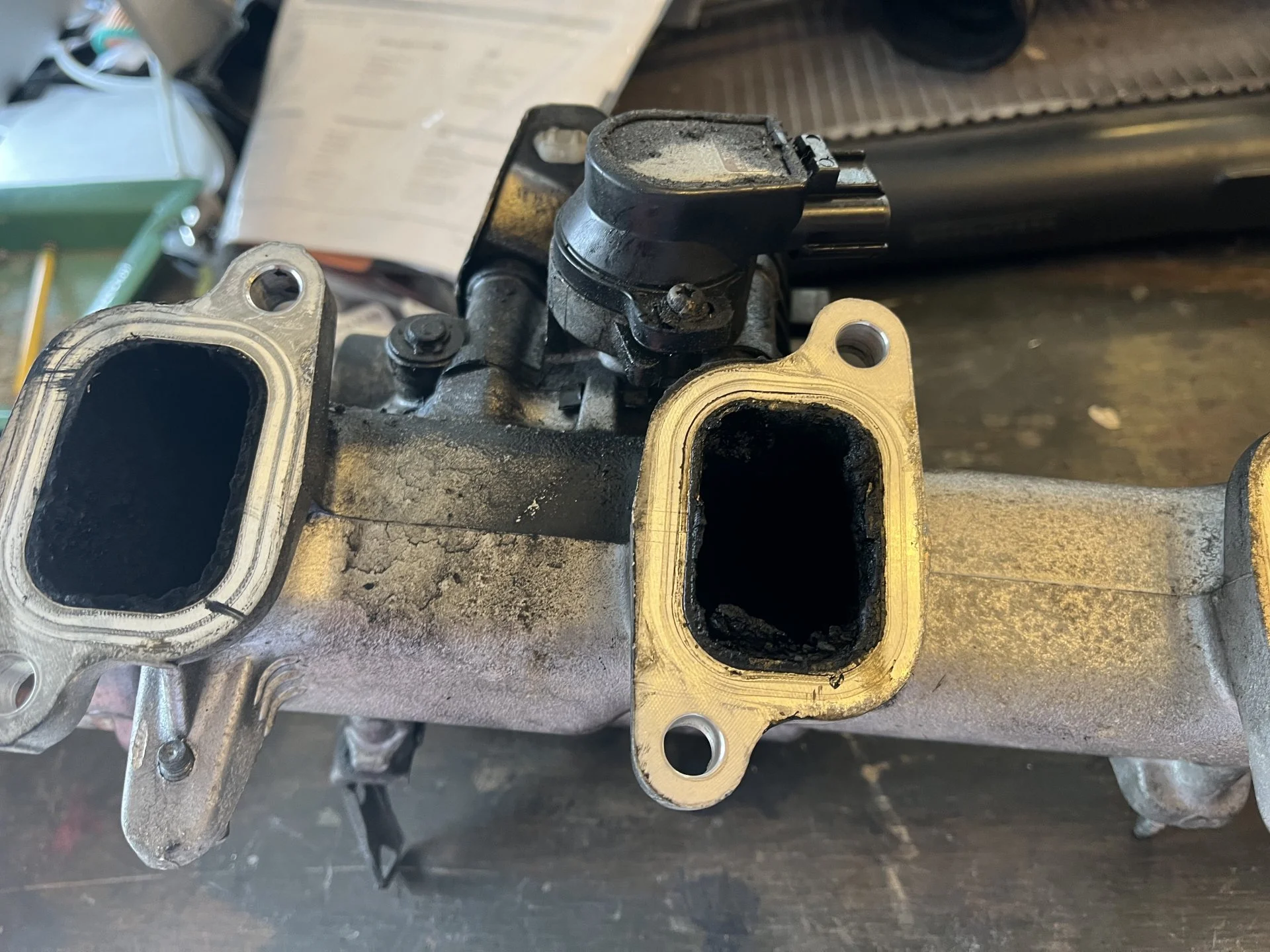

One question for the gathered minds here… I’m going to have to pull the intake manifold and clean it out. I looked down through the throttle butterfly and it’s full of gunk from the EGR, so it’s time to pull it and try to get it all cleaned out. I’ll delete the EGR while I’m in there. Do I need to replace the intake manifold gaskets on this motor, or are they re-usable? Thanks!
I suggest you change them as they are thin and probably were designed for one compression.
As I recall they are cheap and not worth gambling on. Watch the large rubber couplings for the intercooler as well. They are often cracked at this age.

Thanks, @buggyboy7! I was hoping to skip waiting on parts from Dubai - I can't find the gaskets here. But you're right, it's not worth skipping it. I'll get them ordered today. Thanks also for the tip on the intercooler... I'll order a replacement as well.
This has been a really busy season for our family, so I've been unable to get big uninterrupted chunks of time to knock out big pieces of this project. I'm trying to get this done basically an hour at a time, after everyone goes to bed, which is not how I usually do things. I'm breaking the project up into lots of small chunks that I can complete in 45-60 minutes... this is a new way of doing things, and I'm curious to see how it goes.
Last night, got the timing belt in. Replaced the timing belt, the tensioner and the pulley. Had sourced camshaft oil seal to replace while I was in there, but there's no leaking anywhere I can see - it's dry as a bone. My old man taught me never to replace a seal that wasn't leaking...

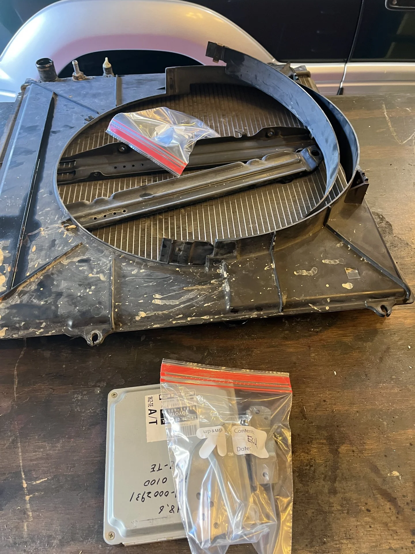

My electronics repair guy should be back next week and I’ll get the ECU and capacitors over to him for that part of the project.

Water pump installed, belts reinstalled and tensioned. I put the belts on less than a thousand miles ago, so no need to replace them. Not much, but incremental progress.
Test fit the fan clutch from the petrol engine and the clearances were all wrong. Put the original clutch back on till I get time to order and replace.

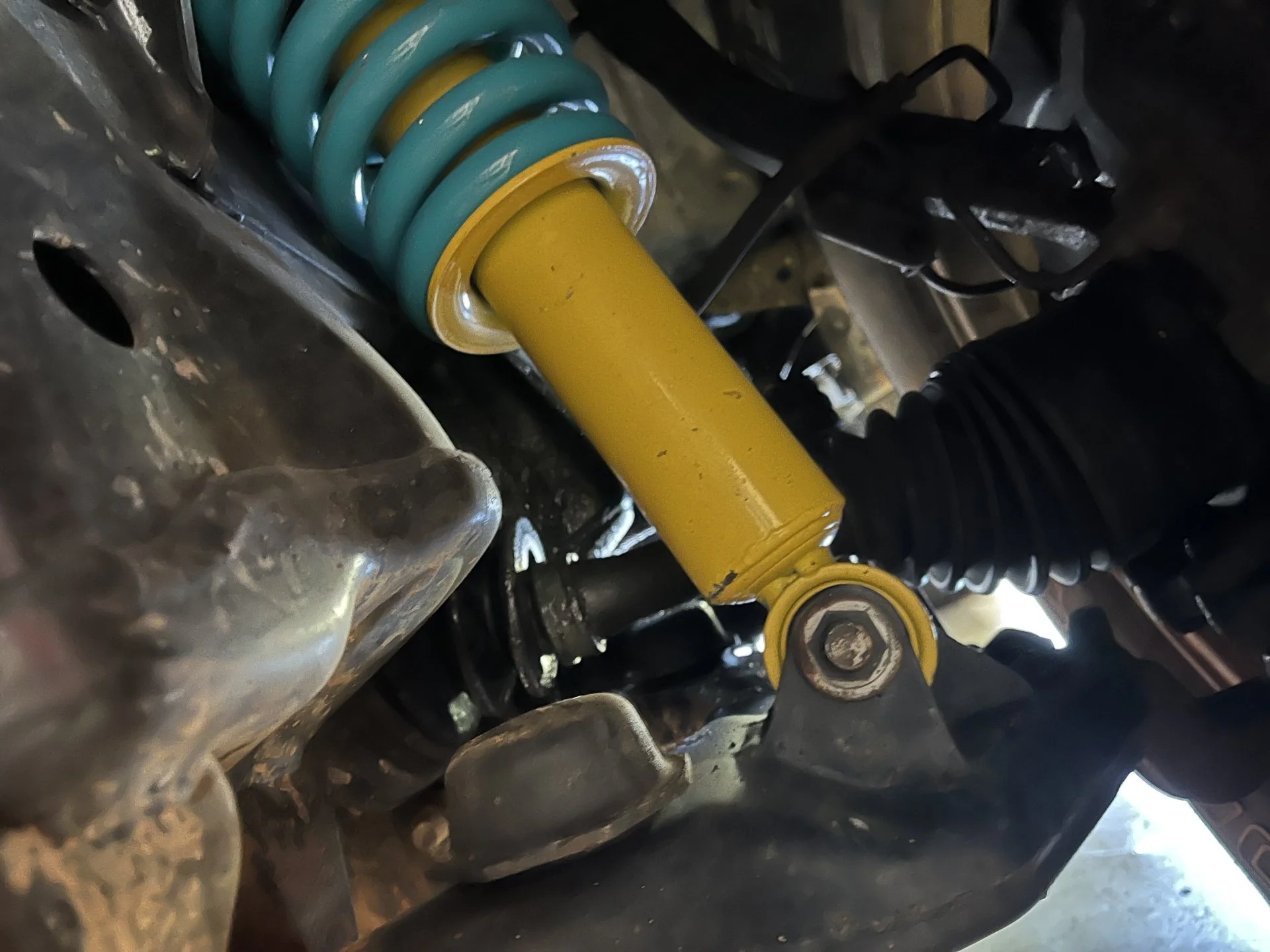

Id like to know what you think about the bilsteins, I find them to be bouncy.
Those are Dobinsons twin tubes, not Bilsteins. They're basically the same color so it's an easy mistake to make.
Dobinsons is the only vendor I could find stateside that specs different spring rates for the diesel and the gas engine... everyone else just sells the gas 4Runner springs. The diesel weighs significantly more than the gas engine, so it has to make a difference.
I've been very pleased with the Dobinsons set up. The ride is excellent, and is a significant improvement over stock.

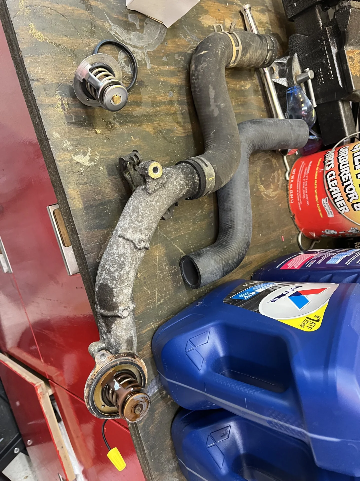

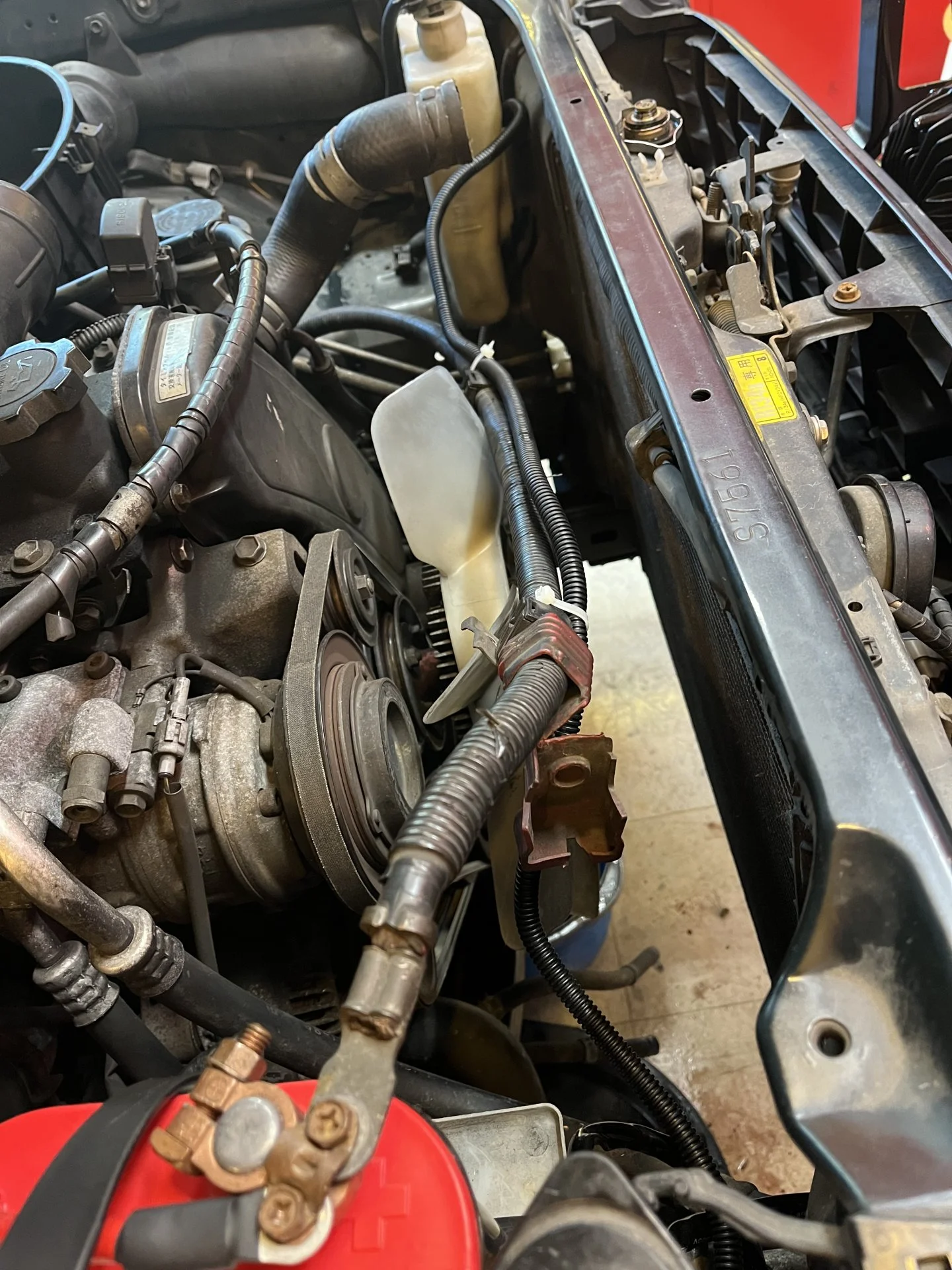

Had a few hours this afternoon, and knocked out the rest of the cooling system. Up first was the radiator. The auto version of these has a transmission cooler integrated into the radiator. I’m not a huge fan of this arrangement for two reasons- first, the 1KZ-TE is notorious for cooling system issues, and giving up radiator space to the transmission seems counterproductive. Second, the internal transmission cooler can fail, and cause ATF in the cooling system and coolant in the transmission - neither of which are good.
So, I decided to go with an aluminum radiator for a manual transmission model, and a separate plate and fin transmission cooler. Up first, the transmission cooler:
Cooler went in easy peasy. I attached it to the front of the condenser. A few folks on the 3rd gen 4Runner forums tested and said that this was the optimal location for the cooler. I‘m planning to keep an eye on the temps, and if it becomes an issue I can go with something like a Derale Atomic cooler that’s designed to be mounted anywhere.
Up next, radiator. I found a group in AU that would ship me a full aluminum radiator for the same price as a Koyo. It’s purty.
Install was easy. Everything lined up well. I still need to pressure test it to ensure all the welds are good. New Toyota upper radiator hose and reinstalled the shroud.
Finally, the thermostat. For those of us with an auto, there are a few extra bolts to remove. Just like the manual, the thermostat housing has two bolts at the top, but it also has a bracket for the transmission cooler lines and another bolt securing the pipe to the block at the bottom. They’re a little awkward to get to, but overall it came out without too much drama. New thermostat and Toyota radiator hose went in.

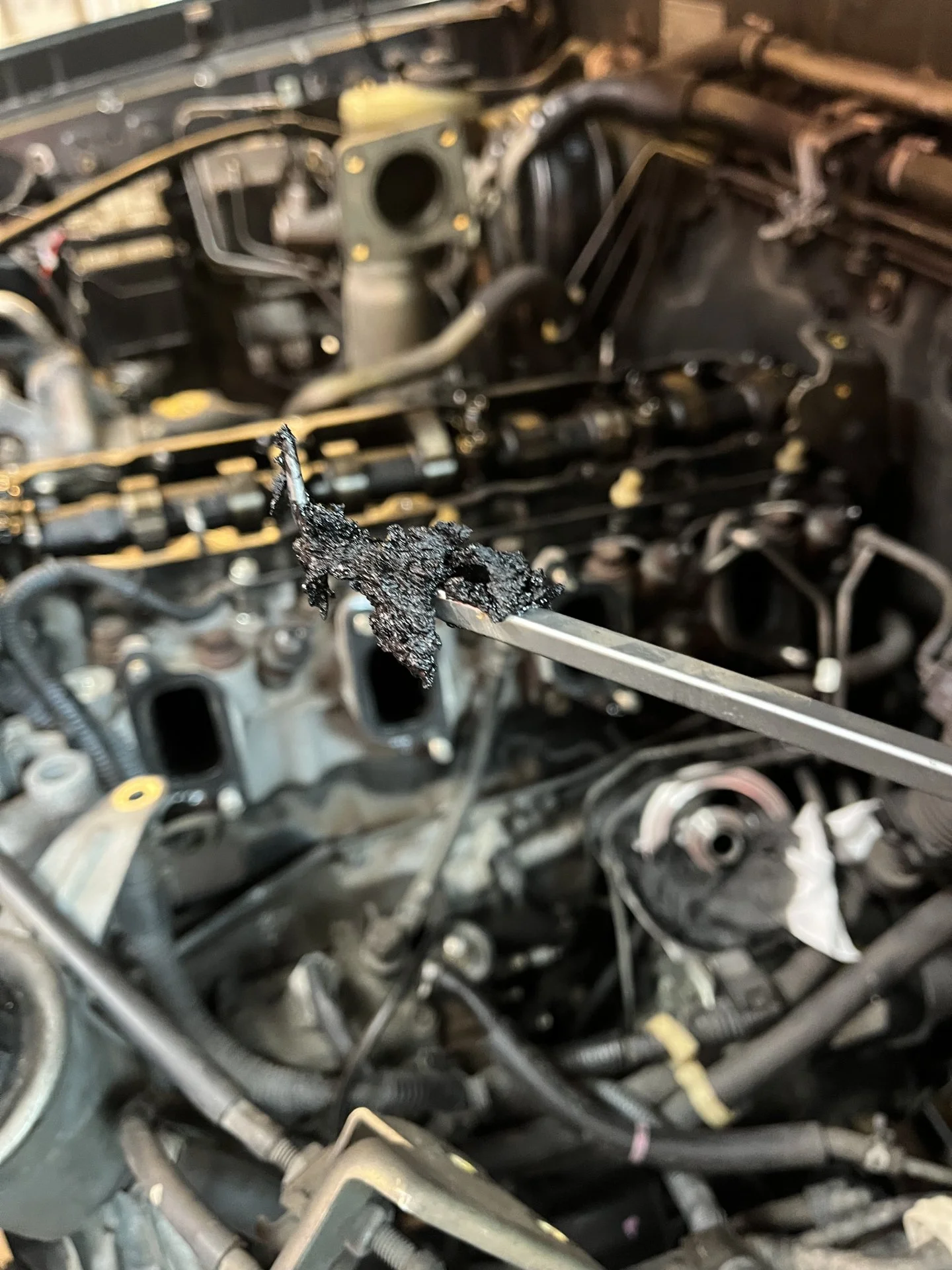

That last bolt on the bottom of the EGR exhaust manifold side was an SOB. Got it loose and man what a mess that EGR made…
Ended up using dental picks and carb cleaner to scrape as much of the gunk out of the head as I could. I’m soaking the intake in diesel overnight to see if that makes a dent. Otherwise, guess I’m going to have to find someone to hot tank it.
