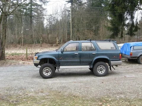

OK, I got it outta the garage.

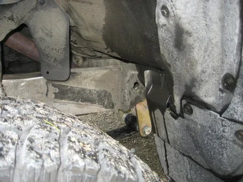

These leafs are crazy tall.
Supposed to be a 3" leaf.
I knew that they needed to settle so I left them alone and went out driving gravel roads for two days hitting every pothole I could see.
I don't think they'll ever settle, I may have to pull a leaf or two.
Sorry you didn't get that info before you did it...
IMO they should better publish the actual lift numbers b/c I think they leave out the added height the new spring hangers provide...
It's all over the place their 3" and 5" lifts are more like 5" and 7".

I went and talked with the Toyota guru's at a shop in town and they told me which leaf to pull out, so that's done.
It's sitting lower already but feeling real soft, I think it'll sink now.
I'd take a pic for ya but it's dark right now.
I'll get one after work tomorrow.:D
The geometry on the front axle must make that thing terrible to drive. Ever feel like a shopping cart?
It's not bad, It's got some bump steer.
I just picked up some centering bolts that are threaded all the way.
So I'm gonna pull some leafs until I'm happy, and if it starts sagging then I'll start reinstalling them till I'm happy once again.
