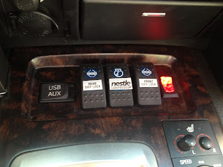

I added front and rear E-Lockers to my 200 for two reasons:
1. They simply offer far superior performance in a real off-road situation to Atrac or crawl control (which I disable as soon as I get off the road)
2. With my 2" lifted 200 I don't want to put any more undue stress on the CV joints than I have to. They take a real hammering from the traction control systems firing the brakes against the mighty torque of our V8 diesel engines. Plenty of CV failures down here believe me and I am sure the overly aggressive Atrac system in the 200 is the central contributing cause.
3. In sand the loss of power and wheel spin stolen by the Atrac system can be a hinderance to momentum and traction control can rob the car of valuable wheel power. Just recently on a sand dune climb I was able to significantly out climb a 200 without lockers (he had centre lock only and Atac engaged). Other than that we had very similarly equipped 200s so the comparisons were valuble and meaningful. We even swapped cars to verify the experience. It was clear that the Atac system was robbing his 200 of all important power on the ground. Once he turned the Atrac and VSC systems off he was able to do far better but still not as well as me with rear and centre lockers engaged. Interestingly we also noted that a number of FJcruisers were also hampered by the inabilty to disengage their Atrac systems (apparentlyt FJ Cruisers cannot disengage Atrac in Low range -unlike the 200 which can - and even though they do have rear lockers as standard).
On tricky firm or slipery terrain I believe the Atrac and Crawl functions do far better but still no where near as well as real lockers.
Atrac and VSC operate by sensing differential wheel speed across an axle. With lockers engaged no differential is apparent so traction control system is never invoked. Interesting question re turn-assist function however. I guess you would have to turn the rear lockers off for it to work otherwise all you would do is drag both rear wheels around a bend.
I would whole heartedly agree that bloody lockers should come as standard with a +70k 200 as they do in the new 79 series Cruisers (don't think you boys get them up there sorry).
