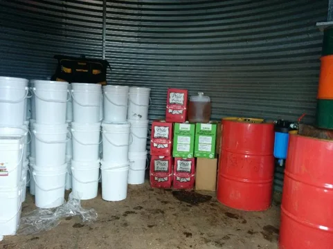

The majority of the oil I've collected so far.
There's another dozen pails or so, off camera. Most have about 15 liters in them.
I'm starting to build my cold up-flow settling filtration system.
Already out one 4"x 2" i.d. close nipple because the exhaust guy press fitted the 2" o.d. exhaust tube and pushed it out of round.
He didn't charge me because he said he thought something didn't look right about his work but didn't know what. :rolleyes:
By the time I tested it, went and bought another nipple and made it back to his shop, he was closed early for a Saturday.
If you pour the VO out of the buckets/cubies into the upflow before it gets above 5°C, the PHO and crud will stay in the bottom. The less crud that gets in the upflow drum, the less you eventually have to pump out. Once I start seeing crud in the flow from the spout I dump the rest into a big tub of sawdust. When the greasy sawdust gets about the consistency of mortar it goes into milk cartons for winter stove fuel.
I receive the oil mostly in the little square white containers and pour two of those into one larger white pail. I get to leave a lot of the crud behind there. But there is still a lot of cleaning left to do.
I don't think my oil is as clean as what you collect, and I'm eager to see how well the upflow works.
I read about the cold upflow setup and your sludge and sawdust trick on the make-biodiesel website. I'm also very eager to try that as i'll be at least partially heating my new place with a wood stove!

Cobbled together my upflow settling system and put just over 45 gallons into it.
Figure while I'm off to work for 2 weeks that can settle again after getting a little stirred up from pouring.
And then when I get back I might start introducing the rest of my stockpile through the upflow system.
I can already think of a few things I would like to add or modify. The overflow pipe through the filter into the second barrel could use a quick disconnect of some sort.
I would like to have a valved spout at the bottom of the settling barrels to make it easier to pump out the sludge.
I also think some sort of sight glass would be helpfully added to the settling barrels. So help see how much particulate and or water is settling out, and how much oil is rising to the top.
However my barrels are closed top, so the addition of these might be a little tricky and would have to wait until a tear down/cleaning period.
