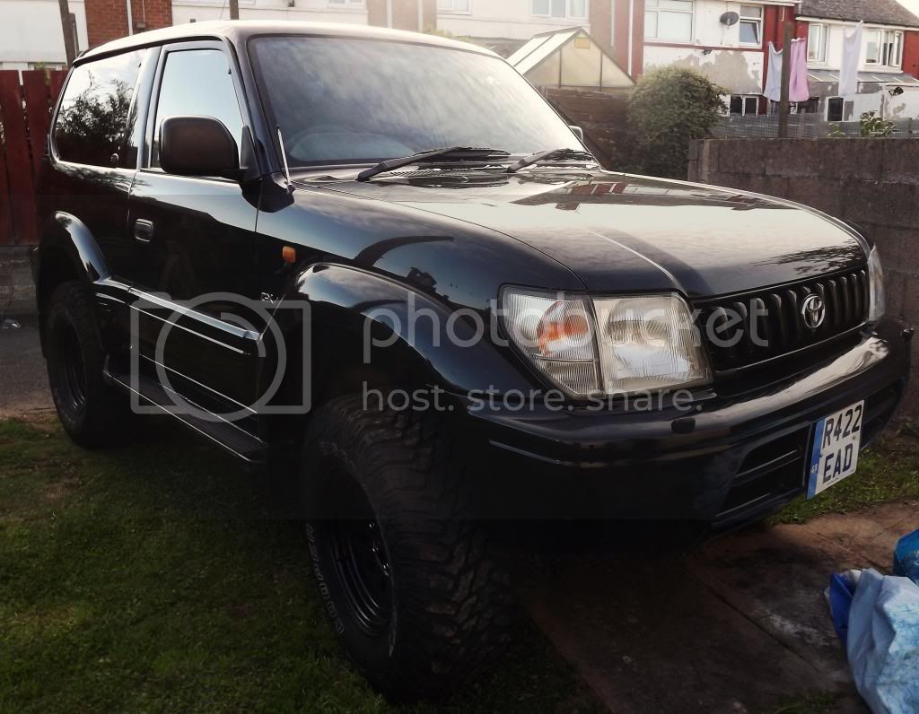

A 1 inch front coil spacer results in a 2 inch lift because of the coil angle . The rear coil spring will need a 50mm spacer to equal things up . This is my Truck now with the same plus a 40mm body lift - 16x8 zero offset steel wheels - 285/75/R16 Tires .
