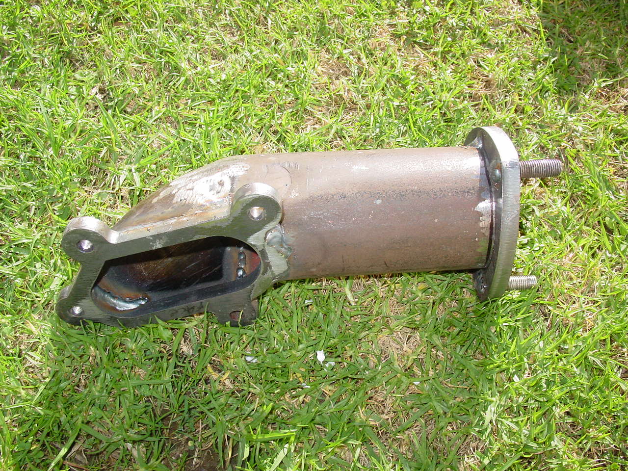

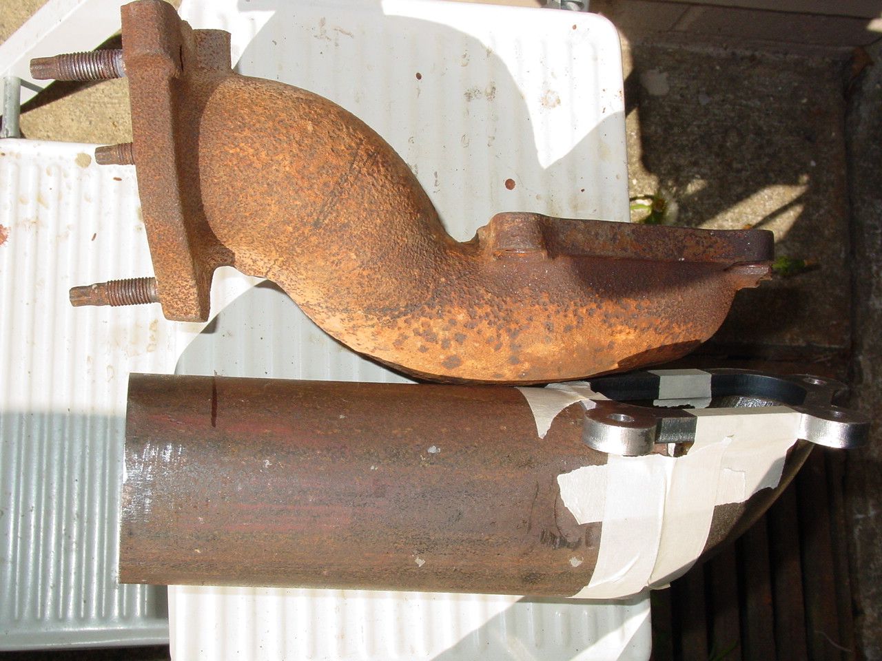

Heres what ive recently made for my LJ78 with the 2lte, think the systems slightly different due to where the turbo sits, however some points that may cross over to what your doing
I used the 2.5", this worked perfect for the opening size of the CT20 turbo flange, from what i can tell a 3" would overhang the sides of the plate possibly.
I welded mine up to the factory 2" pipes for now as i want to test each mod and see the changes each makes (plus im not ready to drop $500+- on a full system just yet)
I found the change of dump pipe didn't make heaps of difference regarding etg's with the standard pipes, however it has given the truck more guts. In the photo you can see the standard dump next to mine. factory dump is pretty narrow inside those bends also..
If your making one i would buy the turbo flange to suit your turbo first and measure what pipe will work best with it potentially.

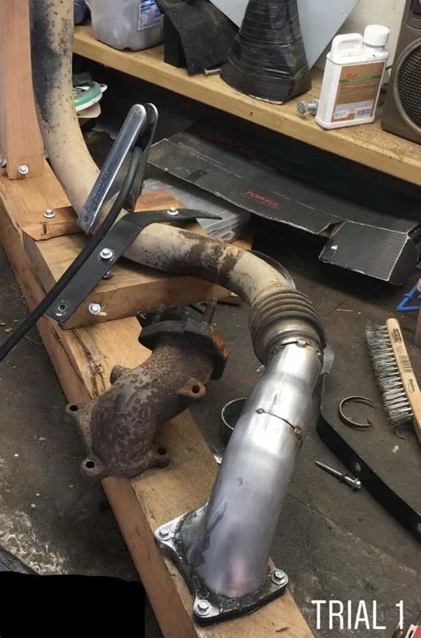

On the KZJ78 / 1KZTE its very small as it has a goose neck . I made a new exit / dump pipe from large 3 inch pipe. Works great.
@kbushnz thanks for sharing the photos—very helpful to see.

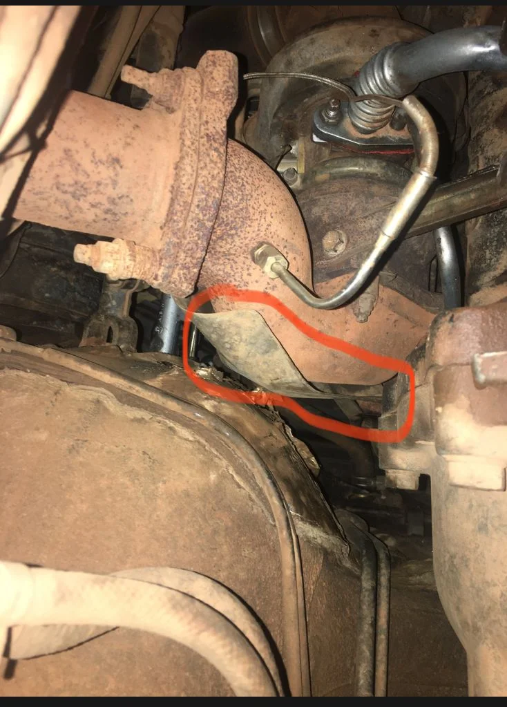

I asked this on another ih8mud discussion—but did you end up putting any type of heat shield / radiant barrier between the larger dump pipe and cab fire wall (like the stock setup has)? Or did you just run without any additional shield?
Hi Yah, I didn't add any extra heat shielding. There was a nice gap between the pipe and the fire wall. Also the firewall still had its insulation shield intact. If you could squeeze one in , it wouldn't hurt or wrap it...
