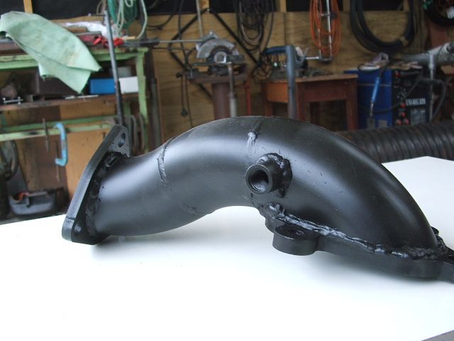

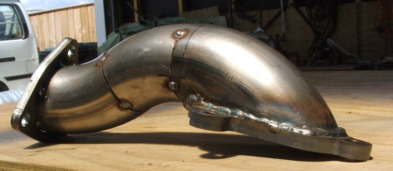

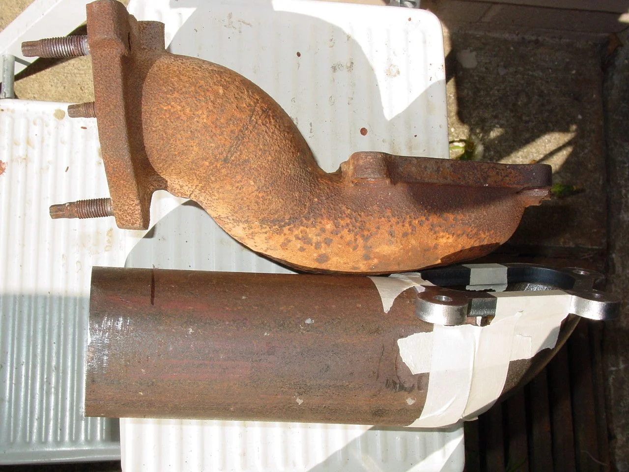

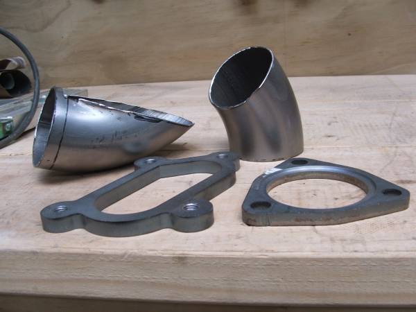

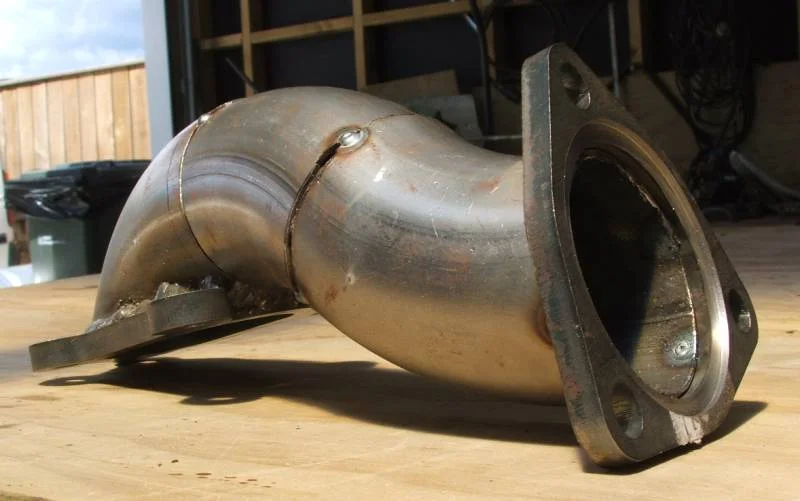

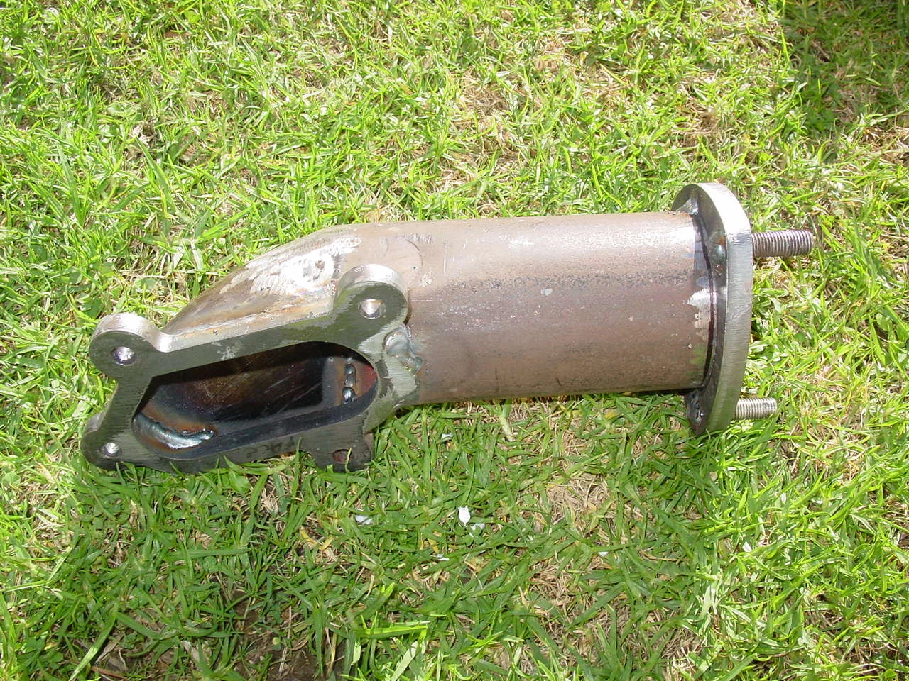

On the KZJ78 / 1KZTE its very small as it has a goose neck . I made a new exit / dump pipe from large 3 inch pipe. Works great.

Well from what I read 3 can reduce back pressure too much. 2.5 still gives a great boost over stock and clears the frame rail with a little extra space. Bigger air gap helps heat stay away from body.
