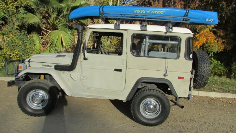

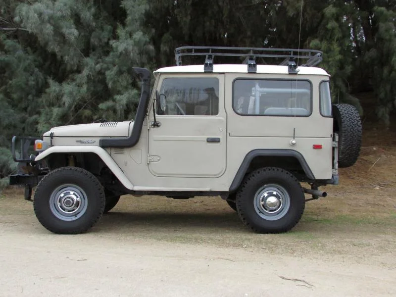

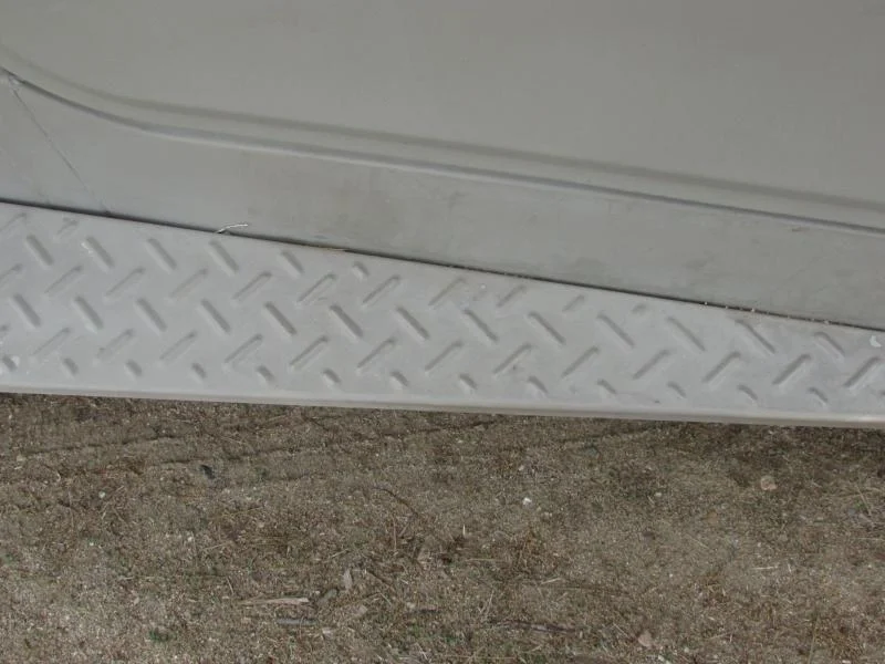

As title implies, it's been a year now on what was to be a temporary cover up. Still sporting the $35.00 paint job. The rig has sat outside in the kalifornia sun every day with only minimal fadage on the "sunny side". The running board shows no wear, and I drive this thing daily! Over all very impressed with this stuff!
I used the Krylon Camo ultra flat Khaki. Got the spray cans at the wal-mart for $5.00/can. I went back and couldn't find that paint there. I know it's available at auto parts stores , but cost a little more. By the by, I just painted the outside. The interior Was a similar color so, didn't paint that.

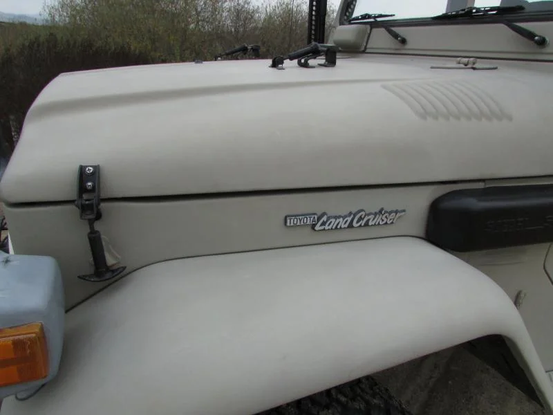

As mentioned, my truck gets full sun on the driver's side where its's parked. I took a couple of shots today so here 'tis. Passenger side (US) looks perfect, the driver side has faded some but still looks good, in my opinion. The color variation in these pics is more than it really is. The shots were taken at different times of the day. As far as durability, I'm suprised how well it's held up. I need to take a closer pic of pass. side for more detail. Comming up on 2 years now!
