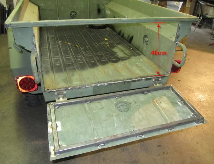

Luke can customize the kitchens within certain parameters. Mine is a custom DPOS, 3cm shaved off the height of the box to allow it to slide in under the top rail of my M101 trailer which I am leaving in tact for strength and lid sealing. See pic below.
