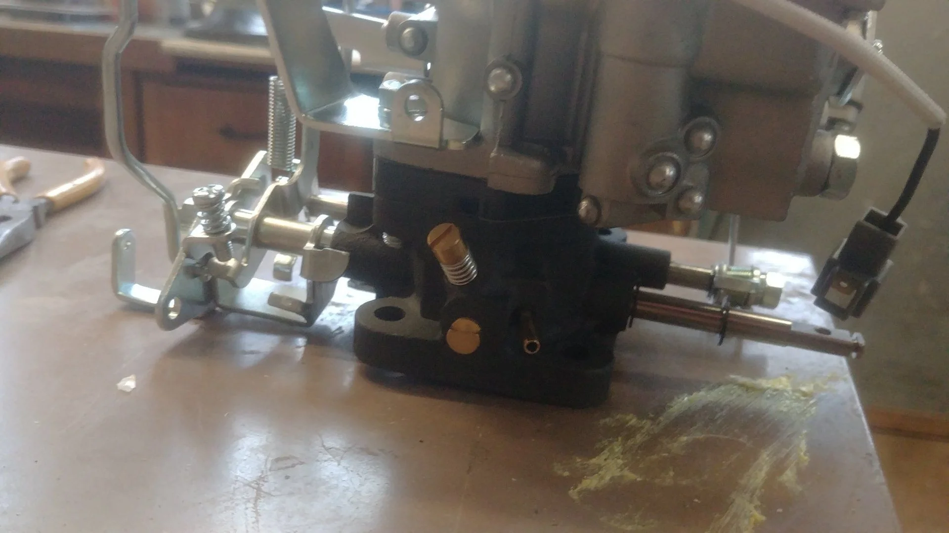

I ordered one at about 8:00 PM Saturday from amazon for ~$80 and it was on my doorstep Monday morning. I need to rebuild one of my spares so I'm going to install this on my 60 so that it can remain in service. Maybe I'll send mine out to one of the carb whisperers here on Mud. Either way, if it works well I can do that at my leisure.
I took off the air horn to inspect the casting and check for debris and finish on the brass parts. I'll post pics shortly.
Pics:
There are more pics of the light dismantling that I performed on the 40 series thread linked above.
A few initial thoughts:
First, this carb lacks both a choke breaker and a choke opener. It has one wire for the fuel cut solenoid. There is only one vac port on the base on the side that points toward the valve cover. Sorry, California, but I don't think this meets smog compliance.
The listing, and in fact the manufacturers own literature, says that this is a direct replacement for '69-87 2F engines.
Hmmm..... :hmm:
It is linkage style....
It is a 2 barrel design....
No CB & and no CO....
AND...the 2F engine was first released in the 1975 model year iirc.
Direct replacement for '75-'78 is my guess but smarter cruiserheads than I might be able to provide a more accurate assessment.
