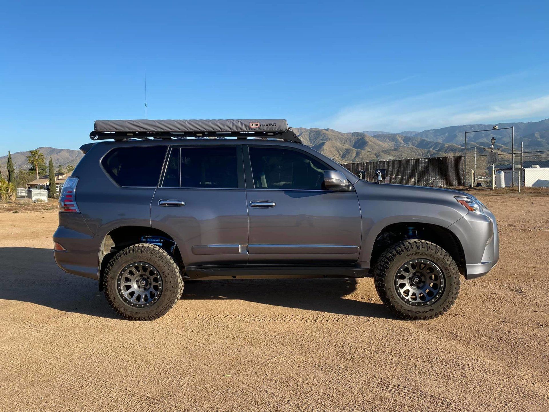

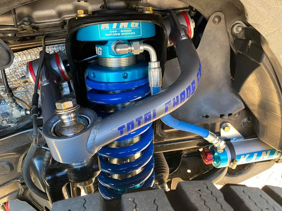

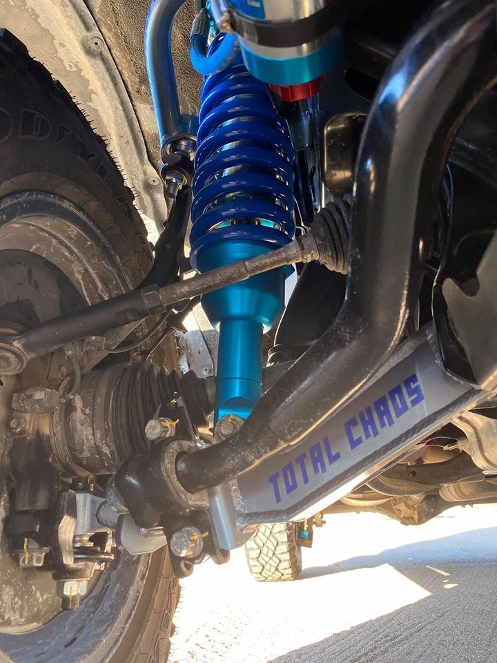

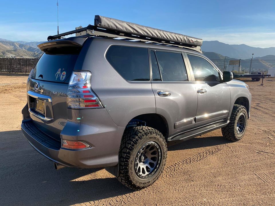

Hello everyone, I just wanted to share the progress that i've made over the first 6 months of ownership of my 2015 GX460. I sold my fully built 2012 FJ Cruiser to fund the GX460 because I was simply tired of not having enough room and not enough creature comforts. Here is how she currently sits on 32" Duratracs. Mods include the following:
- King 2.5" front coilovers with adjusters and 700lb springs
- King 2.5" rear shocks with adjusters
- Icon Overland rear springs
- Timbren bump stops front and back
- RCI rear shock skidplate
- Victory 4x4 Blitz sliders
That's looks perfect. How is ride quality relative to factory?
It's a tad bit stiff at the moment due to the fact that I used 700lb springs. Once I start to load it down with additional weight (front and rear bumpers, winch, dual batteries, skidplates and an RTT) it will settle in.
