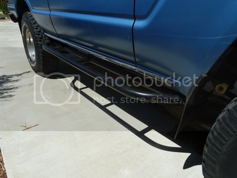

These are sliders I build for the 60/62 series. They can be built with or without kick outs. This customer chose the kick out more as a step for his two young sons than for any other reason. Note the expanded metal on the kick out, this is to prevent little legs from slipping through and getting hurt.

I think the kickout being discussed is that shown in the 3rd post, not just having a tube out. Having the tube come out away from the sliders is required IMO. I would avoid having the kickout as all I see it doing is allowing the truck to get wedged into and stopping the truck from sliding along a tree or rock.
