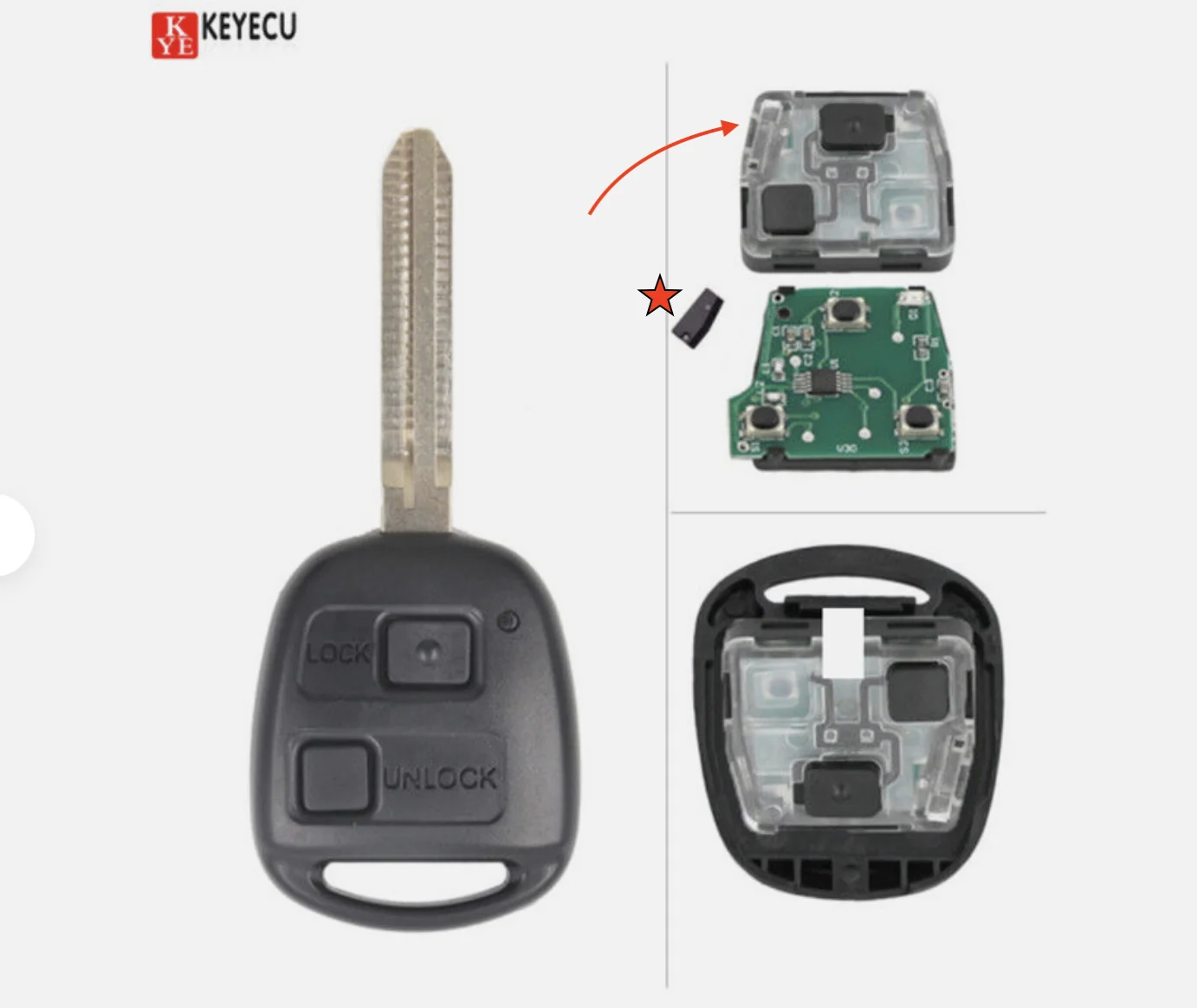

Your assumption that the the spare key does not have electronics is incorrect.
A key for the 100 series (I will assume you're in the US) has 2 or 3 pieces as it pertains to function....
- The metal key blade (all keys)
- The transponder chip (all keys)
- The remote module (remote keys)
On the valet key (or if you have a master w/o remote), the transponder chip is embedded in the head of the key.
On the remote key, the transponder is tucked into the remote module. My gut says that whenyou dropped the key and it fell apart that you lost the transponder chip OR that you have taped it together in such a fashion that the immobilizer system is not able to read the chip.
I have attached a picture I stole from eBay which shows the pieces. The transponder chip (which has a red start next to it) is inserted in the remote module where the arrow is pointing. Look at your module and see if it's there. If not, you'll need to replace it and then follow the procedure for the ECU to learn a new key.

Thanks for the reply.
It’s actually a European spec key.
But it makes sense. In tapped the key back together without the electronics inside. I kept the electronics apart from the key. I assume (or I hope) the transponder is stil with the electronics. I will test Theo’s before ordering a new housing from yotamd.
